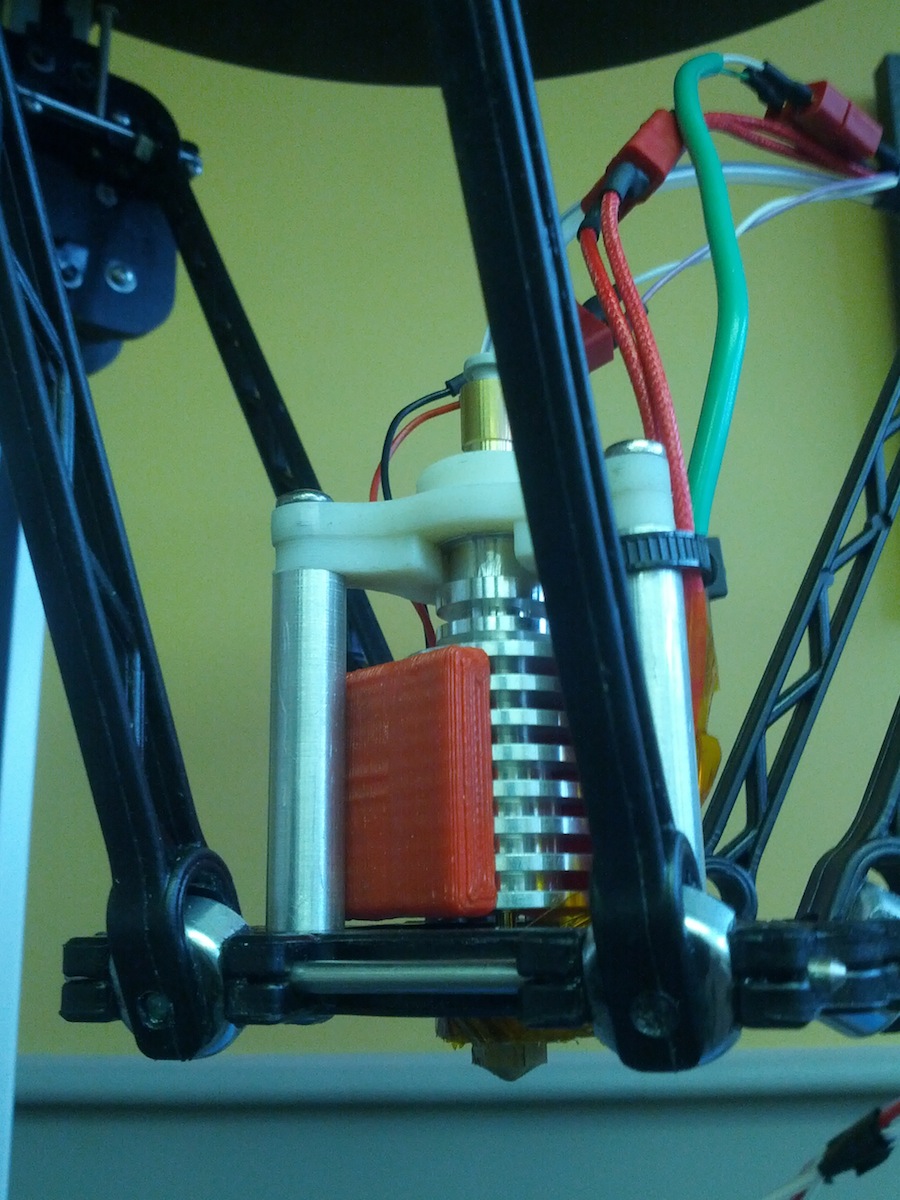

My E3d hot end arrived and I hooked it up today. I made some taller standoffs and mounted it on top. The nozzle currently sits 2.5mm higher than the Max nozzle, but the standoffs can probably shortened a couple of mm and it will still fit above the stage. I ended up using http://www.thingiverse.com/thing:57889 to mount it.
I'm using ABS and it seems to be printing fine. I don't know if its less pressure to push the filament through the hot end or the smaller nozzle size (.4mm), but the extrusion starts coming out of the nozzle quite a bit quicker at the beginning of a print.
-B

I was going to make up some spacers, what length did you end up with?
I'm still having issues with mine, though I've only tried with PLA, my current theory is that if the PLA softens over the interface between the nozzle and the thermal break, it increases back pressure significantly which is causing the SeeMeCNC extruder to eat my filament.
I've verified by pushing through filament by hand that with PLA there is a significant starting pressure, the interesting thing is one the filament is moving you can extrude at totally rediculous speeds.
This likely wouldn't affect ABS because it doesn't soften like PLA.

Can you tell me the length of the standoffs you made?
They are 1.73in/44mm in length. I drilled and tapped both ends so I wouldn't have to find really long 6-32 bolts.
Edit: I checked with a feeler gauge this morning and i could shorten the standoffs by 1.5mm and the fan would still fit correctly above the platform. The length can therefore be 1.67in/42.5mm. Then the nozzle would only be protruding 1mm less than the Max nozzle from the bottom of the platform (at least on my machine).

I used RichRaps J-Head mount and mounted it up high with spacers like you did. It prints like a charm. Love this E3D all metal Hot-End. I cranked it up to 350 C for about 20 minutes with no melting of anything anywhere. I think I am going to switch to the mount you used.
Thanks for posting the link to it.

1 1/2 inch worth of spacers is all I needed and I was able to extend my Z height by 3 mm.

The fan on the cooling fins needs to be on all the time. It's what keeps that area cool enough so filament only starts to heat up and melt when it reaches the nozzle. Fan must be on all the time on these E3D all metal hot ends.
