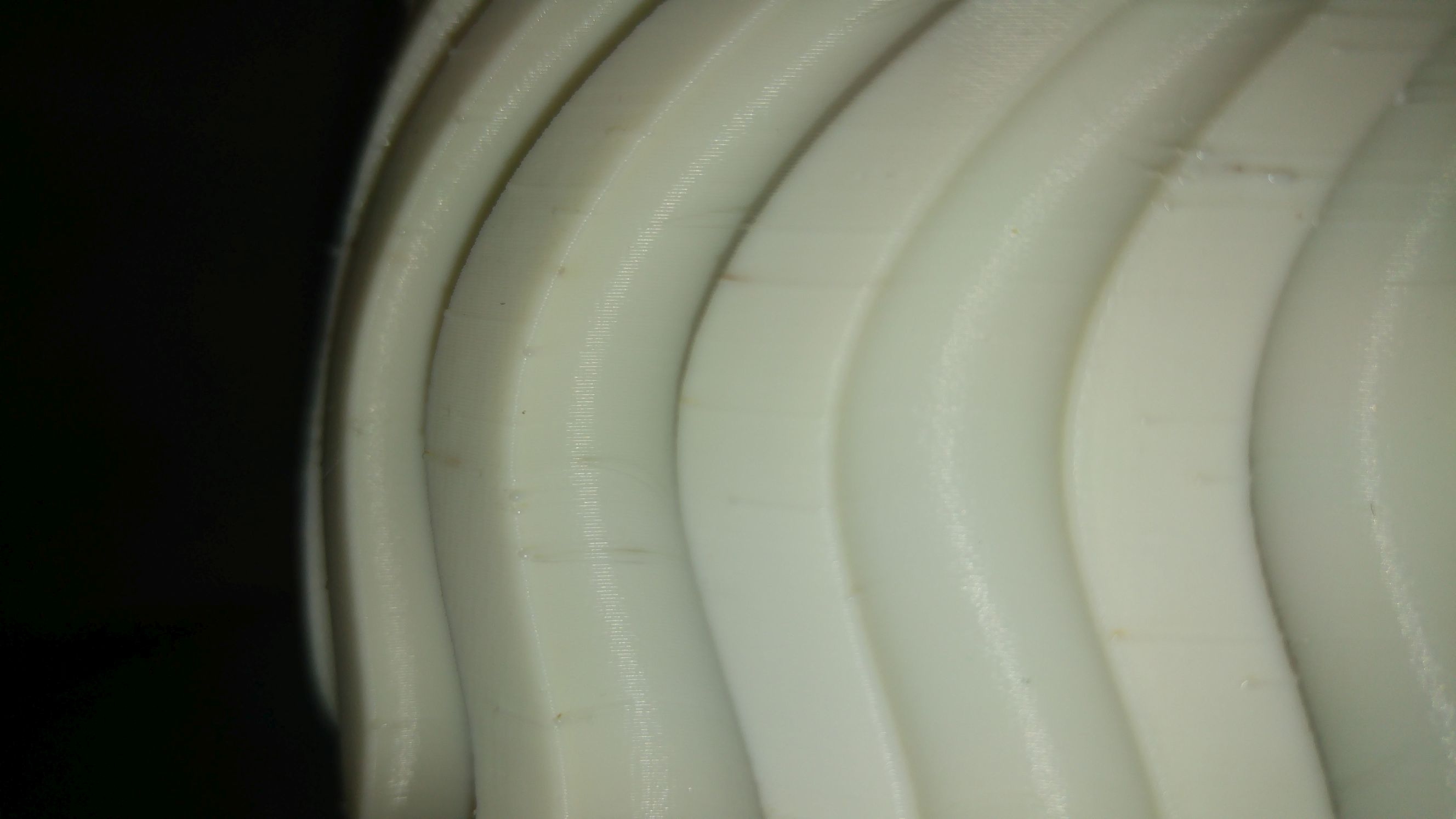

But if you look into detail there is a lot of blobs and uneven lines.
If you look close enough, you will probably notice that the uneveness is not link to specific layers, the seem to appear randomly, and disappear short way further in the same layer. Maybe a little overextrusion? Or should I look differently...

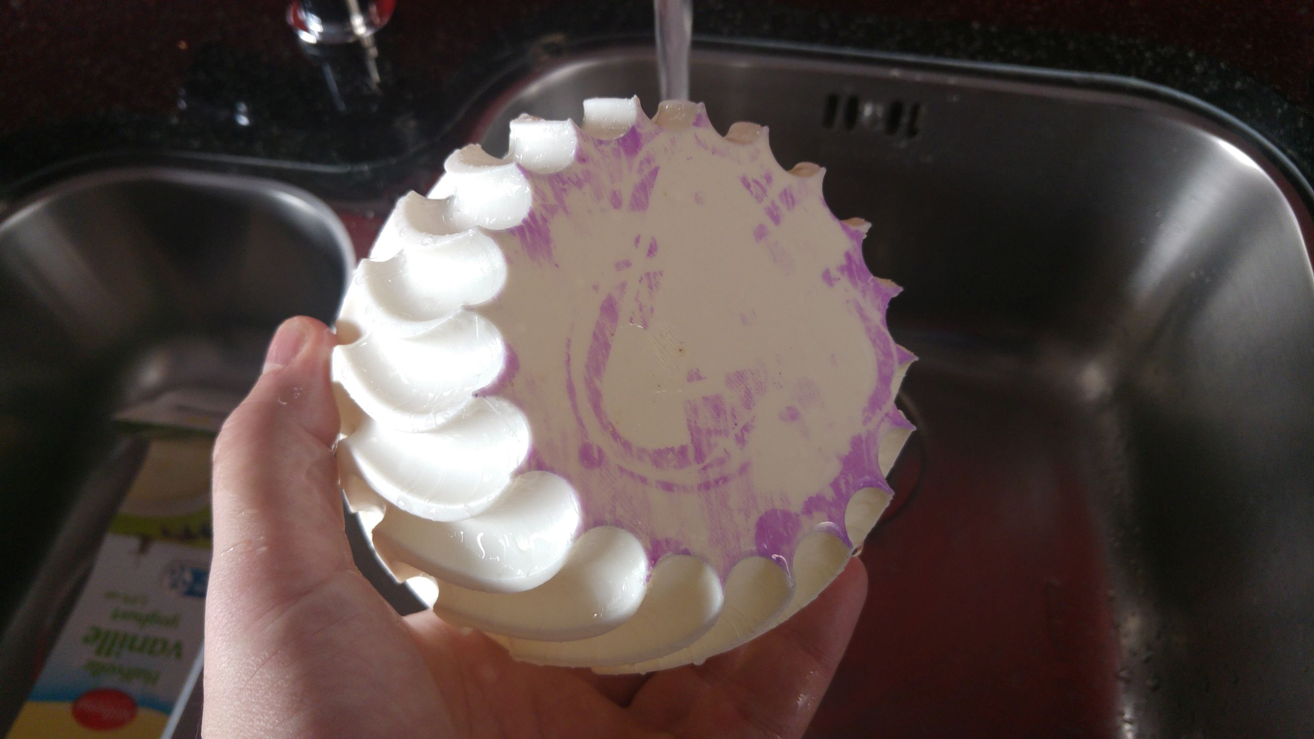

I took this vase to the test and filled it with water. It is pretty solid with 3 perimeters, but one spot was pooring out water. The black spot, I have no idea where the blackness came from, but I guess the nozzle pick up some goo, kept it a long time and dropped it off later making all three perimeters leak. Besides this, can good waterproof vases be expected at all?
Something else that drew my attention was the reaction of the purple glue to water
