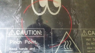

After many months of happy printing, the filament does not extrude consistently. See the attached photo. The photo is of the skirt for a 200 mm diameter model. It is the first loop of a two loop skirt. After the second loop, the gaps are not as noticeable but they are there.
Printer is Rostock Max V2 with original hot end. Software MatterControl 1.5.3
Filament is Tianse PLA Red 1.75 mm
Adjustments and calibrations done:
Remove old glue stick glue and apply new glue.
Calibrate extruder
Adjust Z height
Adjust X, Y, & Z Tower heights
Clean the nozzle
Vary temperature between 190 and 200 degrees.
Change heater resistors
Autotune PID
Adjust the heights again.
The gaps seem to be more pronounced at slow print speeds such as the bottom layer (layer 1). They are also pronounced if the layer has minimal area to be printed causing the print speed to reduce.
If the speed multiplier is set to 2x, the gaps are reduced but the layer does not adhere to the print bed very well.
Any suggestions are most welcome.
Hank

Loose hob gear on the extruder? Although I would expect to see it get worse at higher speeds if that was the issue. But, I'd check it anyways.

Thanks, rootboy.
First, I apologize for not updating when I was told about a potential fix for my problem.
Andy at SeeMeCNC asked: "Have you tried another spool of filament?" I hadn't. I was on the third reel of three reels of a filament from Tianse. The first two reels had printed fine. I changed to another filament called "add:north" from Sweden and voila, the problem was fixed.
I have since checked for a loose hob gear and it is tight but thank you for your input.
