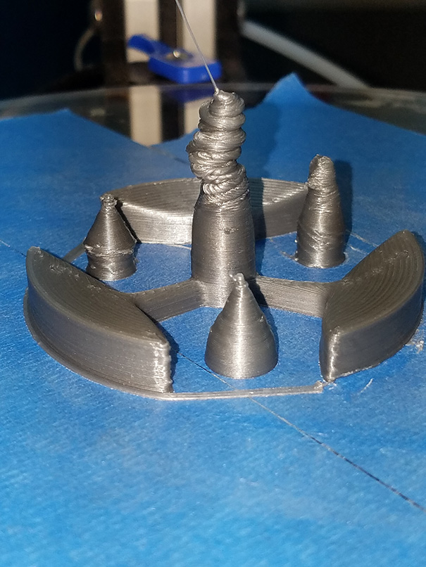

hi, the base of the spining top prints right, then it gets to the tower part, and after a short bit the print screws up, as shown in the picture.
this is standard pla, 0.2 layer, 20 % infill (i also tried 15% same thing happens) i also tried different temps, 210, 215, 220, etc.. same hting happens..
any ideas?
thanks all.

The printer needs to slow down when in is printing that detail. Or you need more cooling

Yep. Too hot, too fast, or both. :)

thanks everyone, im going to slow it down now, and cool it down, with temp and fans.

You might want to look into the minimum layer time of whatever slicer you use. That will guarantee it'll slow down as it prints the center of the top.

I can just about guarantee there's nothing wrong with Cura if you've got it configured properly. I can't say the same for MatterControl.
My advice is to slice on Cura and either print via SD card or use a Raspberry Pi & Octoprint.
