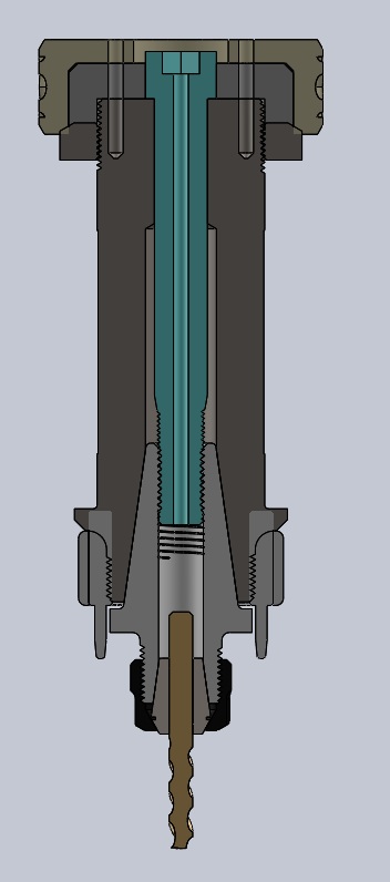

I'd like to post some stuff about the milling spindle for your evaluation....
Below is the side view of the milling head and B axis, it's the part that slides up and down on the Y axis column. You can see the harmonic gear that will drive the B axis in the back (left). Two big tapered roller bearings in the middle, then the shaft that holds the milling head sticks out on the right side. In the milling head is the spindle. The spindle is driven by a pulley system at the top, with 6 round keys at the torque interface. The light blue shaft down the middle of the spindle is the drawbar.
To keep the milling head ultra-compact, I decided to go with a novel approach for the drawbar system. It's just an M12 socket head cap screw. At the top of the milling head, there is an enclosure box (not shown). In the enclosure box, there will be a solenoid that pushes a hex-key into the socket head cap screw hex socket, which effectively prevents the screw (drawbar) from rotating relative to the entire milling head. However, the pulleys can still rotate the milling spindle tube. By engaging the solenoid while rotating the spindle, the drawbar rotates relative to the spindle. This means that the top side of a toolholder can have the drawbar screwing into it to tighten/loosen the thread fit.
Also not shown is the spring inside the milling spindle cavity and the captive nut on the drawbar. The spring presses down on the nut, which keeps the drawbar at it's down position in the spindle. The drawbar can be pushed up in the spindle about half an inch before the captive nut hits the top of the spindle cavity.
This whole system allows toolholders to be changed on the fly using only a solenoid and the milling spindle motor. No compressed air needed, no pneumatic torque wrench, no wrench-from-the-back. I'll be building it over the next couple weeks, once the physical model is made I'll demo it to explain better.
Now onto the actual tool holders. On the version 1 prototype from last year, I made an ER25 spindle. This one will have an ER32 spindle. But there's a catch...
The spindle nose for the ER32 is almost the exact same size as a BT30 spindle. ER32 has a 32mm taper entrance with a 16 degree slope (8 degrees per side). The BT30 has a 31.75mm taper entrance with a 16.26 degree slope.
That 0.26 degree difference means that ER32 collets and BT30 tool holders look identical, but don't fit quite right.
I want the best of both worlds for my prototype; the ability to use ER32 collets directly in the milling spindle but also the ability to have preset tool holders that I can swap out quickly with an ATC.
So the tool holder below is what I came up with. It's the same size as an ER32 collet/BT30 holder, but the taper is 16 degrees for the collet system. This means I can fit both in the spindle. I would have gone with a BT30 taper, but the tool holders cost in the range of 100 dollars each, and I need a bunch of them. So for the prototype I'm making my own holders out of soft steel. If they don't work as expected, I can still use ER32s as a back up.
I'll make my tool holders with ER20 noses for tools up to 13mm. Hope this post wasn't too confusing. Let me know if I need to clear anything up, I'd like input on this subject because I'm pretty much making a new standard right here that may be important if/when this goes to production.

Not too confusing at all. My cheapo chinese 24000rpm spindle has an ER-20 collet chuck and, like pretty much everyone else, I've thought about a compact ATC mechanism that doesn't cost a fortune. Having a tapered entry (for self alignment) "spanner" form that I could lock the collet nut into, then spin the spindle, seemed like a good way forward. No way was that going to work though, not if the nut was going to be tight enough to be effective.
I know with a pulley and reduction setup there'll be more torque for the spindle on yours. But consider: DIY mechanical setups out there at the moment often use a rattle gun on the drawbar. Not for fun or to be cool, but because they need to setup (and overcome) that much tension and stiction on the drawbar thread for sufficient clamping force to prevent pull-out.
If you can make it work, I will tip my hat to you. But I wouldn't make any grand plans or promises until you have a working prototype of just the ATC spindle because I seriously doubt (sadly) that it's going to work. Good luck though, be great if it does!
Looking at the first picture I have a little concern over head nodding based on the relatively thin cross section of the dark L form on the right just above where it clamps onto the light grey part. Just sayin
I like where you're going with the tool holders. Worth considering something else, though. I'm not sure whether interchangeable collet vs ATC is really an advantage. If you wanted to rock hand changed tooling, you could just as easily have a couple of BT-30 tool holders with ER-20 collet holders. Whilst one was on the job, change out the next tool on the other and drop it in the rack. At the end of the current operation, swap out holders and do the tool height set then get on with it. Arbitrary tool changes without needing to stop the machine operation during the changes. Even if you had only one holder - you're not really any worse off doing manual changes in a BT-30 holder.
So, if it's just for that one spindle, here's the question: are there other advantages I'm missing that make it worth creating a whole new non-standard tooling setup? If you don't like the price of BT-30 holders (and you can get them cheaper, AFAIK, out of China) is it any harder to make a BT-30 in soft iron that it is to make your custom taper mongrel holder?
I'm not giving you grief, or not intending to anyway: sometimes we get an idea and chase it down the rabbit hole, and it takes fresh eyes to spot an issue with our crazy schemes!
But I really hope the spindle powered ATC plan works man, that would be freakin awesome.

The black L shaped part that connects the B axis rotary shaft to the milling head block only looks too thin from a cross-section view, since there is a circular cut for the motor. It's actually 1 inch thick of solid 6061 aluminum at the narrowest point, and 2 inches for the rest. It won't bend or break!
I'm familiar with the impact wrench drawbar method, and the pneumatic actuator/belleville method. I also considered the spanner-socket thing you're describing where the spindle nose screws directly into the collet nut with the collet and tool in it. Turns out you need tens of foot-pounds of torque to get a regular collet sufficiently tight, although that number can be reduced a lot with bearing nuts or DLC coated nuts. The friction between the threads and the collet angle is what drives up the required torque so high; most of the torque you put into tightening a collet is wasted on the friction.
30 taper spindles use between 600 and 1000 pounds of axial drawbar force in most cases. Since all of the industrial machines use a pneumatic cylinder and belleville washers, they have no real friction losses.
This method I'm doing will have the collet already tightened in the tool holder, and the drawbar only has to provide enough torque to suck the taper into the spindle. Since the drawbar on mine is already M12x1.75, it is compatible with BT30 tool holders, and it requires no pull stud!
At four foot pounds or torque, the M12x1.75 threads will put out between 450 and 1000 pounds of axial force in this system. The huge discrepancy is caused by the coefficient of friction. For now, I'll be using a plain bolt as a reference, which has a high COF and therefore lower axial force. If I get these drawbars made in quantity, you can bet that they will be stronger, harder, and smoother than regular bolts, and the entire screw will be PVD or CVD coated with an ultra low friction material like DLC. Backup plan is tungsten disulfide like I did with the Tri hotend.
By dropping the coefficient of friction below 0.1, the axial clamp force of the drawbar increases upwards of 900 pounds, which is plenty.
Even on the low end, a few foot-pounds of torque from the sensored BLDC spindle motor will give several hundred pounds of clamp force. Some links below if you want to verify
https://www.fastenal.com/content/feds/p ... teners.pdf
https://www.engineersedge.com/calculato ... e_calc.htm
https://www.norbar.com/en-gb/Home/Torqu ... Calculator
And I checked out what you were saying about BT30 holders. Plenty of Chinese manufacturers selling in the 20-40 dollar range. I think for now I'll stick with my custom tool holders, but I'll likely just use the standard BT30s for when I do the production run. Mainly I was worried that my tool holders might not work out very well, which is why I wanted to be able to use ER32's as a backup plan. For industrial users, spending loads of money on tooling is no big deal. For hobbyists and home-shop types, it's unreasonable to expect people to buy expensive holders from 3rd party vendors. Right now my ATC can hold 8, 16, or up to 32 of these 30 taper tool holders, so the cost of each one needs to be low.

I was hoping it'd be something like that on the "thin" cross section
I'm seriously wishing you all the best with the ATC design, most reservations come from the primary thought "If it were that simple, why's everyone messing around with pull studs and claws and bellevue washers and pneumatics instead of just doing that?" If you can crack the hidden obstacles, power to you!
Kickstarter extra tier, perhaps, of ATC rack and 6 BT-30 => ER-20 holders?
