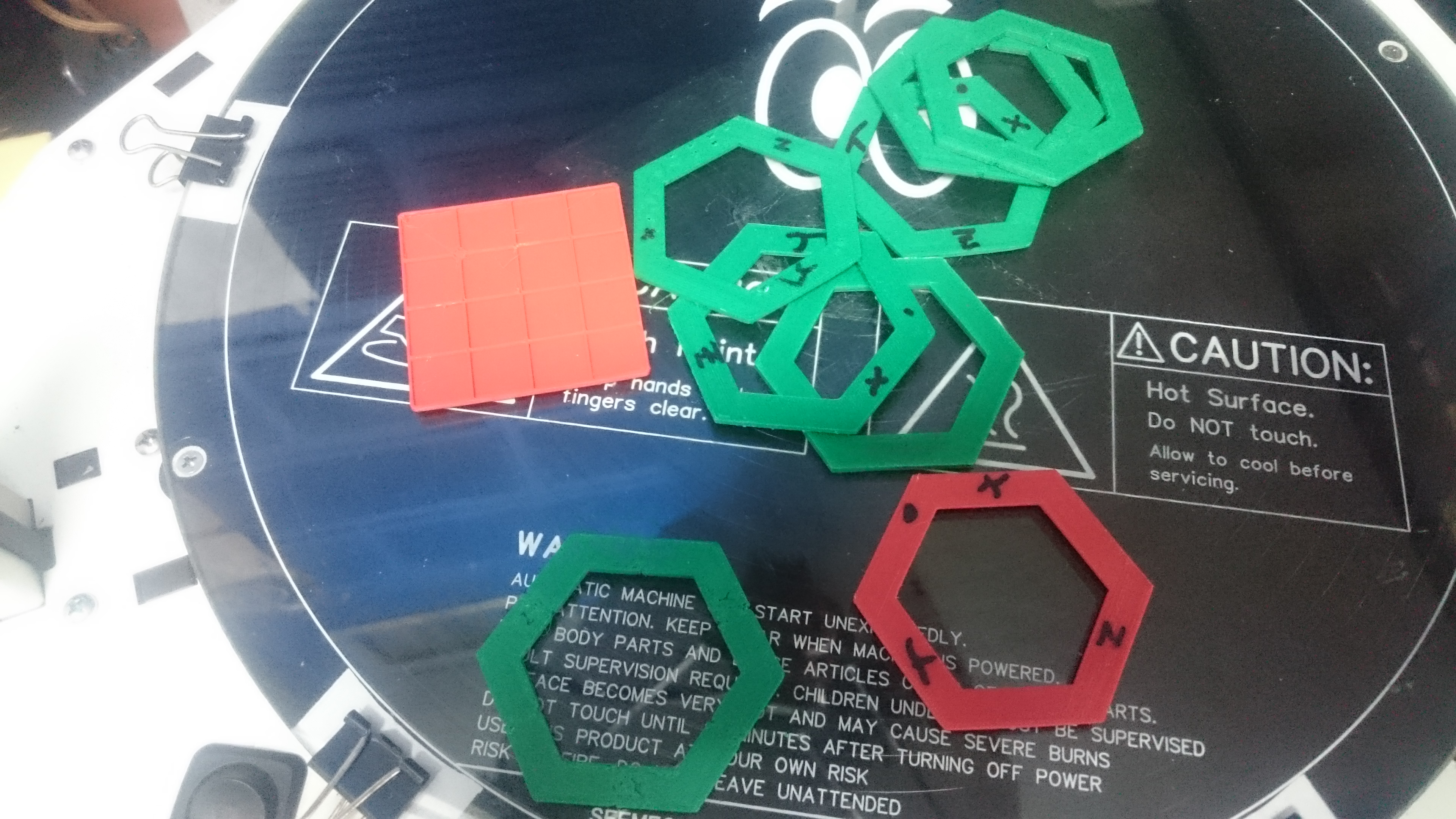

14 april 2018 I found: https://www.thingiverse.com/thing:1274733/
Hi Harblar,
When I start calibrating my rostock with the box 50x50x10
I noticed some distortions in my printer.
Hex50x50x2HOK1.stl
(1.05 MiB) Downloaded 1050 times
I would like you to use a hexagon better than the cube so you can play with.
repetier
