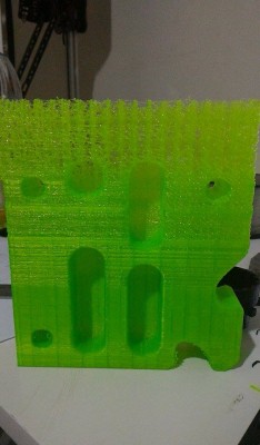

Any Ideas on what is causing this?
I have a Rostock Max V2 with an e3d V6 installed. I tried my first really large print last night and when I woke I had to stop the print because of this. It was set to 300 micron resolution at 190 degrees for the hot end and 50 for the bed. I have a suspicion that it is the feed rate cause by the PLA sticking to the inside of the hot end a little. I put a drop of oil on the PLA before using it which usually works but could it be possible that because it is a long print it didnt survive long enough? Thanks in advance for any help.

Almost looks like filament starvation. Maybe try to increase the hotend temp and see how it goes.

I'd suspect the bowden tube is getting pinched/kinked/deflected when the print height grows high enough. I found it took some careful study to get the hot end umbilical shaped so that it never snagged on the arms/fans and kept the filament path smooth.

Heat the nozzle so you can pull free the filament from it. Then move it back and forward to see if tjere is resistance.

Thanks everyone ill give it a try
