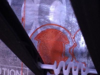

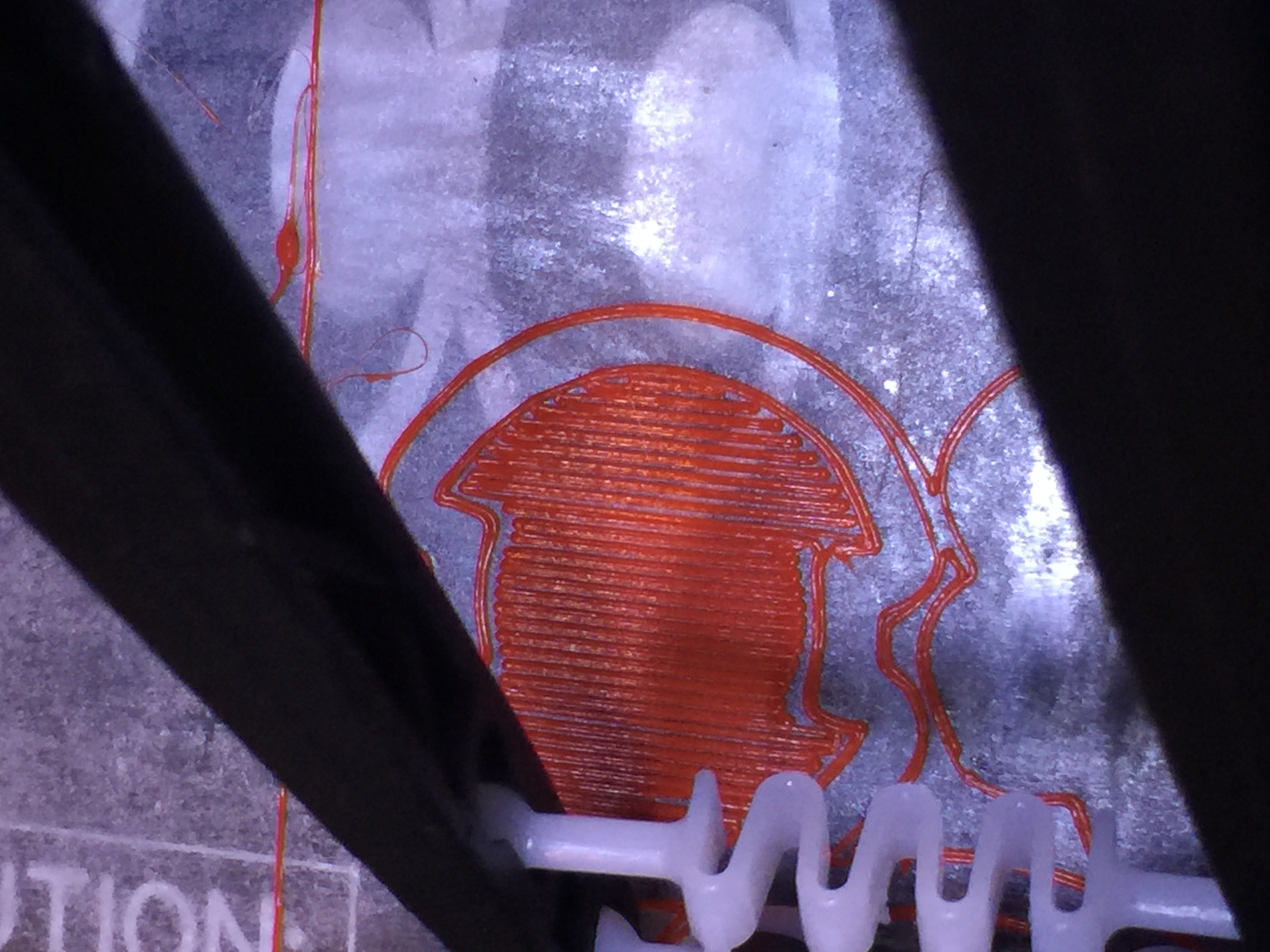

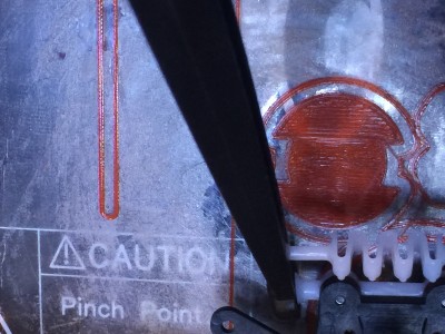

I am using everything stock, inc settings (except for calibration) for my Rostock v2
I am printing with pla.
Am I correct that this is under extrusion? Or could there be another cause?

Good morning! I am no where near as experienced as most of the people that frequent this forum but it looks as though your Z Height is high. I would try redoing your z height and see if the problem continues.

I agree the extrusion is to high. However, when I do the calibration, I used a .009 slider and brought it down till the hot end was barely touching. I also did the alternate calibration and at all three points it barely touches the hot end.
However, when I go to print it seems like it starts higher that it should. I noticed that I have automation technology steppers, so I went in to make the voltage change, but now the z axis only goes down half as much as the other two once a print starts (they all go down fine in the z calibration menu) so I need to figure out what is going on there. (I think maybe I put 15 instead of 150 on the z axis and now it is skipping steps). I was on my way to work so I didn't have time to investigate fully.

So I figured out a few things.
The calibrations I was doing weren't holding because I had inadequate belt holding power (and tension).
When I installed the belts on the machine, I had the belts come out at the center of both clips instead of folding them over. I do not know why I did that. Maybe because that's how my Prussa did it. It makes so much more since to do it the way the instructions say, and fold them over. I recalibrate do my machine, but I ran out of time to get it perfect, so atm I think the nozzle is a bit low.
Atleast the belt tension is correct.
