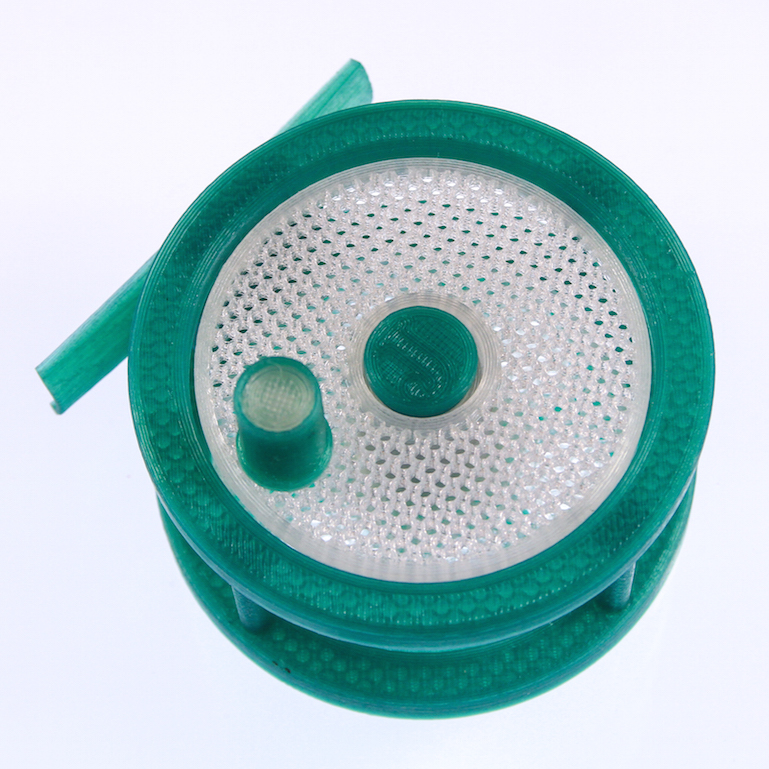

I *never* print with a wider first layer extrusion width. That is a band aid and is completely unnecessary. If I printed the wihte parts on this fly fishing reel with a wider first layer it would look like garbage. The open mesh face you see was the first layer. I encourage you to click on the photo to see the zoomed in high resolution image. This is why I get paid the big bucks
I'll fill you in on my secrets for perfect first layers:
I agree with Polygonhell, this could be a minor backlash issue. In addition to "sloppiness", tight joints can cause similar issues.
- polish the tip of your nozzle
- use the new sock if you have an E3D V6 hotend, they give spectacular results
- NAIL your Z height setting - if you move to Z=0.20 your nozzle tip should be at 0.20mm. Read my posts in my signature on how to do this with the single layer test print
- make sure your machine is well calibrated
- print on PEI that has been lightly sanded with 600 grit sandpaper
- ADVANCED TIP: use a little "clean" spit when you sand. There is something in spit that really helps adhesion. And yes, I am working to isolate it. Let's just say it has to do with sugar. A teaspoon of table sugar in 1/2 cup water will give similar results. If you use this tip, do not clean the PEI after sanding, leave the fine residue on the bed. This also fills in scratches and dents!
- clean PEI with isoPropyl alcohol (unless using advanced tip) and then DON'T TOUCH IT again
- double sneaky tip: print the first layer at 65°C and then turn down to 55°C for the 2nd layers
- unless you have a special need and know what you are doing, explicitly set layer width to the nozzle diameter and layer height to no more than 50% of nozzle diameter.
- for tricky first layers, print no faster than 15mm/s, for normal geometries, no faster than 25mm/s
