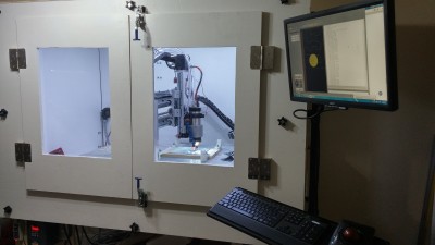

What brand of mill is this!!! Its amaizng!travelphotog wrote:6/24/16 UPDATE: We are proud to announce that our new CNC mill has us able to finally offer a much faster turn around time on our products. Though we now have a stated 4-6 day turn around time, most orders will ship in 2-3 days now. Our new mill is larger, faster and far easier to work with. We have and will maintain a large quantity of milled stock on hand for all of our products to drastically reduce our turn around times for orders.

It is a custom made mill from a guy in Canada. Full 3/4" aluminum plate and heavy duty 80x80 extrusion frame with full ball screws. It is a gantry style mill and has dual ball screws on the Y axis. We run a 2.2KW water cooled spindle and currently a fog buster coolant system, but that is soon to be replaced with a CAG system for a number of reasons. It runs NEMA 23s and is controlled by a Planet CNC MK3 9 axis ARM 32b controller with 4 LeadShine DSP Digital stepper drivers. Work area is about 21x32x7.  This weekend we are installed a new 4'X4' heavier duty mill with NEMA 34s and a new CAG system. the two mills share the same style of controller and drivers as we have found them to be 100% rock solid in our usage so far.  We have some nice ideas for the H2 and V2-V3 printers that will use the larger space and faster production of the newer mill. We name our mills (odd I know) Fred makes all the delta parts currently, but Hank will be making the new larger printer parts that we HOPE to show off at MRRF.

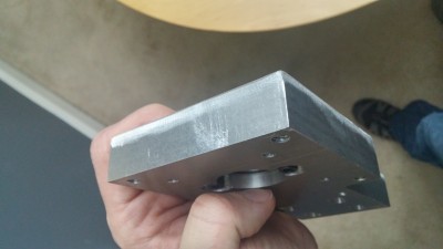

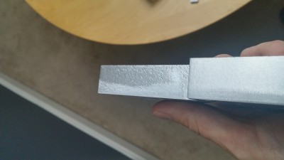

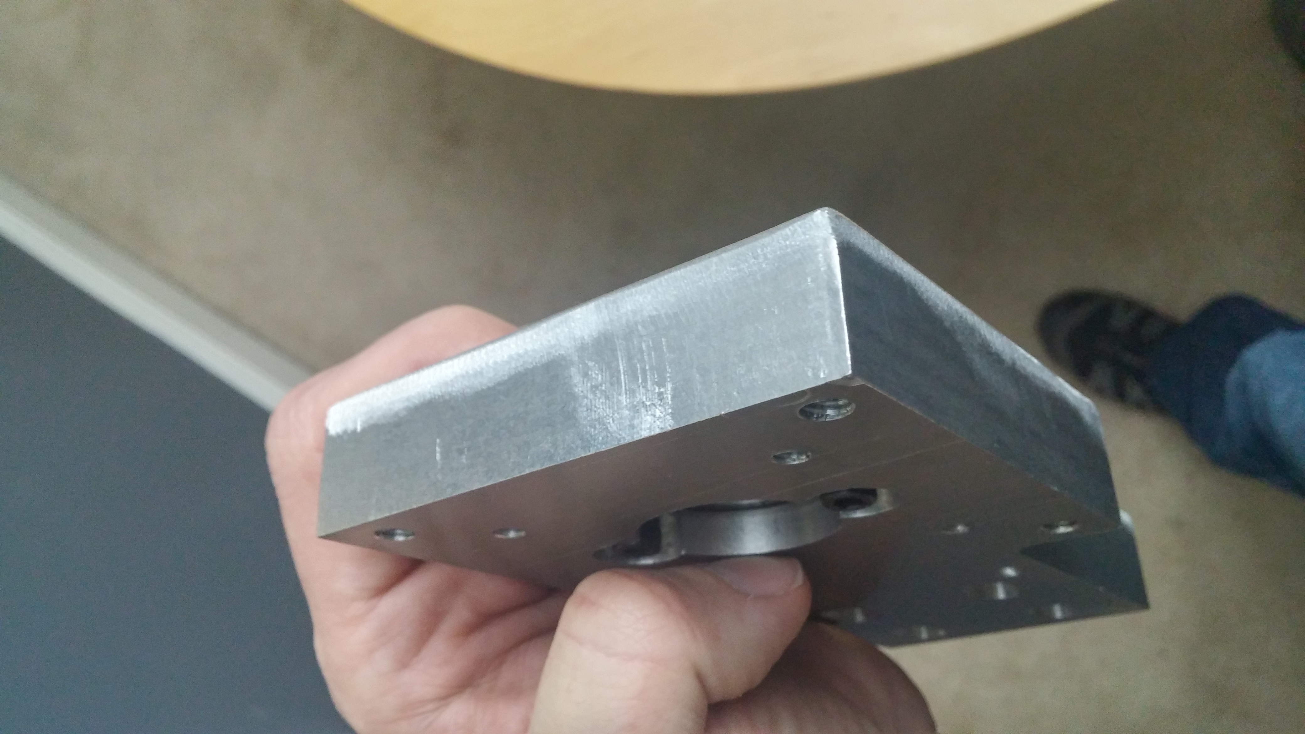

So here is the thing. I bought Fred (the mill in the pics) about 1.5 years ago or so. It spent 8 or so months in a crate while we got ready to move across the country and then got around to getting it set up in our new place. Once set up the mill was great and we have only really ever had one issue with it. It sheared a motor coupling to the right side Y axis ball screw just before the holidays while in the middle of a 6 hour run. This lead to the mill running a large plate for 6hrs with only one side of the Y axis ball screws to move things around. It finished the job, but as you might expect the part were out of spec. It also managed to get the mill about 2mm out of square over 32", which might as well be a mile.
So we needed a new larger mill and though it a good idea to use that as a reason to buy one while we worked to find where the mill got out of square at. So I called up the guy and arranged to buy a larger and heavier duty model that he makes which would have a 27x41x7 work area and better build overall since about 1 yr had passed since he made our first mill. This was Nov3rd and we were told the mill would ship by Thanksgiving which was not to bad of a lead time. We ordered his stock setup on that mill and were told that timeline was good to go. So there is where it turns bad. It was one delay after another and for 3 weeks in a row after our promised date passed, we were told it would "ship by Monday 1000%". Well on Dec 21st the ball screw mounts and spindle arrived. We were set 2 left side mount and no right side mount. Worse yet the milling on these parts was such that I would never even use them in house much less ever send them out to a customer. The parts were not square and the edges looked like a jigsaw was used to cut them out of 3/4 aluminum. Fred is made from 3/4 Mic 6 and not only is it nice and strong and flat, it does not hurt that it is nice and shiny also. Fred is a joy to mill on both in performance and looks for me daily. What showed up was not Mic 6 tool plate not pretty at all. But sadly it gets even worse.

That cut is the result of a very, very, dull tool.
