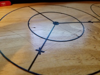

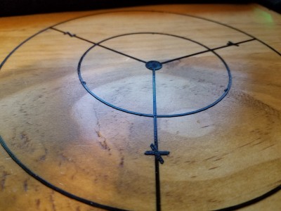

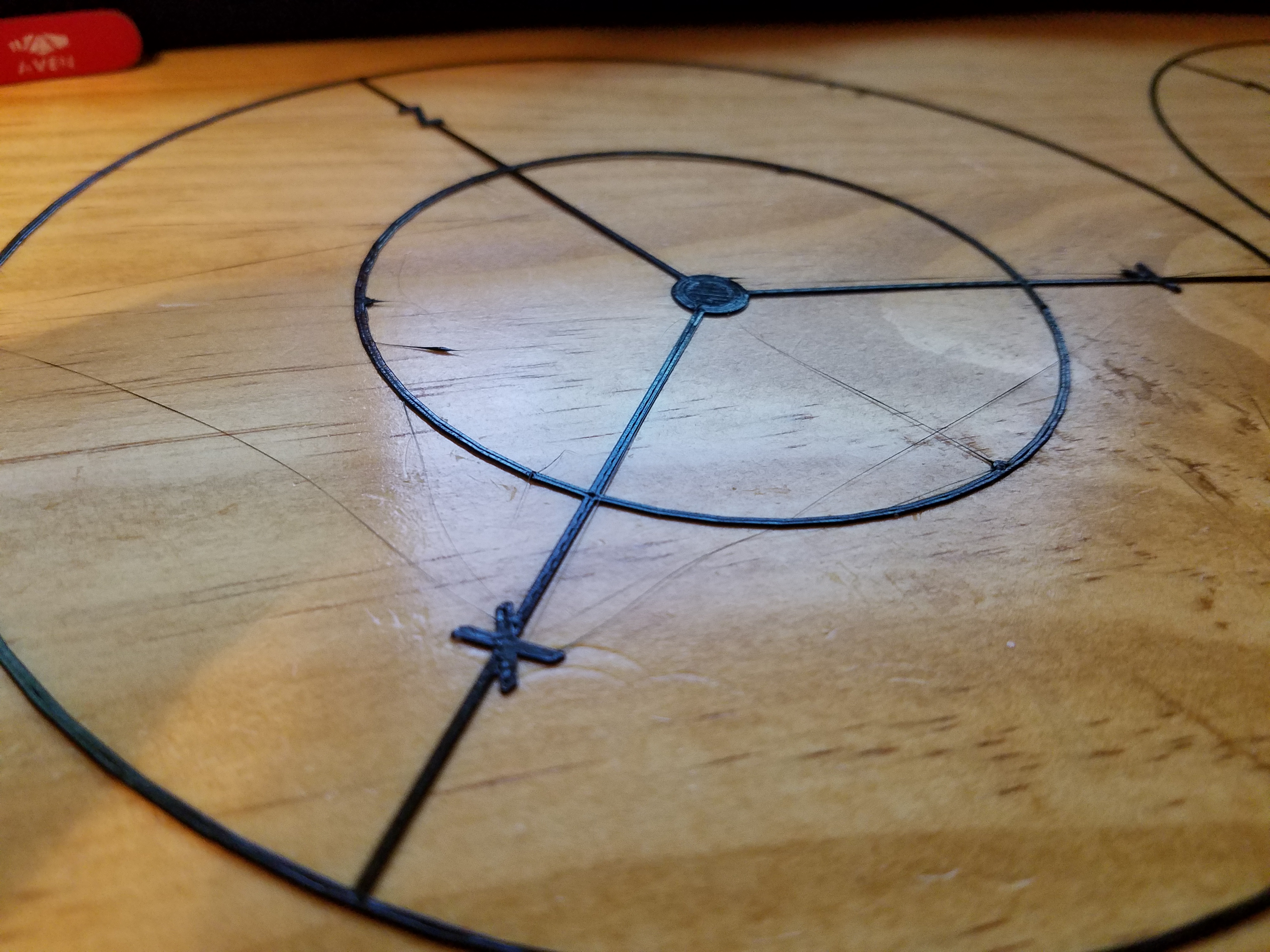

Fourth, I am having one hell of a time getting my bed level calibration correct. Is there a procedure for adjusting the end stop screws on the V3, or is their position auto compensated for with the calibration cycle?

Seems the bed does get auto adjust but you can reduce the offset of each plane by using just 3 clamps and ensuring the glass isn't being pressed down with the clamps
Here is what I read from another user regarding end stops. I haven't done this yet but I just fully screwed in all end stops and did a cal.
mhackney wrote:Once you have your V3 built and probing and printing here are a few things you can do to improve auto-calibration and reproducibility.
Tweak the carriage screws to get all three tower endstop offsets to within 4 steps/mm (or less). Travel is 80 steps/mm so 8 steps is 0.1 mm. The target 4 steps is 0.05mm. As you can see in the screenshot, mine are within 4 steps.
Here's how you do it:
Calibrate to get your baseline. After you calibrate, look at the eeprom settings for the tower offsets as shown above. In OctoPi I use 2 plug ins that make this really easy: 1) EEPROM Repetier Editor Plugin and 2) Custom Control Editor. I created a custom button that runs the v3Probing.gcode script, making it really easy. Here's a screenshot on how to set that up:
Once you have the control created, you need to put a copy of the script in: /home/pi/.octoprint/scripts/gcode/custom on your RasperryPi. The control automatically looks in the custom folder.
Ok, so you calibrate and then look at the eeprom settings using the EEPROM plugin. I've found that a 1/4 turn counterclockwise is about 7 steps. Start with your tower with the largest offset. Take the difference in the number of steps between the towers with the greatest values - so if Z was 21 and X was 8 and Y was 14 - the difference between Z and Y is 7. Simply turn the Z screw about 1/4 turn counterclockwise then re-run the auto-calibration and check again. Continue this process until you sneak up on <4 steps for all 3 towers. Note that you could also do the opposite of what I described above and increase the steps of the lowest tower value.
Once you get to a low step difference, run auto-calibration several times to check repeatability. If the steps change significantly from run to run, you likely have some sort of mechanical slop somewhere. Loose endstops, pulleys, steppers and belts are prime candidates. Hunt the problem down and fix it.

So I have made the endstop adjustments. X=0, Y=1, Z=3, but the unlevel bed remains unchanged.
I have also run the bed PID auto tune and the heating problem persists.
