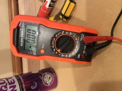

Ahhhhh, it appears I may have bought too sissy of a multimeter. It's says not to test on D.C. Greater than 10A and the power supply sticker says 29.7A. Sorry I'm being such a pain with the questions, this is what getting raised by a single mom gets you, completely stupid on man tasks.
Attached pics of my wimpy multimeter to confirm or deny it's too wimpy for the task.

Well, much like when I was an Artillery pull string go boom guy in the Army, I shrugged and used the multimeter. Nothing died and I was registering 12.11. I went ahead and cranked the juice up to 12.60. Time for a test print!
Re: How Adjust Potentiometer?
The 200 milliamp and 10 amp restrictions only apply when you're measuring current, not voltage. In addition to selecting the selector dial and hooking things up differently, to use the 10A scale you actually have to move the red probe over to the 10A socket. I'd suggest learning more about electricity before attempting to measure current...and start out with small battery circuits.Ravitch wrote:Ahhhhh, it appears I may have bought too sissy of a multimeter. It's says not to test on D.C. Greater than 10A and the power supply sticker says 29.7A.
Your limit on measuring voltage is 600 volts. Not an issue in this case, and as you discovered, it worked fine.

As Eric says, don't worry about the "wimpy" amperage restrictions. He's entirely right about that, and even an industrial multimeter designed for 1KV is usually only going to have 10A of amperage sense. For larger amperages, either clamp on, or specialized equipment is usually a better bet. If you were to over-do the amperage (Such as by hooking an amperage test multimeter in parallel rather than series(IE, touching it to two parts of a live circuit rather than disconnecting the circuit and remaking connection through the MM)), you would likely only blow a fuse, and thankfully for cheap multimeters like that, the fuse is also cheap, unlike some with 20$ fuse sets.
Re: [Solved] How Adjust Potentiometer?
When it's reading current a meter has to have a very low resistance. When it's reading a voltage it has to have a very high resistance. So a meter in volts mode is pretty safe to have an accident with such as by touching terminals you shouldn't be touching or accidentally grounding a probe on the chassis. (You can still short stuff out with a single probe of course.) If I'm reading current I try to have the meter firmly attached to the circuit before I switch the power on. I used to have a nice antique panel-mount amp-meter with the needle literally wrapped around the end-stop because it touched something it wasn't supposed to for a fraction of a second. No such problems with volts unless you try to measure mains on the 2V scale.
