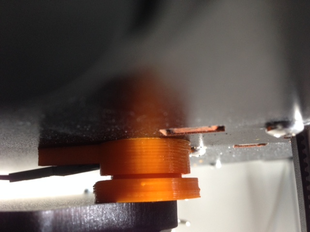

Re: crocky's Rostock Max V2 Build
FSR's for Calibration, the way to go!
Buy the FSR kit from Ultibots they make the implementation of these things a breeze.
I used my own mount and piston design, you can copy mine if you like or go ahead and design your own. Wire the FSR's to the board using the provided harness wiring. I used the thin pads and I stuck them onto the centre of each FSR. Make sure that the pistons are a sliding fit in the FSR mounts but have no sideways movement. The FSR consist of three mounts so the other three holes will have to be bolted to the plate only and not to the top of the Rostock.
The wiring from the board pins marked +/-, -/+, S goes to the Rambo board Z-min endstop position +, -, S. No wires are changed, just use it as is. The important wire is the one that goes to S pin.
The following changes are made to the firmware in the configuration file and then written to the printer.
Edit: Must be something with being downunder, pic's are upside down!!!
Configuration.h
#define FEATURE_Z_PROBE true
#define Z_PROBE_PIN 10
#define Z_PROBE_PULLUP true
#define Z_PROBE_ON_HIGH false
#define Z_PROBE_HEIGHT 0
See if the probe works, send a G30 to it and see if it moves down and is triggered.
Now go and get Rollie's latest Delta Automatic Configuration Utility and give them FSR's a workout!
Configuration.h
Crocky, are you screwing down the FSR mount using a #4 flat head and the original Onyx t-nut that's installed in the base?
tnx.
tnx.
Close, I am using the tapered screws that were provided in the kit for the three FSR mounts.
I then cut about 1/8" off the remaining screws and used countersunk heads for the FSR Pistons with normal nuts. I then used some 1/8" by 1/2" screws and spring washers and nuts for the other three holes in the plate that are not connected to the Rostock now.
Bob
Delta's are the way!
So you're screwing straight into the melamine base without using the existing mounting holes?
No.....
I use three of the holes to mount the FSR mounts on to, then I just bolt the other three directly to the plate with the short 1/2" screws and spring washer and nut.
