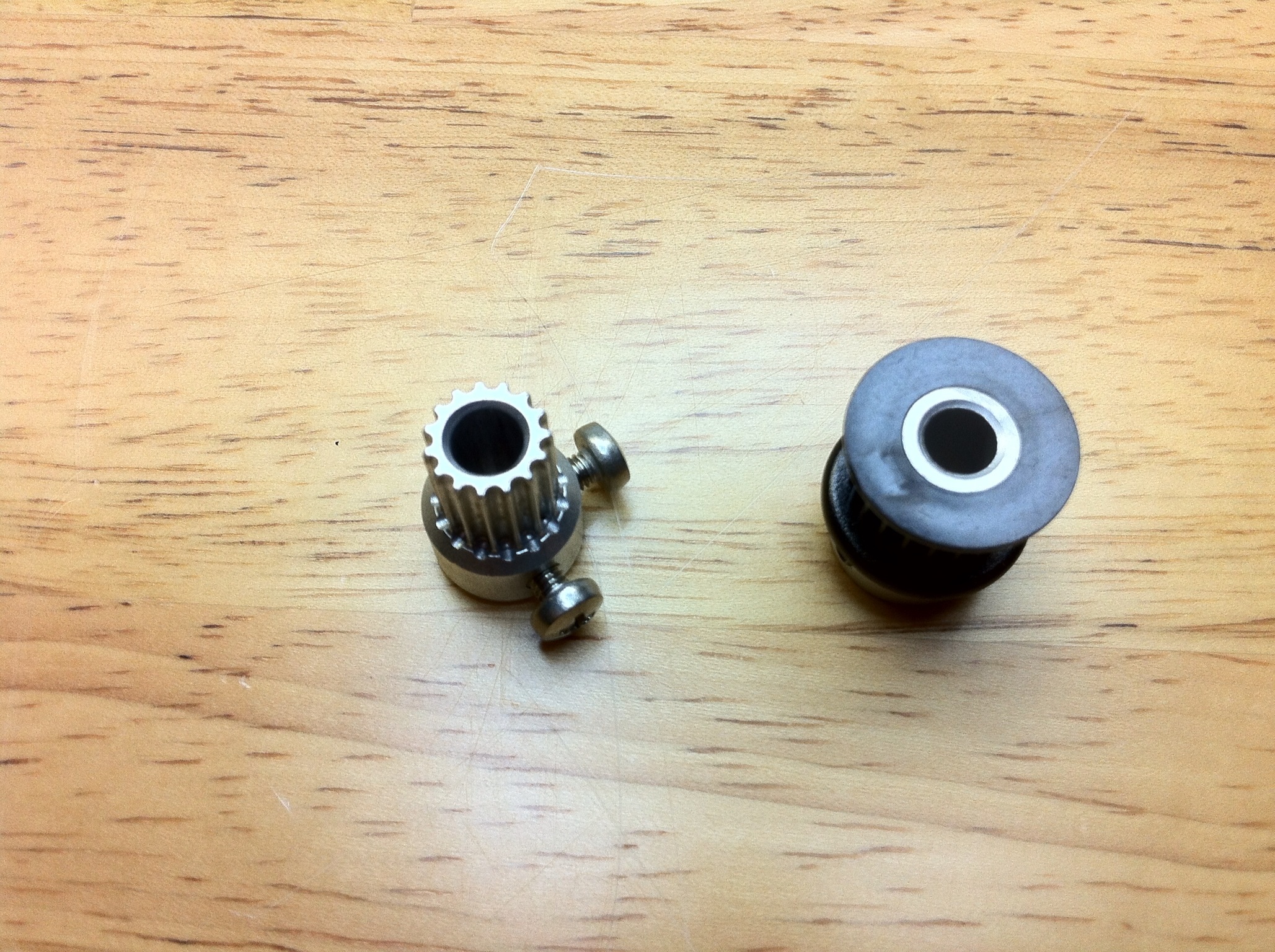

Here's a picture of a new 20-tooth pulley next to a 15-tooth pulley. The old pulley has half-round valleys between the peaks like I'd expect, but the new one has flat-bottom valleys, flat-top peaks, and flat sides on the teeth. Doesn't seem quite like it fits the belt profile, but it claims to be GT2. The pulleys are from RepRapDiscount, apparently, from the URL on the pulleys.

Here's another picture showing the half-round valleys on the old pulley.

These things come with some seriously small setscrews and an Allen wrench (about 1.5mm). Don't drop one; you'll never find it again.
