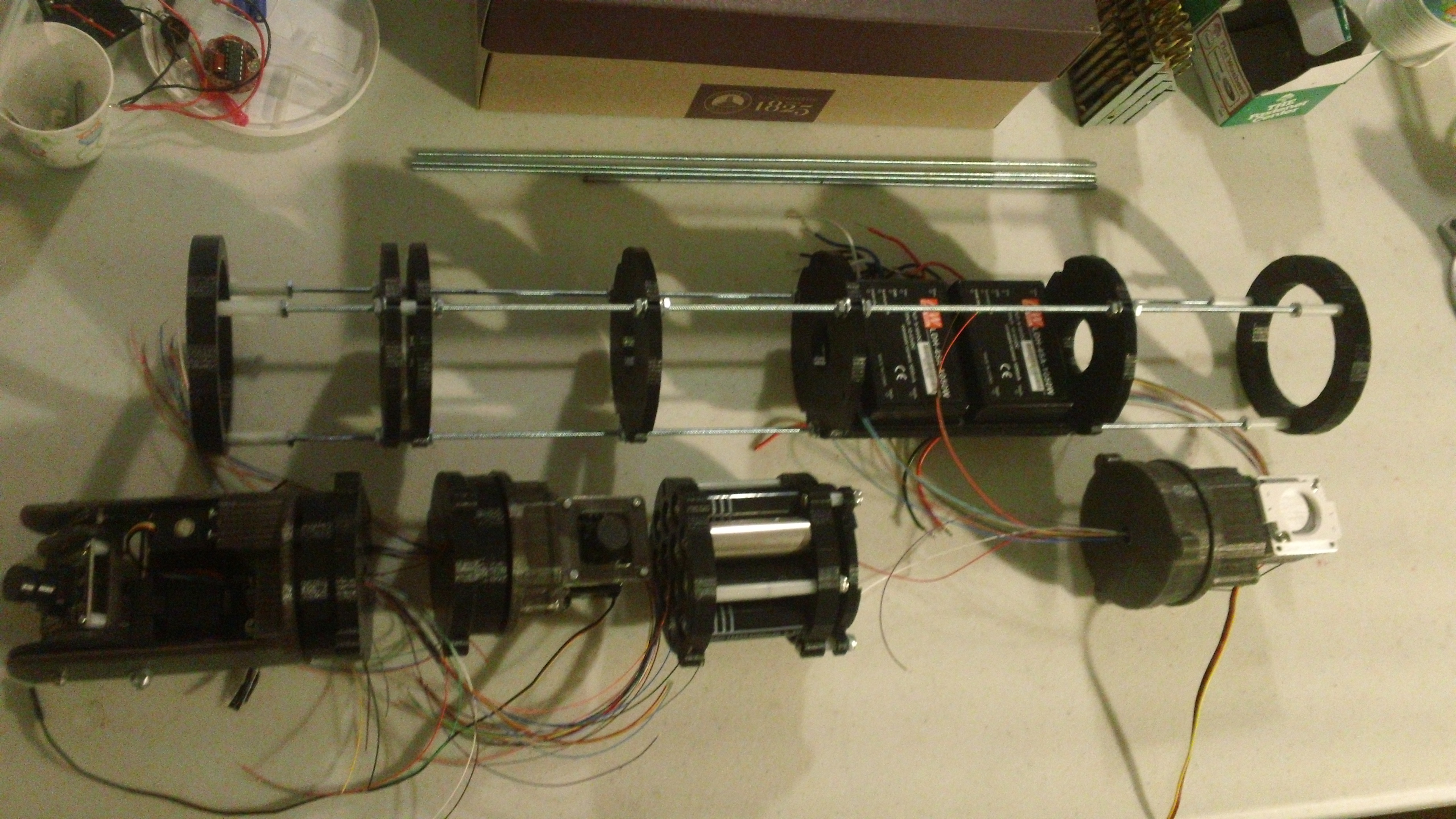

here is a pan/tilt video
camera platform i've been working on. uses RC continuous rotation servos for pan and tilt. still have to add some limit switches for tilt axis.
has a rotary slip ring on the pan axis for continuous panning. Made using an orion delta and T-glase all around. This is the first print, came out fitting pretty well could use a few tweeks
for better fit. Will be used in a subsea drop
camera facing downward thru an acrylic dome view port. Designed in creo cad element express.

Nicely done - how are you getting the camera signal through the slip ring (given high data rates, everything becoming an antenna etc)
Re: Pan and Tilt camera platform
Posted: Tue Sep 29, 2015 2:09 am
by Tinker12
I have tested the slip ring with color video
camera ntsc analog signal and the servo power and signal at the same time without any problem. The slip ring data sheet says there are 12 rings so I placed the video power and signal next to each other and the servo signal and power next to each other instead of mixing them up. The slip rings has 12 conductors, 12 rings, got it off ebay for about 9 dollars, its part #

oh no now you got me started!, The sub is almost an ROV, it is a drop camera that may be upgraded to an rov in the future by adding (4) BlueRobotics thrusters. It uses a 4.5" O.D. acrylic tube and dome housing by BlueRobotics. The tube is oriented vertically with the dome facing downward. The p/t cam looks out the dome with lighting mounted external to the tube while another pan camera looks out the side of the tube ( possibly a hacked GoPro 3 which can supply live video as well as take high res clips and stills). The subsea end runs off a battery pack and has basic sensors (depth, compass, temp, etc ) as well as a sensitive hydrophone to hear marine life, mainly whales. Everything subsea is run by an arduino Mega 2560 and custom shield. Control and telemetry is over RS-485. A modified Cat5 cable is the tether with one twisted pair each for video, hydrophone and rs-485 plus ground. Topside is another arduino mega and uno for control via a game controller and all data on a video overlay screen. The Orion 3d printer is invaluable in the project and i plan on making more parts using it. As well a a local fellow who has a cnc router to make the drop cam framework out of plastic sheet. All this is for a local non-profit Marine Science Center to use in their program with youth and adults offshore on a boat, so far they can only see and hear whats happening on the surface with the drop camera they can get a peek underwater , at least up to 250 ft deep.

Pan and Tilt camera platform update
Posted: Sun Oct 25, 2015 3:31 pm
by Tinker12
got to love these 3d printers!
printed two more servo pan units for LED light and a video
camera placed in acrylic housing also decided to make a rotor vane type water current meter, worked out great, printed at 70 % infill will with black t-glase
will use a coating to water seal.
http://www.smooth-on.com/index.php?cPat ... baj3pter00.
Current sensor uses magnetic bearing for very low friction, just used ring magnets similar poles facing each other on top and bottom with a pin thru center.
Have lengthed housing tube from picture to accomodate all stuff it is now 24 inches long 4.5 inches diameter.
orion printer works like a champ. Had slight problem with center pin for servo units not being perfectly true along the center axis, a little tilt, i.e. tilted as it is printed upwards from base, does anybody know what causes this?

the drop camera has two ntsc video cameras at this point. one is mounted on a pan tilt platfom facing downward with fixed lighting, the other camera is facing out of the tube housing horizontally and pans only, the led light is mounted on a similar pan platfom about 12 to 14 inches above the pan camera, it pans in sync with the video camera. both led light and camera have continuous pan capabilty with an position feedback sensor on both so they can sync movement. the led light is a cree model and can output up to approx 3600 lumens. I want to minimize backscatter into the camera thus the reason for placeing the camera an light as far apart as possible.
