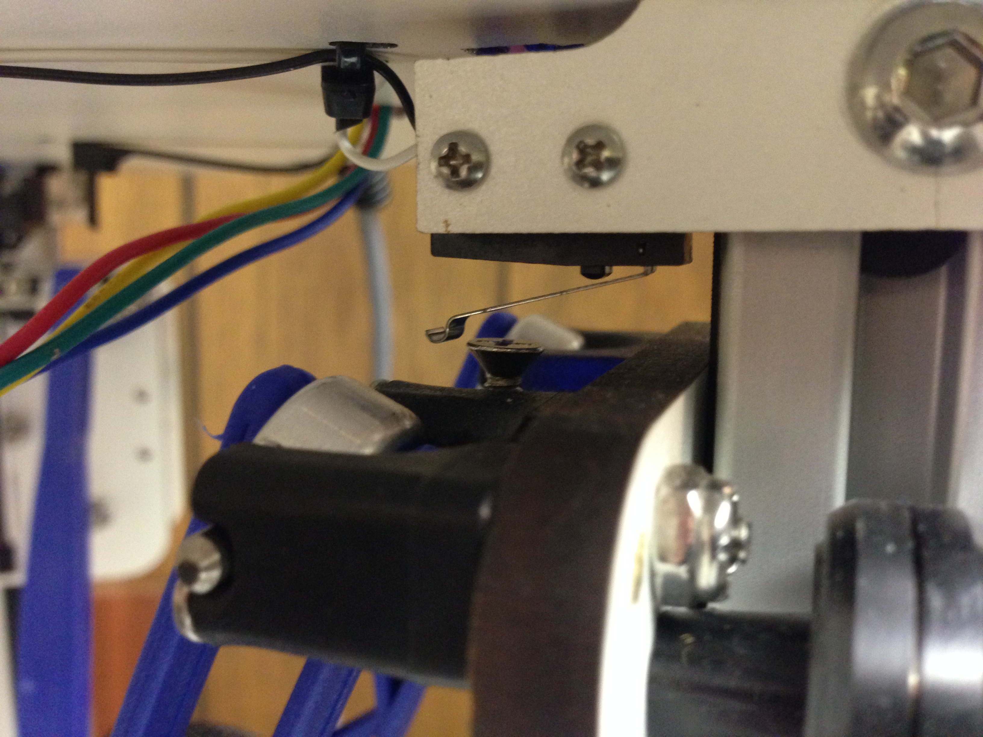

I have upgraded using this fork. A few things.
First is my menus now appear to be in German.
Second is that after I home it immediately drops a few mm.
Where as before it remained pinned to the top. Is this now the expected behavior or is something off? I had to adjust my z-height -4.7 mm.
Finally one of the benefits of this upgrade was to be able to adjust printer_radius in EEPROM, yet I do not see a printer_radius variable. I do see 3 delta radius variables. Are these the ones to adjust and if so in what way?

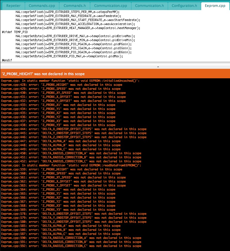

Any help somewhere on using the configuration tool? I'm getting constant stops on prints I need to try to upgrade
There's lots of pages with info I've never heard of before, can't find any help pages
I used the Repetier AVR folder from 0.91 and replaced my config.h file and tried to upload to the Rostock Max with Arduino but I get these errors.
Doing it wrong?
thanks
A

truenorthtrader wrote:Any help somewhere on using the configuration tool? I'm getting constant stops on prints I need to try to upgrade
Doing it wrong?
thanks
A
I tried doing what you did, copy a previous config.h and I got the same error. I think you have to use the new config.h file and transfer over your machines values into it.

Post by truenorthtrader »
Thank you , so I just tried that twice. When it uploaded to the Rostock using Arduino, the Motors are making a ( da, da ,daaa daaaa )sound every few seconds like power is going through them and the heated lights on the board are on.
I'm using theRepetier Firmware folder inside the ArduinoAVR folder is that the right one?
Is there info on using the configuration tool? There's lots of parameters to fill in that I'm not familiar with past the first page
