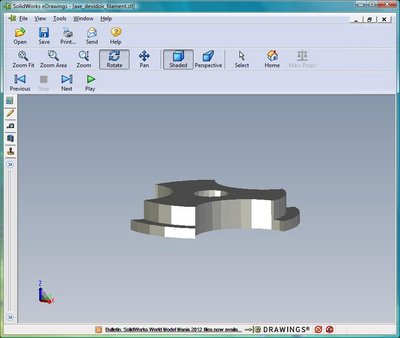

Got my bearings and put my stuff together!!! First off, i made some spacers (bushings) to go between the 1/4-20 all thread and the 608 bearings. You need to print these slow with 1 perimeter and multiple at a time. Also I had to use the Z Lift function to keep from nocking the parts off the table ...

Mike, I printed out one of the 18909 spool adapters last night to take a look at it and so far, so good. I am expecting my bearings in the mail today so once I get those I will post up some pics of the adapters and the bearing spacer I just made and currently printing. Getting some use out of "Lift ...

Thanks Mike. How did you do that? The problem I see is that it wants to print the perimeter first (which falls right into the hole) then do the bridge. How many perimeters did you use on the print? I used 3 and I wonder if that was kicked up higher it may work with less slop. I don't see any way to ...

This is the orientation.

Dave,
Printing it outside portion (sticks out of the filament spool) down.

Mike,
Did you use ReplicatorG to make the spool adapters? I can't make them with Slic3r as there is no way to generate support material and it screws up the bearing pocket.
Thanks,
