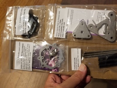

Just as an aside, the kit for the E3D hotend was an easy one to put together and assemble. Everything worked well. We had to order the following: Probe Board Adapter Item# PB-ADPT Hot End Groove Mount for Rostock MAX Item# RM-JHGMNT Carbon Fiber Tube Stand-Offs 36 MM Item# CFSTAND36 trick laser.jpg ...

Did the swap on the spare effector we had. Pictures attached. Loots great. It is a nice upgrade. Redid the autoleveling config as well. BUT IT DID NOT HELP :( I am not sure what is wrong, but I know what it is NOT: 1) It is NOT the extruder (theirs or the GregsWade) 2) It is NOT the filament 3) It ...
