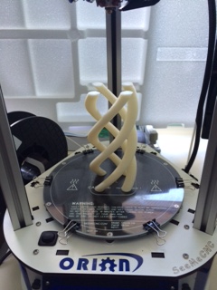

Here are some closeups (the best I could do with my phone). The starting outline seems to never print immediately, then prints and peels, then prints and sticks. It's 0.37mm thick with a few bubbles in it. More flat rather than rounded. The spiral bones (when removed from the plate, they look like ...

I got my Orion after the contest was closed. UPS manhandled it and I've been calibrating it ever since I received it. Given that it managed to print this challenge, should I be happy with my calibration?
