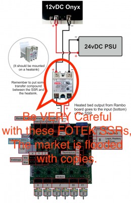

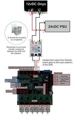

Hi all,
Issues with my 24v Heated bed. Have set it up as per the picture below but have the same issue whether I use 12v or 24v beds (have a V3 24V Bed as well as the standard bed that came with the printer).
So what happens is:
1. Switch on Printer,
2. Switch on Switched 24V PSU,
3. Set a temperature.... Nothing happens.
If I either then switch the 24v supply off and on again or I disconnect the bed and then reconnect then the heat comes on, but it wont go off, it just stays there until I switch off the 24v supply again to stop a runaway heated bed.
If I test it with a voltmeter at the end of the 24v supply it switches on and off as I set heat on and off. Really strange behaviour.
I have tried swapping the SSRoutput so that it either interupts + or - lines and it makes no difference.
I'm completely flummoxed now and wondering if anyone has any ideas?
Its set up like this (though bed can be either 24v or 12v one makes no difference if I swap them around).
Edit: PSU is this one: https://www.amazon.co.uk/gp/product/B01 ... UTF8&psc=1
SSR is this one: https://www.amazon.co.uk/gp/product/B00 ... UTF8&psc=1
Thanks Tincho85 for the diagram.
So what happens is:

JaseGillUK
- Plasticator
- Posts: 11
- Joined: Wed Jun 15, 2016 8:42 am
Re: Faster Heated Bed Issue
I have only just noticed.
My SSR is DC in to AC Out. I think that might be the issue.
Looks like ordering a DC -> DC one and seeing if that fixes it
Jason.
Jason.

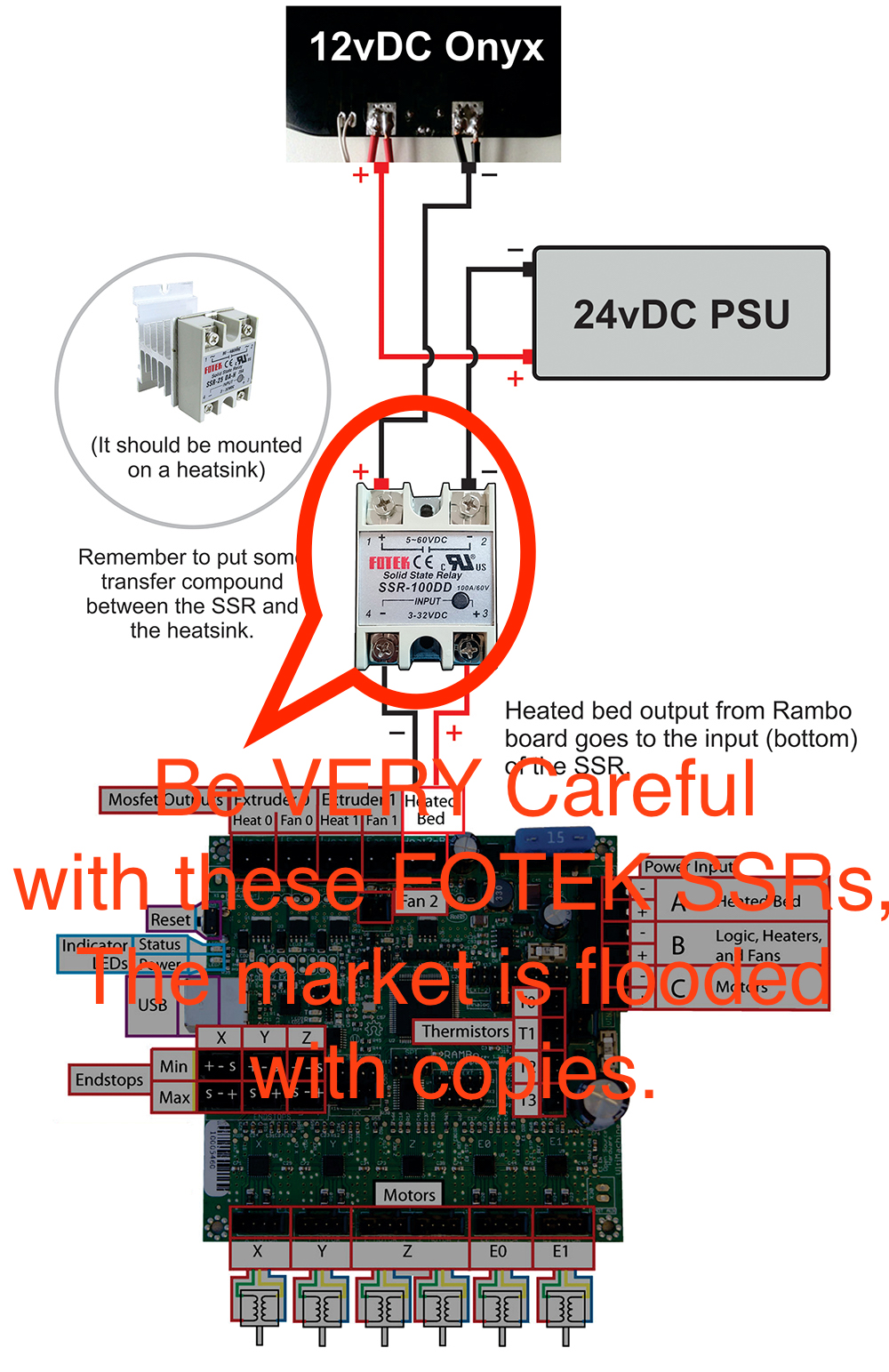

PLEASE PLEASE PLEASE all. Firstly, SSRs are really a GREAT way to go to power your beds. BUT PLEASE READ THIS: How to Choose an SSR to Drive Your Bed
and this: !!!! DANGER DANGER !!!!
And NOTE, it is not a question of simply greatly increasing the amperage specs of the SSR, it's the voltage DROP across the terminals that produce HEAT that WILL start a fire.
When on, the voltage across the SSR should be nearly zero.
If you have 23.7V at the power supply and zero at the bed, then either you have a bad connection somewhere or your SSR is bad.
Measure the voltage across it. If you have a good one like a Crydom or Auber it will have less than about a 0.2V drop while on.
If you're measuring full voltage across the SSR and the LED on the SSR is on, then the SSR is bad.
JaseGillUK
- Plasticator
- Posts: 11
All,
Its fixed. A new Fotek SSR 100DD and it works as advertised.
Yet to stress test it but it comes on when the bed requests it and goes off when its up to temperature.
Now to stress test the Fotek and the PSU along with the new 24V bed.
Thanks for everyones help, such a friendly, useful forum here.
Jason.
