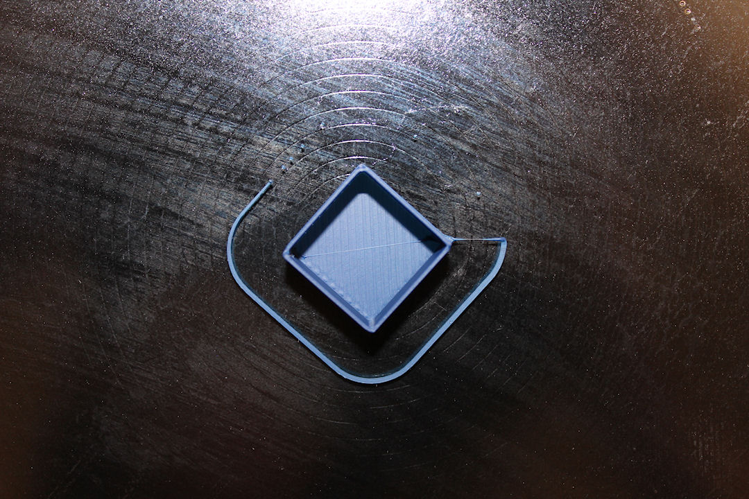

I'm using KISSlicer version 1.1.0.14 for most of the files I print on my Rostock MAX. Eventually I need to upgrade from the "free" to the paid version.
I am printing with ABS exclusively and use a raft under most of my prints (the latter statement is irrelevant). Every time a print starts there is a run of about 60mm or so where filament fails to come from the extruder. It does finally start and then continues to flow reliably until the print is done.
When the print starts the extruder sounds like it does a quick "suck" at about the same time the axes return home (the happy "G28" command).
Are other users seeing this same problem? Has anyone sorted through the g-code to see what's happening? And has anyone developed a simple G-code fix/patch?

Do you manually prime the extruder before running?
I usually manually bring everything up to temperature, then extrude 10mm at a time until I see filament, then click the start print button.
The issue is that plastic dibbles out after the print and as the head heats for the coming print and that has to be replaced.

Thanks, Polygonhell. I've tried "manually" priming, but it offers limited help when wanting to print from the SD card. The code you posted is similar to the strategy noted on the KISSlicer forum. My bed is flat. I'll give it a run (and hold my breath!).
Here's a photo of the happy gap...aargh! Probably 30 to 40 mm, not 60 as earlier posted. Bill

I think I would just put the code Poly posted into the start of every print, maybe move the nozzle further off to the side though. In the past I reduced the amount of stringing at the start by bringing the nozzle to the start point of the print before heating the nozzle. It helps to minimize the difference but does not eliminate it. Now I use my nozzle wipe thingie to do it, it has helped a ton. When I first started using Kiss on my MM it would do this, I switched to relative e-units and never looked back. I now use absolute on the MAX though, seems to be fine.

The loud "POP" you may have heard was me pulling my head out of my a**. I finally waked up to the fact that preheating and extruder priming can all be done from the LCD. This makes it easy to heat the bed and extruder, extrude 20 mm of filament, and, then, immediately start printing a file from the SD card. Perfect!
