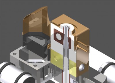

What hot end is that, and why does it have a pipe on it?

The hot end is my own design, the pipe carries air from a positive displacement pump to cool the print very soon after the new filament has been deposited. This does work but I am presently exploring using a perforated ring similar to the "Berd Air" design. Picture below shows a cross section of the hotend.
