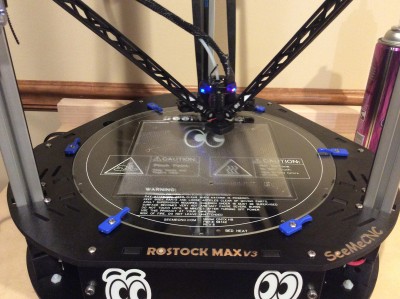

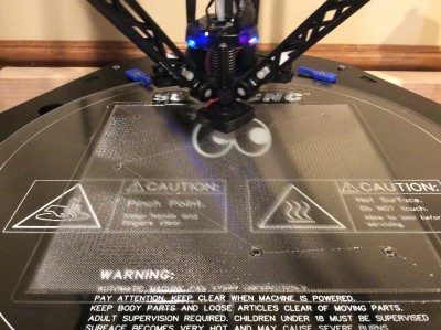

On a bright note, this is the first issue that I probably didn't cause myself, and I can print a perfect first layer circle that covers the entire bed with not a single gap, bubble, pimple, etc. I've never had better first layers.

1st layer almost complete and hasn't failed yet, with the bed off. It hasn't made it to a third layer with the hotend over 220 without failing, but the bed heater was always on. But what a beautiful first layer.
