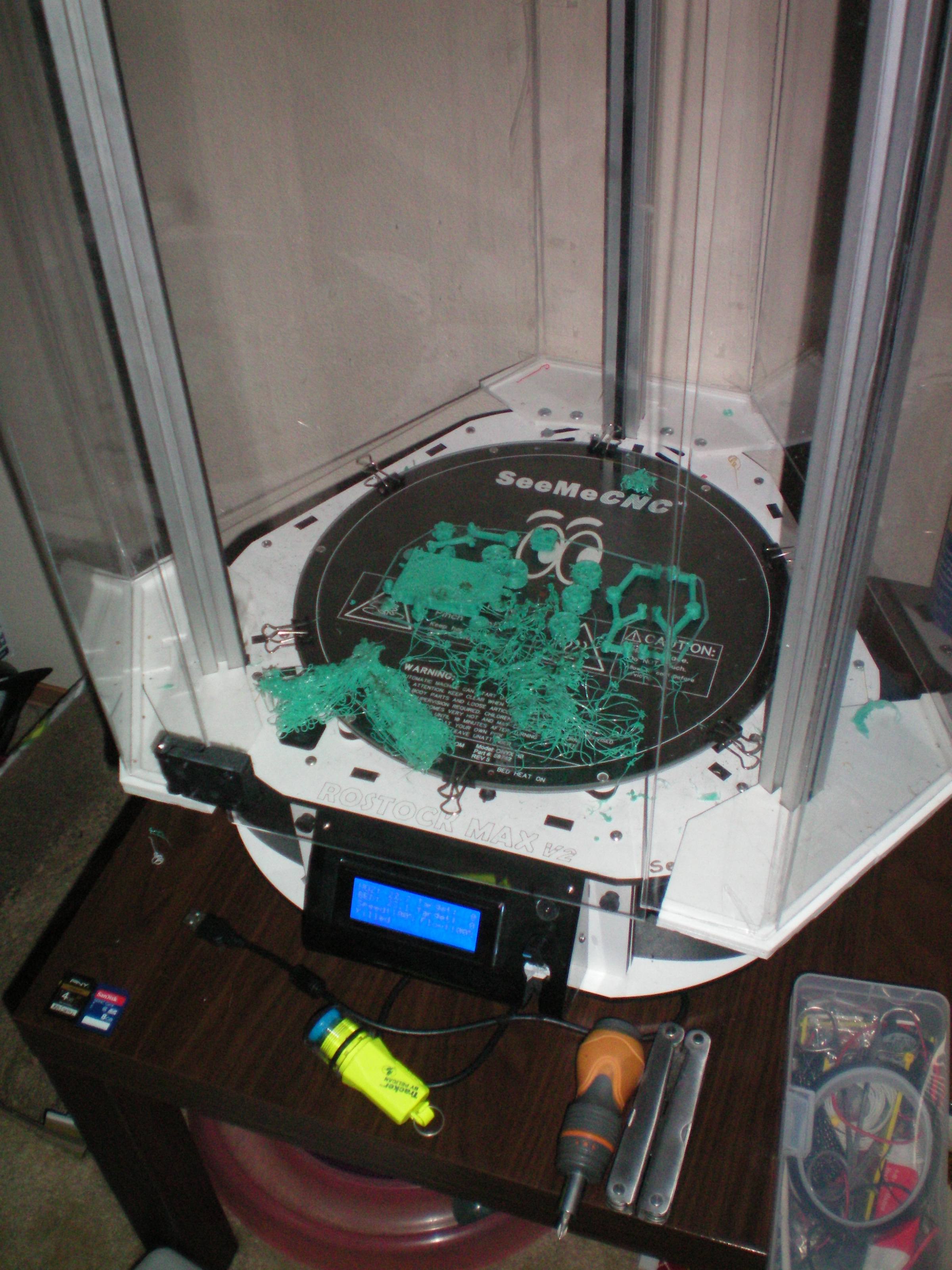

Posted: Sun Nov 08, 2015 8:07 pm
by gaexcalibur
ok gene i wasted $100 on a new power supply spent an entire weekend intalling it, leveled the bed spending 4 hours just to make sure it is prefectly level, all towers square everything is as good as it gets. i did one single print as a test and it worked. so the next day i try to print a larger object, start printing what i really want to print only to have the thing smash into the glass chipping out a large chunk. flip the glass over as one side is still ok, relevel the bed again!!! then print, again one successful Benchy printed. without turning it off or resetting i reprogram the part i need to print and again it smashed into the bed destroying the glass. so now i need to order a piece of glass to go with the power supply i just replaced. how come i have to relevel the print bed every time i want to print this should not be this hard once level it should not change it has not moved the same settings are used for my benchy test as my regular print and smash it goes can anybody explain why this printer needs 4 hours of leveling every time you want to print????? i know others do not have this problem so this is insanely stupid why does this printer get awards when you cant make it work??? and the bed was super level i did not take a picture but the test rings came out perfect, benchy came out perfect real print does not work and smashes the glass to bits, 2 different programs two different days with the bed leveled completely as flat as can be.
Re: printer leveling
Posted: Sun Nov 08, 2015 9:01 pm
by Xenocrates
Has you tried decreasing the rapid speed in the EEPROM? it may be that the steppers are not able to decelerate the head fast enough, and it's hitting the glass. Also, what beyond benchy have you done to calibrate it? Is benchy something you use the normal slicer for? Have you attempted Z height calibration, or used openDACT at all?
