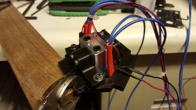

im currently printing a redesigned dual ezstruder mount that allows for room for the heat sinks we ziptied onto the extruder stepper motor after noticing it was considerably hotter than the other motors. so i made mounting holes to mount a 120mm fan (low speed n quiet) to help pull across the fins. Ill put up some pictures tomorrow or whenever i get it thrown together.
Re: Yet Another Dual Extruder Design Attempt
Posted: Mon Sep 28, 2015 11:29 pm
by CaptainMerica
Hello again,
Well i have my new platforms in hand, just need to get the cross holes popped in, and I wired up the hot end to the rambo board, following the manual and other posts regarding heat 0 heat 1 t0 t1 etc etc.
printed platform assembled (just for testing)
I'm to the point where I need to make the firmware changes, and I'm not sure if i am just out of it or what but I am simply chasing my tail.. well.. if i had one ya'know...
I have scoured the forums and found various threads with what appears to be a table of the lines that need to be modified, but where exactly do i find/edit/upload/flash or whatever the firmware file?
http://forum.seemecnc.com/viewtopic.php?f=36&t=7532
http://forum.seemecnc.com/viewtopic.php?f=77&t=7447
http://www.repetier.com/firmware/v091/
I'm usually stubborn and proud enough to attempt to figure stuff out myself before ever asking for help but I am just to worn out to care right now haha. (from remodeling my house all weekend)
oooh, also, got my 24v power supply, solid state relay, world of difference, 2 min heatup instead of half an hour, got the trick trucks and 325mm CF arms installed, and the heat spreader. prints have never been better. life is good. but now I have the aluminum platform and the stock hot end got plugged today because the filament had a knot in it (kinda) on the spool and it broke the filament and cooked it in the nozzle for 4-8 hours on high. so i figured why not swap to the new hot end if i have to take it apart anyways.
aluminum platform without cross holes yet.
If anyone can help me out with this I will be ever so grateful. Heck, i'll have 2 extra aluminum platforms if they all turn out good once machined ;)

Okay, here's a little bit back on the original topic!
The dual extruder holders are printed and installed. The big effort here was a substantial teardown to add t-slot trim and run all the extra wires to support dual extrusion. So far, so good! Here's the current revision of the holder, design view, and printed and installed:
[img]http://gchristopher.net/3dprinting/dual ... design.jpg[/img]
[img]http://gchristopher.net/3dprinting/dual ... t_look.jpg[/img]
I'm not sure I'll stick with them in this location in the long term, but I think those extruder holders definitely achieve the goals set out for them! After a couple more tweaks and some code cleanup, I'll be publishing those.
I need to either find a darker background or stop printing in black all the time. Also, they form a very solid frame; those suckers are some beefy rigid extruder holders!
Regression testing (making sure I didn't break anything) has started, and one test print turned out fine.
Next up will be installing the second hot end and working on firmware changes.

Well, it all works! :)
I called this one a class project for the 3d Printing and Robotics class. Here's the full writeup.
The STL files are posted to Thingiverse and the source code is on github:
Dual Extruder Holders on Thingiverse. Source files (OpenSCAD, stl, dxf) on github
Printed Effector Platform and Dual Tool Holder on Thingiverse. Source files on github
The biggest positive surprise (other than getting dual extrusion working at all) was how well the printed effector platform works. I've been using it for over 50 hours of printing and the print quality is as good as the stock effector platform.
The biggest downside is that even with the wider hole in the printed platform, it's just too tight a squeeze to fit two E3D V6 hot ends AND all their wiring down through it. Fortunately, the whole setup works as an undermount, too!
