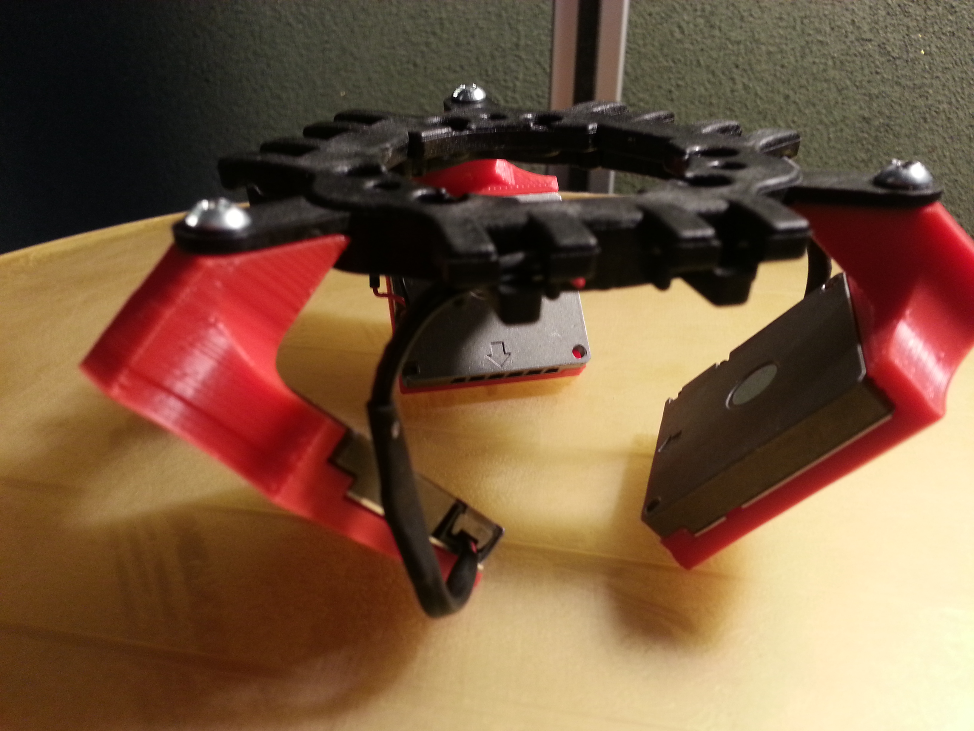

Just a quick & simple layer fan mount I'm trying. Looking for a solution that wouldn't interfere JFettig's enclosure. Inspiration came from the ATOM 2.0.
[img]http://i482.photobucket.com/albums/rr18 ... 133105.jpg[/img]
[img]http://i482.photobucket.com/albums/rr18 ... 133233.jpg[/img]
Panasonic Fan: http://www.mpja.com/5VDC-Mini-CPU-Fan/p ... 2166%20FN/
Fan Mount STL: http://repables.com/r/598#

Looks great! I've been thinking about something similar, but I might just like your design better :)
Why 5v though?
Re: New Layer Fan design.
Posted: Sun Jul 19, 2015 8:51 pm
by KAS
I haven't found a 12v version. I've been running one at 12v for about 3 weeks with no issues. That said, I have no idea on reliability.
With the 3 fans, I've been running it as 50% which is measuring 6v on the meter.

Nice find on the fan but I have a question on the mounting.
It looks like you are using zip ties to hold the fans, is this correct?
Posted: Mon Jul 20, 2015 12:42 pm
by KAS
Eaglezsoar wrote:Nice find on the fan but I have a question on the mounting.
I guess that picture is deceiving. I used the zip ties to hold the wire from the fan out of the way. Each mount is held in place with a 1/2" screw through the top of the effector.

by Eaglezsoar
Thanks for the better picture clearly showing the screws holding the mounts.

I'm gonna try this out. I'll need to modify it for the fans from seemecnc though, since I picked up 2 more of those. (wished I would have known about these panasonic ones for 4 bucks!) Quick question about your wiring. Did you solder them all to the same layer fan wire?

I went ahead and modified the file to fit the stock 30mm blower from Seeme. Here is the file in case anyone wants to give it a go. It's a nice fit.

I didn't have much printing time on the setup above as I switched my effector to the metal one at trick laser. I have to redesign the mount to match the different tabs on that effector.
50% on the fan speed gives the +6v to the fan although I've been running one at +12v for a few weeks without issue. Three fans at +12v is a crazy amount of air, if you have the angle off a tad you can over-cool the hotend and never reach printing temps.
