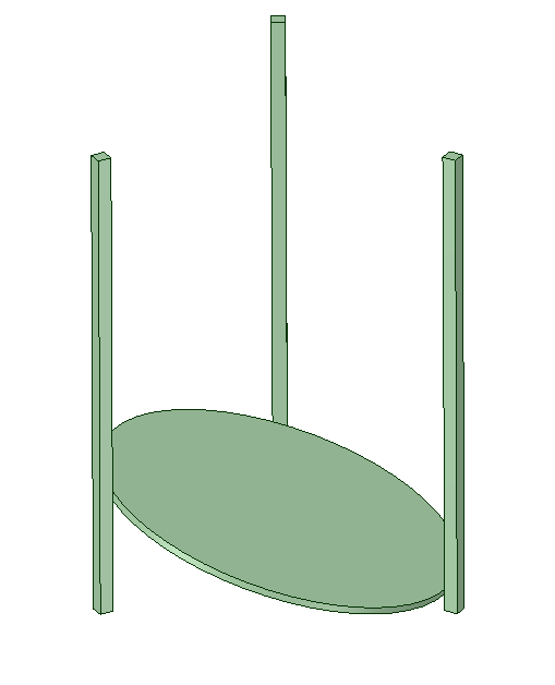

I don't suggest shimming because I think your build plate is warped. I suggest it because I think your build plate isn't level relative to your towers.

Can someone please tell me what eeprom adjustments to make in order to get this perfectly flat, unwarped build plate to print without high and low spots without shimming?
I don't care how flat your plate is, if it's not level relative to the towers, you're not going to get good prints out of it.

Dale Eason wrote:Isn't that what the leveling process is all about. You use the end stop screws to get the towers level with the bed.
That's a really good question actually, and I don't know the answer to be honest. But my guess is that the end stop screws only accomplish so much - perhaps they're more to compensate for the differences in the heights of the end stop switches.
Let's say - just for giggles - that we have a print bed angled at 45 degrees relative to the towers (this is impossibly extreme and no one in real life would ever have this). The center of the print (a.k.a. the centerline of the print bed) on the first layer would still be pretty close to the center of the 3 towers. However once you get to the 100th layer, the center of the print would be nowhere near the center of the towers. It would be skewed way off in the direction that the print bed was angled.
I don't think any endstop adjustment could make the effector somehow "know" about that gigantic offset and compensate as it traveled to higher and higher print layers.
Of course this is a purely theoretical example and not exactly the same issue, but my point is that I believe there is a limit to what endstop and eeprom tweaks can fix before mechanical adjustment becomes necessary.
