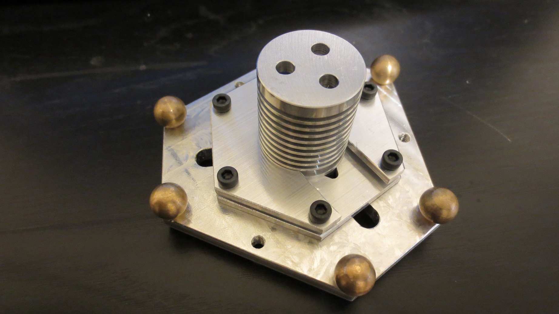

These are the balls I'm considering. They're 0.375 diameter with 8-32 tapped holes. They come in plain brass and nickel plated brass, shown next to a 3/8 chrome steel ball bearing for comparison.
Unfortunately the threaded balls are not perfect since they were made on an old automatic screw machine. They are round around their central axis, but distorted around the other axis. Sort of like how planets are slightly elliptical because of spinning. The plain brass ones are about 0.0015 to 0.002 shorter than they are wide, and the nickel plated brass ones have backlash flat marks that look to be caused by about 0.002 of backlash in the lathe that made them.
0.002 will show up as imperfections in printed parts because the balls mate to a cylindrical hole. The ball bearings don't have this problem because they are spherical to about a micron. The surface finish is perfect with the ball bearings, but I think it is still workable with the turned balls. The 0.500 CF arms have aluminum cups on them that rub on the ball surfaces, and I don't know how well aluminum on brass or aluminum on chrome steel will work. It feels rigid and it has low friction, which I want, but I want to know how long the arm cups will last with sphere-on-circle wear. I think the surface finish of the ball will matter a lot.

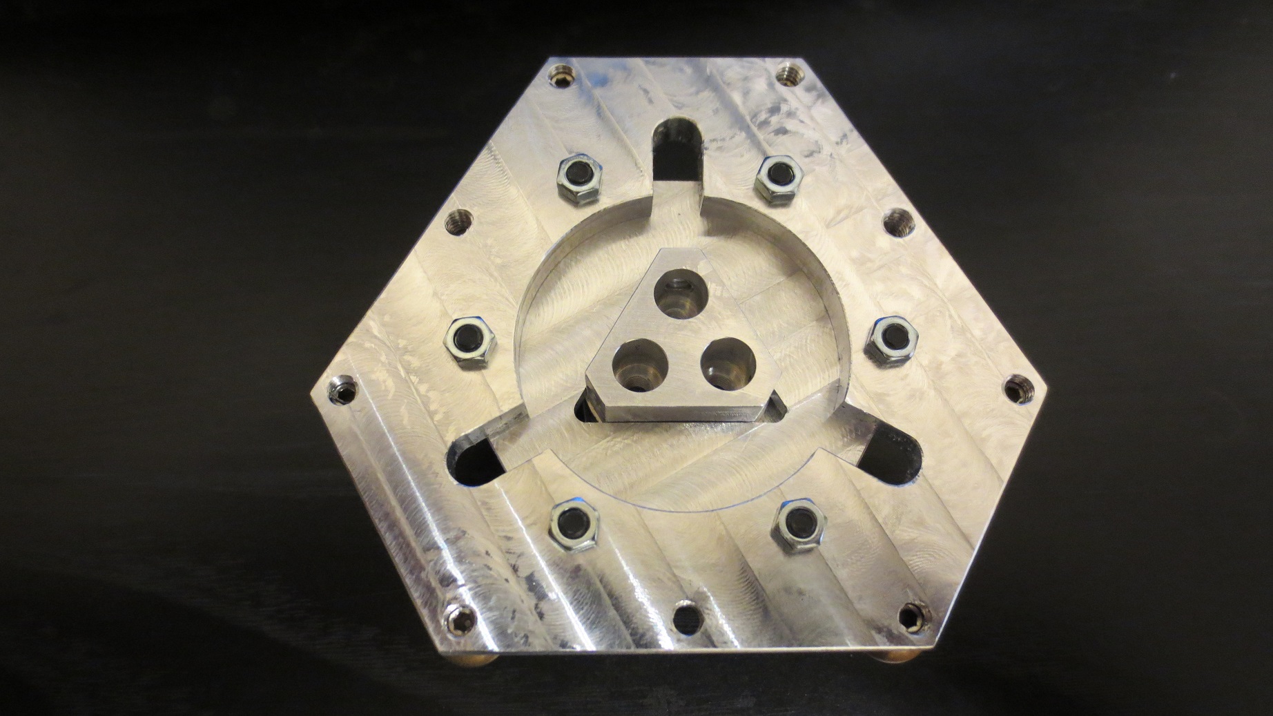

This is what the effector plate looks like mostly assembled. All of the parts are milled flat because 1/8" extruded aluminum bars are bowed. I wanted to make sure this part turned out perfect because the hotend and effector set up is critical to print performance. This thing is as rigid as it gets, and the hotend is perfectly level to the effector.

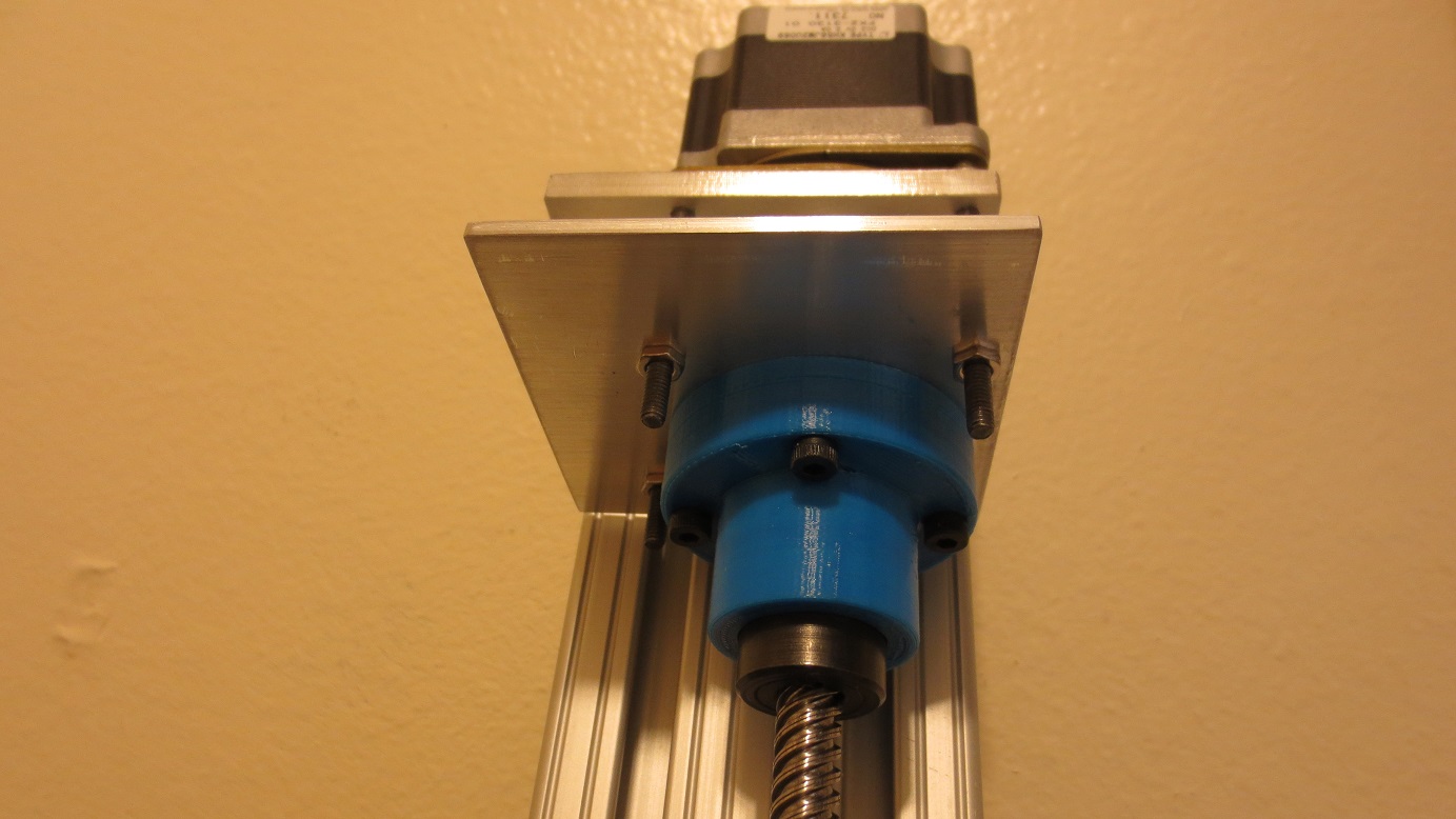

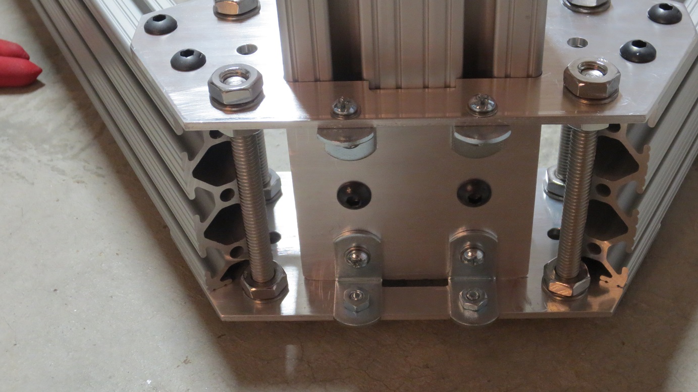

This is what the printer looks like half-assembled next to my Rostock Max V1.
This is a close up of a tower.
Notice that it uses a NEMA 23 stepper with a damper. It is all bolted together with 0.25" (6.35mm) thick alum plates for structural strength and rigidity.
The motor shaft is coupled to a 3/8th inch fast travel lead screw with 1/2 inch of travel per revolution. This means each full step moves the linear carriage 0.0025".
The lead screw is axially rigid but can pivot in pitch and yaw several degrees to prevent off-axis wobbling. It is held together with shaft collars and two preloaded ball bearings in a spindle, with silicone square O rings as spacers that absorb vibration and allow the radial angling. It helps that the linear carriage is ultra rigid.
Since I went with a lead screw instead of a belt drive, I had to take backlash into account. My goal was absolutely zero backlash since this printer needs to be precise. I reached the goal with the nuts shown below;
I already printed a bunch of these with different variations. Material is trimmer line nylon. I call them "Creep-Preload Nuts" because they are initially tight with high friction, but after several days of being on the lead screw they lose nearly all of the friction but keep their zero backlash properties. I measured with a dial indicator and I saw no backlash whatsoever, although I can only be certain to within 0.0002" because the dial indicator is only that accurate.
The nuts turned out much better than I expected, and I'm going to use them on any CNC machines I build in the future.
I'll try to get a video up next weekend once I get stuff moving.

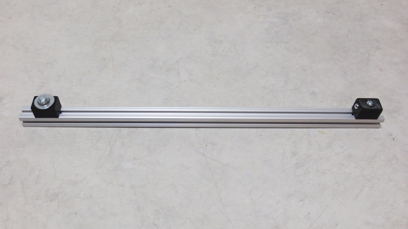

I had to make a jig to ensure that all of the delta arms are exactly the same length.
I don't have any saws so I can't cut my 0.5 inch CF tubes to equal length. The aluminum ball sockets on each end of each CF tube can slide a bit, and have close concentric tolerances with the CF tubes. They are locked in place with set screws.
The jig consists of two printed parts on a 24 inch long T slot extrusion. The black block on the right has a 3/8 socket with a 3/8 chrome steel ball glued into it. The left black block is flat except for a small detent pit to accurately position a 3/8 ball.
The CF tube with the aluminum ends is placed so the right socket mates with the 3/8 ball on the black jig block, then the other end is positioned with a 3/8 ball in the socket into the left side detent. The left side aluminum end slides to the left until it is pressing the 3/8 ball into the detent, then the set screws are locked. All six delta arms are calibrated this way.
So long as the room temperature is kept within a +- 1 degree Celsius range, the arms will all be equivalent in length to within 1 thousandth of an inch over a 500mm span. I can't think of any way to get more accurate than this without metrology measurement machines.
A delta printer will work pretty well so long as the arms are consistent in length to within about 4 thousandths of an inch; any more will tilt the effector near the edges of the build plate. The black blocks on my jig are printed with PETG.

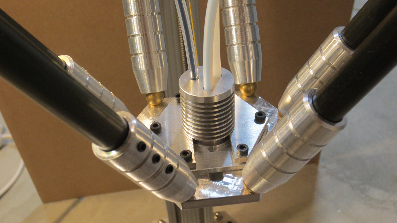

by Heffa
This looks awesome!
I really like the Tri Hotend effector - any chance you would be willing to share the source for that? It looks to be exactly what I was planning to build for my own large Delta

by stonewater
thetri hot end is a polystroooder
http://www.polystroooder.com ..... they have some pretty awesome engineering inside of them!

by Heffa
Thanks, I know about the Polystrooder and am thinking about using one myself.
I was interesting in the aluminium effector platform for the hotend - it didn't look like the one at Youmagine from Generic Default

The hotend mount is made from machined aluminum extrusions. I do plan on making them to sell later this year. I'll get a picture of the whole setup pretty soon, it's pretty cool looking.
The Youmagine one is meant to be printable and easy to work with. Most people don't have CNC mills or waterjets at their disposal. I'll try to get the gcode and CAD files for the mount shown on this thread if I can recover the data from my old computer, otherwise I'll have to remake that stuff.

Care to explain a bit more on the anti-backlash nuts? Is the helix different along the length of the nut or is there no backlash due to the tight fit?
Re: A Big, Rigid Delta (Picture heavy)
Posted: Fri Aug 21, 2015 10:03 pm
by Generic Default
They're just plain nuts, the helix is constant and matches the fast travel acme profile. Screws are never perfect, if you take a long enough nut and try to put a threaded rod through it, it will bind. The nuts on this printer are close in tolerances to the screw and they're just long enough so that they take up all of the backlash without adding too much preload from binding.
They run dry, and since it's flexible nylon on burnished steel, there is very low wear and very low friction. It's much stiffer than belts but it's a bit more complicated to make.

So to Make sure I'm understanding this. You used the slight variations in the thread as a feature rather than a con by matching it with the more consistent nylon thread? Meaning that at least some part of the Nylon is firmly gripped and therefore backlash free? I know it's a probably a simple concept, but i like to really spell everything out when it comes to mechanical stuff.
Posted: Sat Aug 22, 2015 2:21 pm
by Generic Default
Yep, the flexing of the material is what allows the backlash to be taken up. This trimmer line nylon has a modulus of about 1 gpa, normal steel nuts have a modulus of about 200. I was unsure if the design would work until I tested it with a dial indicator. With small nema 23 steppers, it can still drive the axis pretty fast with high acceleration. My next test will be on a more rigid lathe setup; I know the backlash is near zero but I want to check the static and dynamic stiffness under bigger loads.
Posted: Tue Aug 25, 2015 1:41 pm
by Jrjones
Ah, that makes sense. Bonus that you don't need to lubricate nylon either.

I finally mounted one of my Tri hotends on the effector. Looks awesome. I wish I had more than 2 minutes a week to work on this thing, though!
