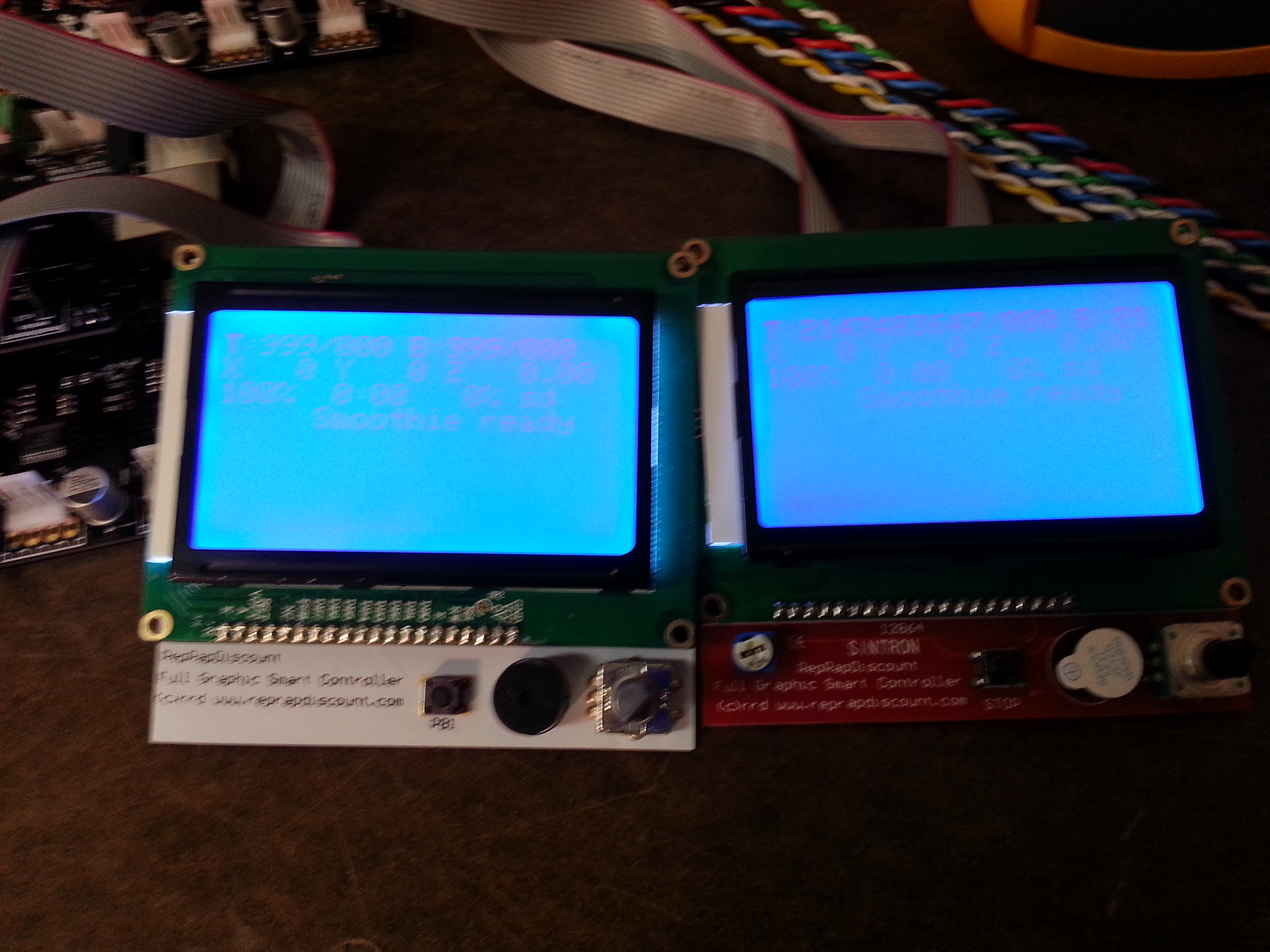

Would someone mind taking a picture of their GLCD turned on? Mine have pretty bad contrast, and I've adjusted them both to the highest setting with the trim pot.

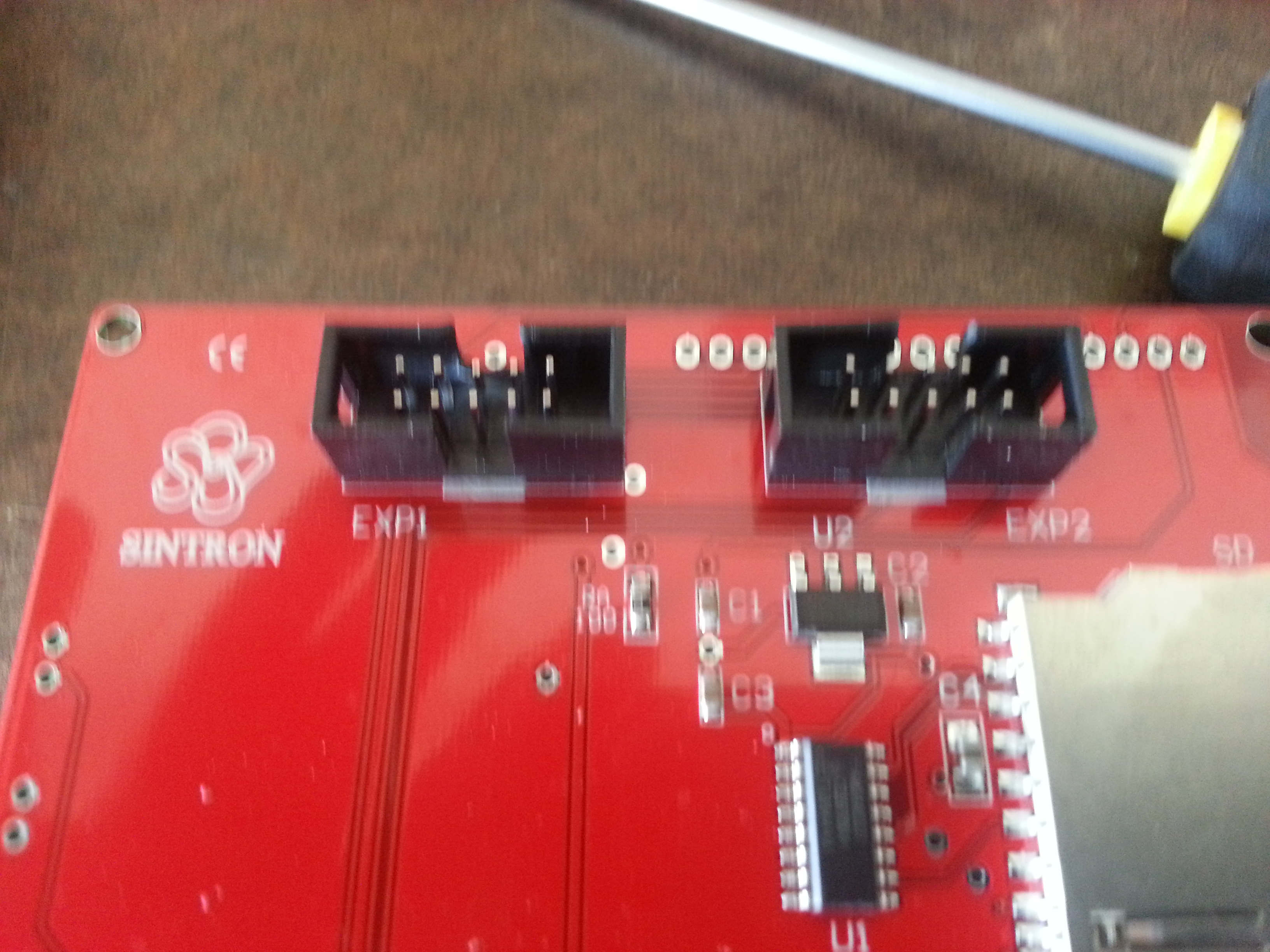

Also, I did get the non-official GLCD from Amazon working. It appears the official GLCD exp1/exp2 has the pin-out reversed on the header. I just cut notches in the fake GLCD header and flipped the cables 180 to get it working.

Are you using the 0.5 or 1.0amp voltage regulator? That panel will have poor contrast if you use the 0.5.

It's the 1.0 amp version on both boards. I also tried it with and without the dedicated 5v next to the VBB with no change. It's not as bad as it looks on camera, but it's not even close to the LCD on the Rostock Max. So I wasn't sure if that's just the nature of the GLCD in general or what.

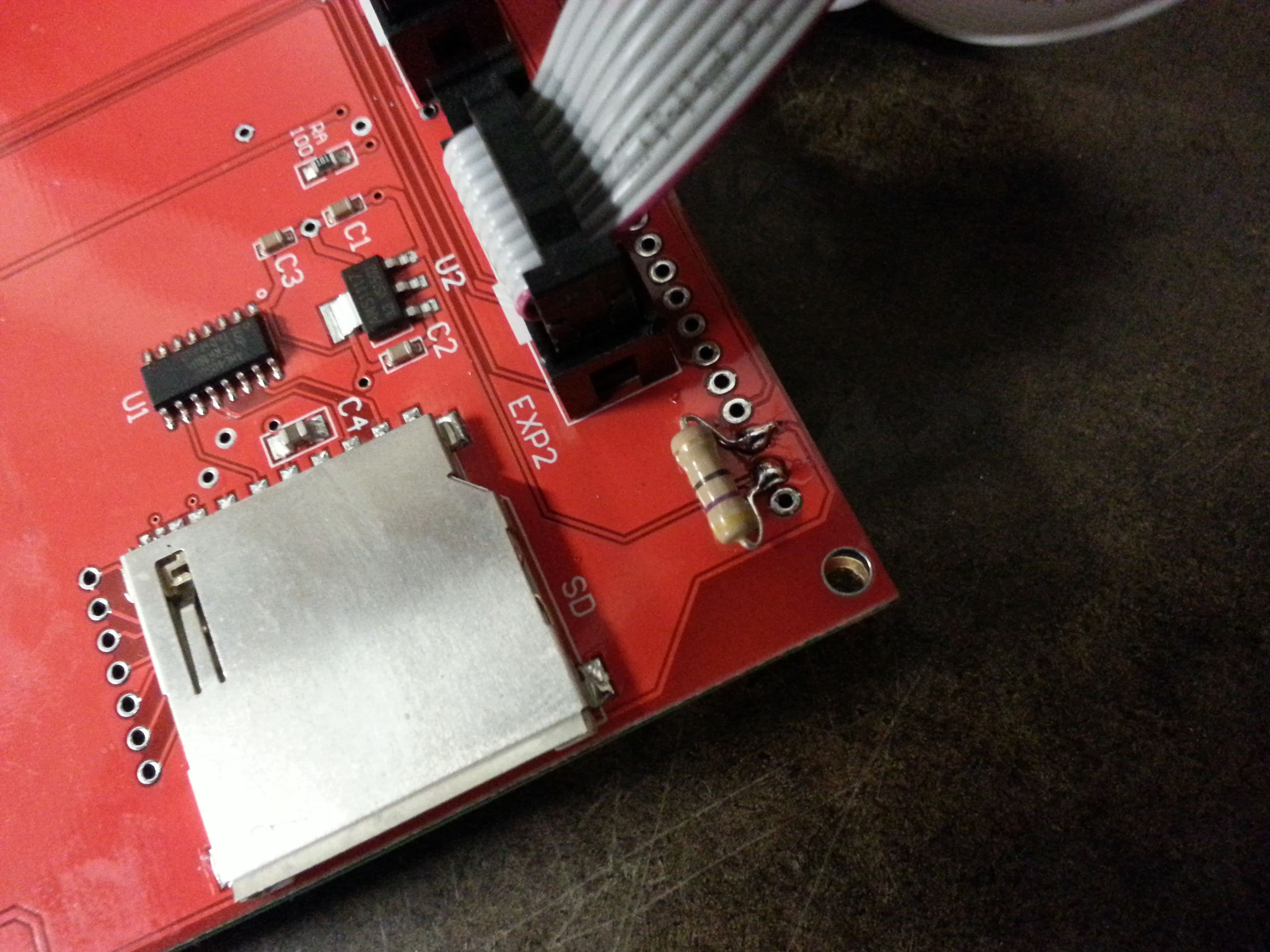

So the official RepRapDiscount Full Graphic Smart Controller, has the pot between the boards. A screwdriver wasn't cutting it so I used mini pliers to turn the contrast up. Felt like a detent or click when turning, maybe 1/4 turn clockwise at most.
The clone GLCD needed a little resistance on the pot trace. 1k ohm was a little better, just kept trying different ones until I ended up at 47ohm.

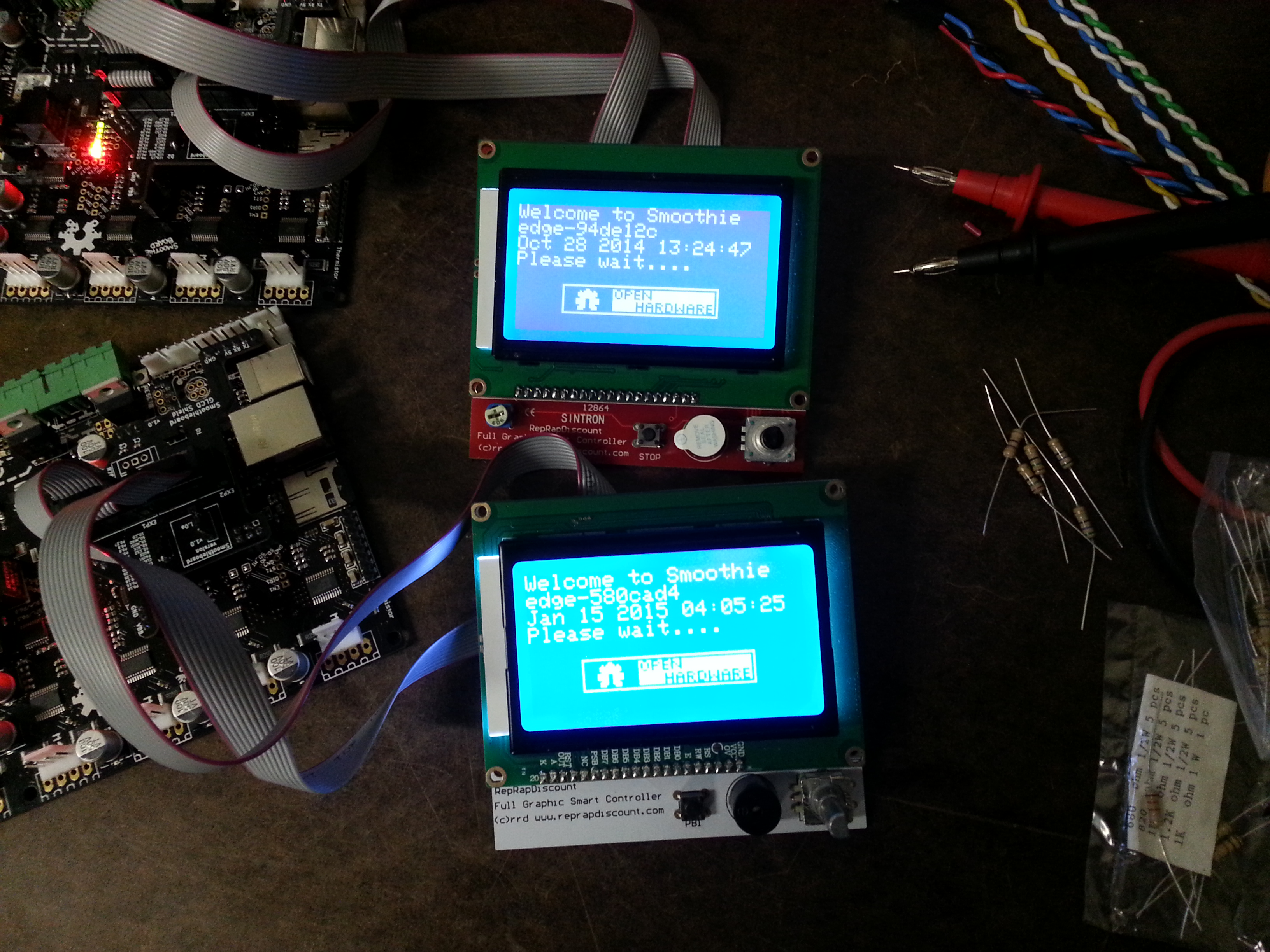

I just got mine working....yippie!
and it's fine, didn't have to touch a thing. It's hard to take a good photo, it actually looks 10 times better than this...
I have the 1.0amp on the smoothie and the 0.5amp regulator on the adapter board.

I only have the 1 amp on the smoothieboard and nothing on the GLCD adapter. It works fine on mine, even with just USB power.
If you hook up the 5v connection, you don't need any regulators at all.
