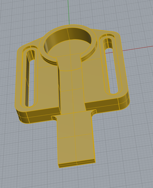

I designed some mounts with the "pad" and holder for the FSR for my mini kossel. It has a Smoothie and i want to try 626Pilots' code. I'm using the FSR Endstop Controller, that really makes it a lot easier and the LED green/red feedback for each FSR is nice. I got it all hooked up to test and it seems to be working well.
You'll notice the pad is trlobal, that makes it a lot easier to get a good sliding fit without slop. The triangular bases can can be moved in/out to adjust the radius for the pads to fit into the holders. This worked really well. I have an Orion heated bed and snowflake insulator that overhangs the kossel base.

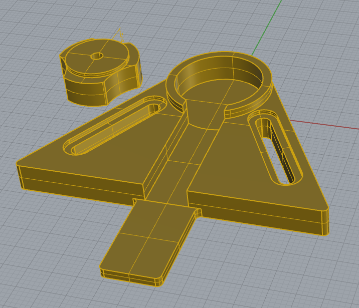

Re: FSR Musings
Take a look at the STL file I posted about an hour ago in your HA thread. It will screw to the top melamine plate with 2 screws - 1 in each slot. This allows the FSR position to be tweaked so they do not bind. This worked well on the kossel mount I made and this new mount can be used on kossels, rostocks or any printer really.

I might modify the mount to clamp to the towers. I don't know if the screw holes are all the same across revisions. Mine look a little different from others I've seen.
Re: FSR Musings
Not sure what you mean by screw holes? I am going to be drilling new holes to attach these to the top melamine plate with some self-tapping screws.
I'm happy to send source files if you'd like. These are Rhino but I could export in most anything.
626Pilot
Posts: 1716
Re: FSR Musings
Post by 626Pilot »
I don't want to drill through lexan. :) If you can export as STL, that's all I need. Thanks!
