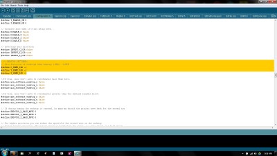

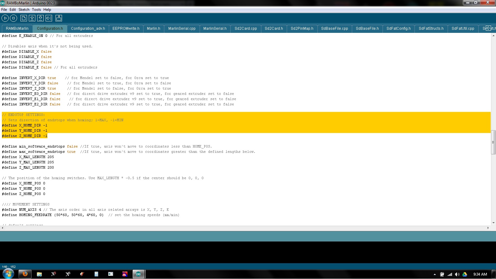

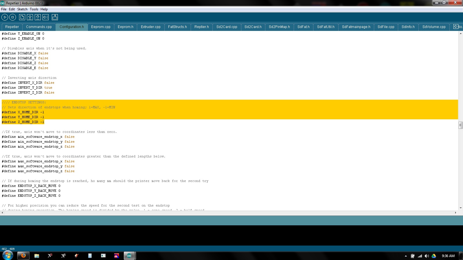

jasco, John here. which firmware are you running? Marlin, Sprinter, Repetier? I've included a screenshot of
Marlin
And Repetier
The configuration.h files are where you need to make those changes. Don't be afraid to hack away at the firmware, you learn most by breaking stuff!

I'm Using Sprinter currently. I tried Marlin, but had the same problem.
Yeah I changed the z to 1 from -1, but the behavior seems to be the same either way I set it. Triggering the endstop only stops movement when moving in the negative direction. If travel in the positive direction, triggering the endstop doesn't do anything.
The endstop trigger is being registered. Using Pronsole I can send M119 and see that endstop status changes when I manually trigger it.
If I use the endstop to the max position do I still plug it into the min pins on the board or use the max. If I use the max pins the endstop doesn't currently do anything when triggered.
Do I set the max length for Z to be a negative value?

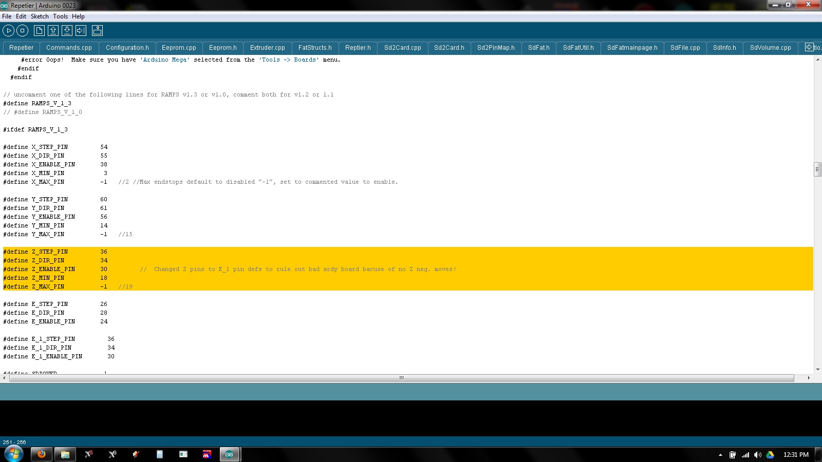

Just had a moment! Take a look at the attached pic, and see the #define_Z_max_pin, by default it is set to -1 or disabled. If you are using a Z limit at the top, try enabling that pin (looks like pin 19 on a RAMPS 1.4 setup) and try that. The board may not be recognizing that there is a max (positive) limit/home switch, and that could be causing the problems!
I also added a zip file of the repetier fw i'm running, notice the pins.h have been modded, so you might want to use your pins.h file

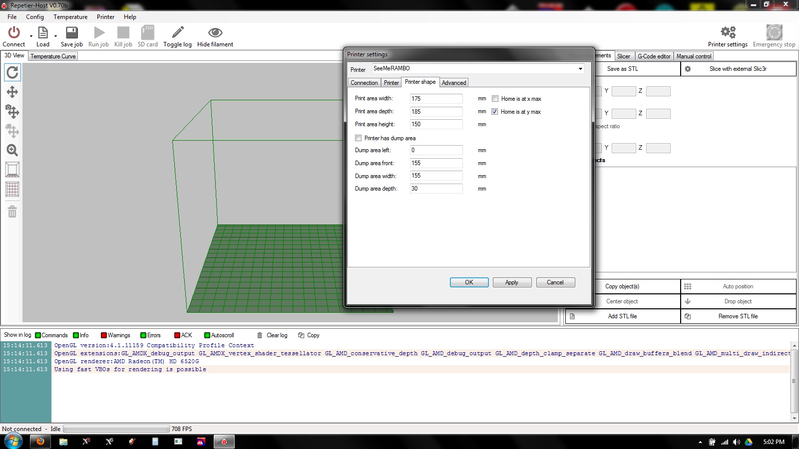

Last problem I have is with repetier. when I home in repetier it goes through the proper routine, but the software shows the home position for Z as 0. If I send M114 the board does say that my position for Z (at home) is 150.5. So the board knows where it is, but repetier thinks it is at zero. If I manually send G-code The Z-axis moves to the correct position, but I can't get repetier to display the correct z axis value. I think it should print correctly since printing runs off G-code and not where the software thinks it is.
Looked all over and couldn't find an option to configure the endstop position in repetier. Any Ideas on that one?
Pronterface works fine, but it doesn't display positions unless you send M114 so it seems to work entirely off the board.
Re: endstop mounting
I just looked at repetier, and see there are boxes to check for x and y at "max" positions, I'm emailing him to see about adding Z to that as well. That's why repetier is showing Z=0.00
Yup, saw that. Not sure why there isn't a check box for Z. Maybe in an upgrade. I did do a dry run just now and the homing and return to zero work as they should during printing. It is just the software display that is wrong.
