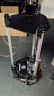

Post by predawnsky »

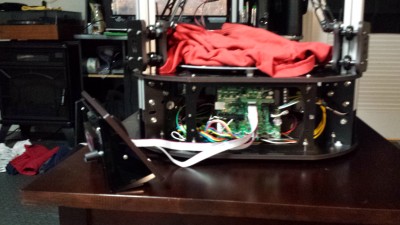

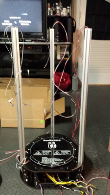

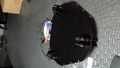

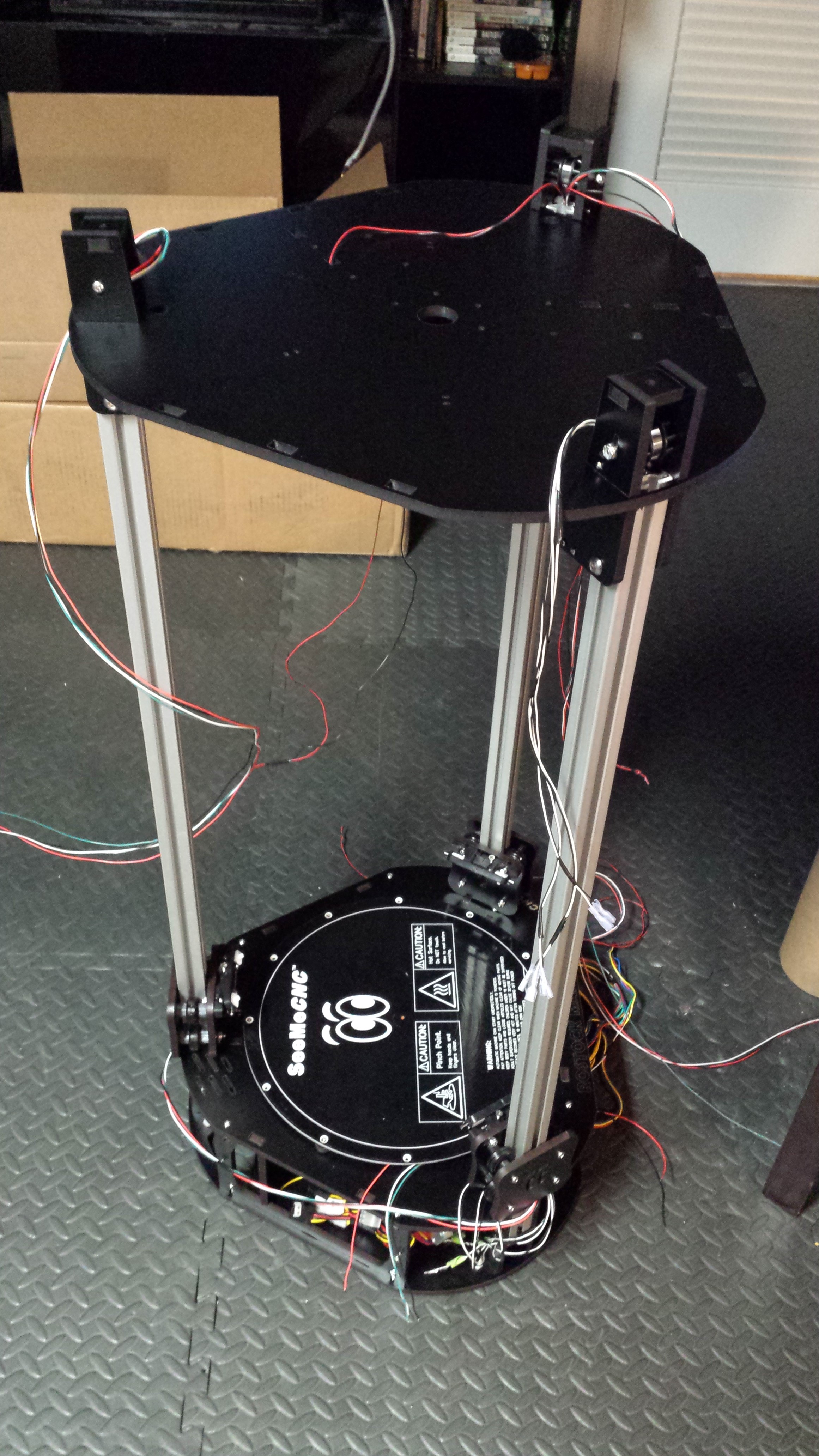

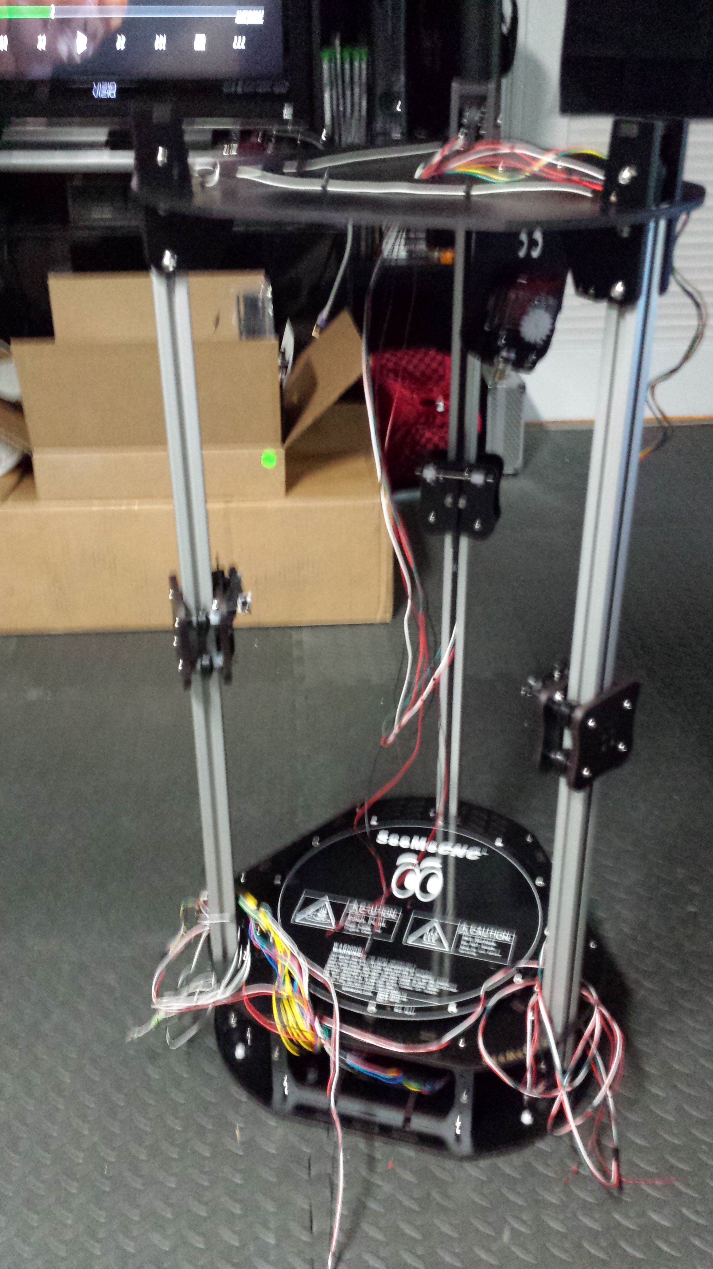

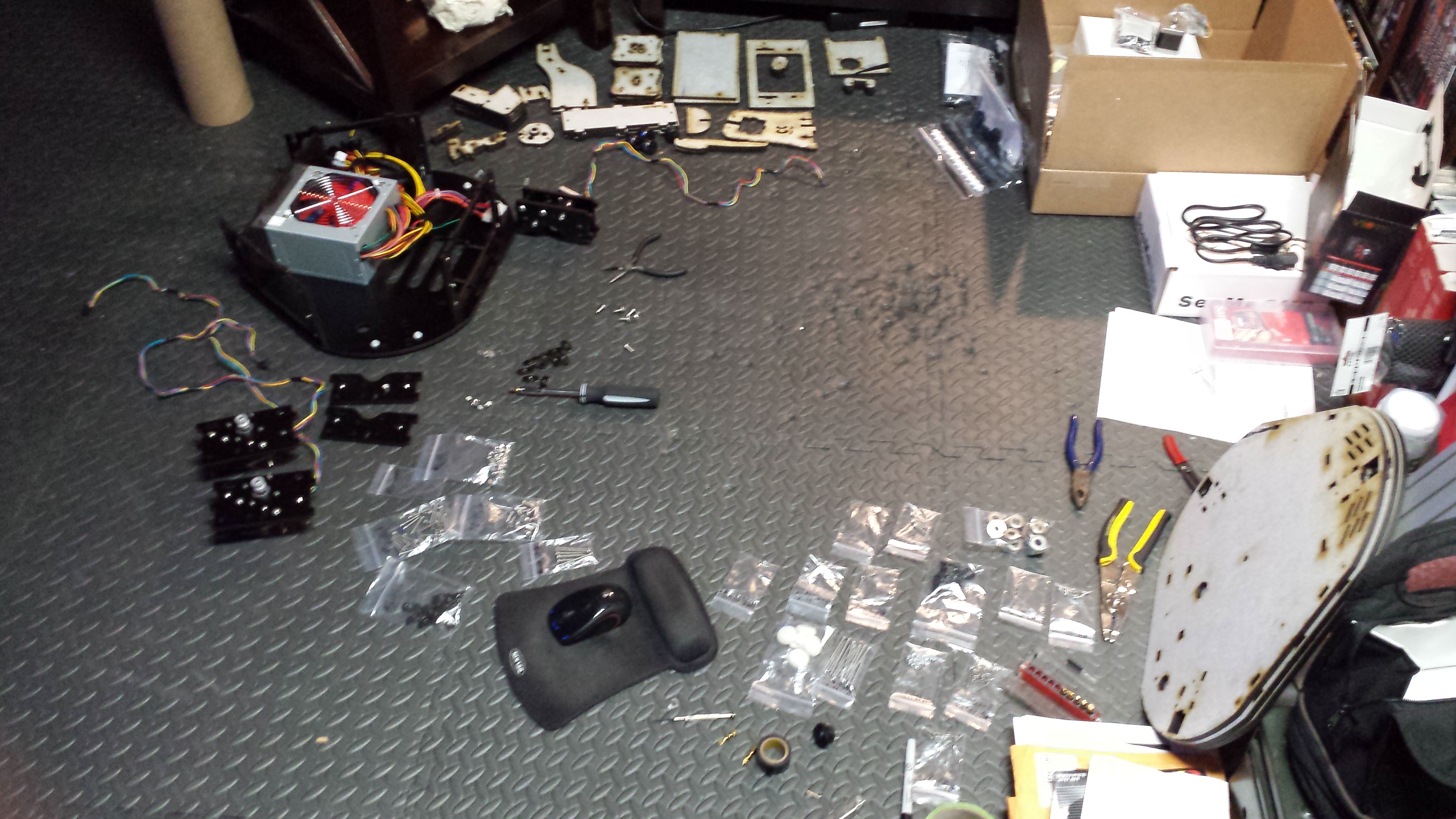

I got myself a rostock max v2 from seemecnc, ill post pics of the build, the upgrades, the prints both good and bad
predawnsky
Posts: 169
Joined: Sun Oct 05, 2014 8:11 pm

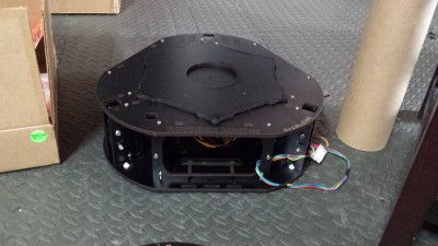

Re: my first 3d printer

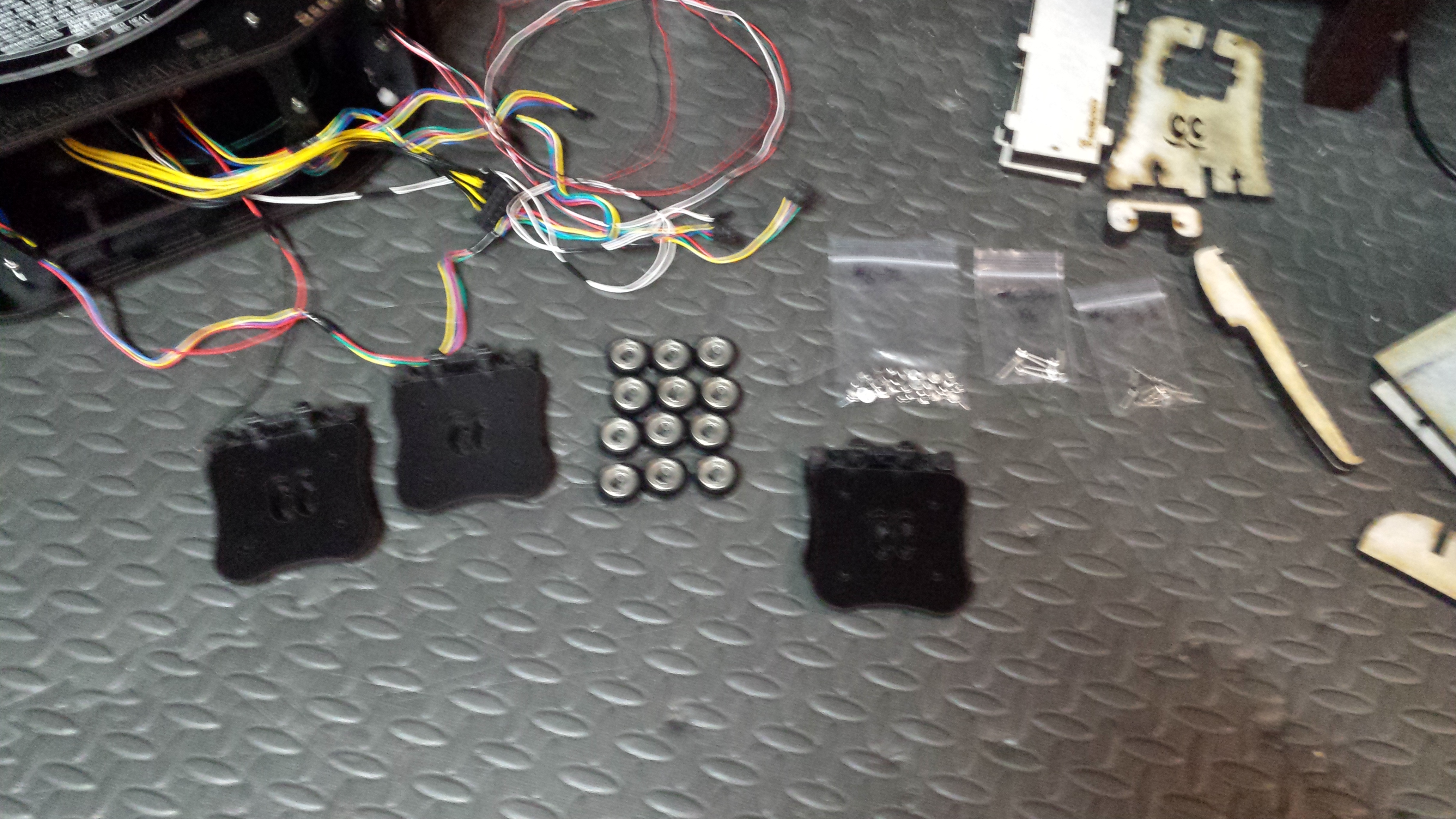

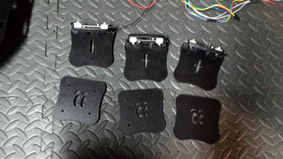

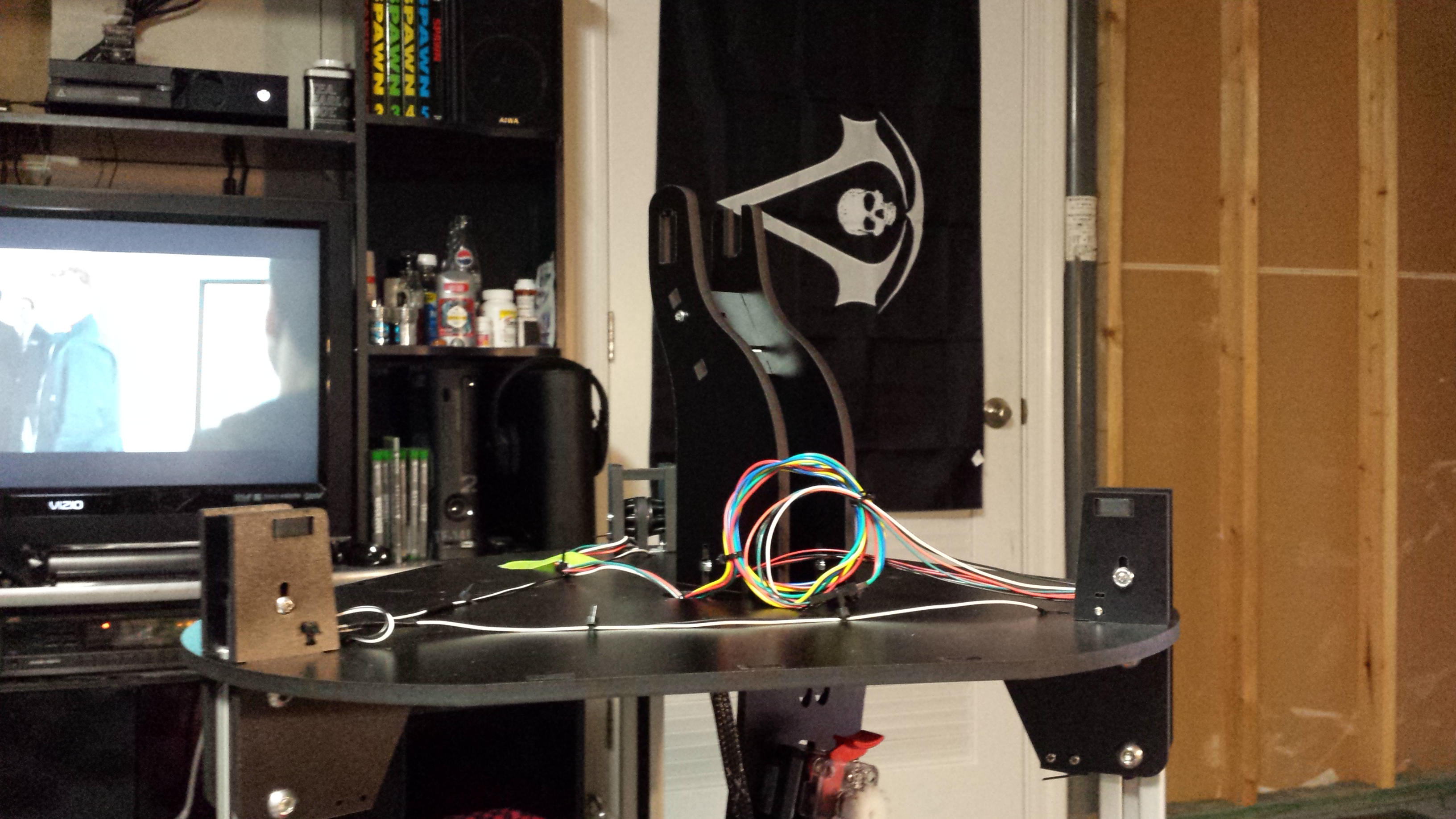

more of the build

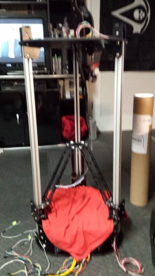

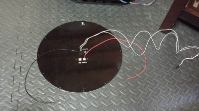

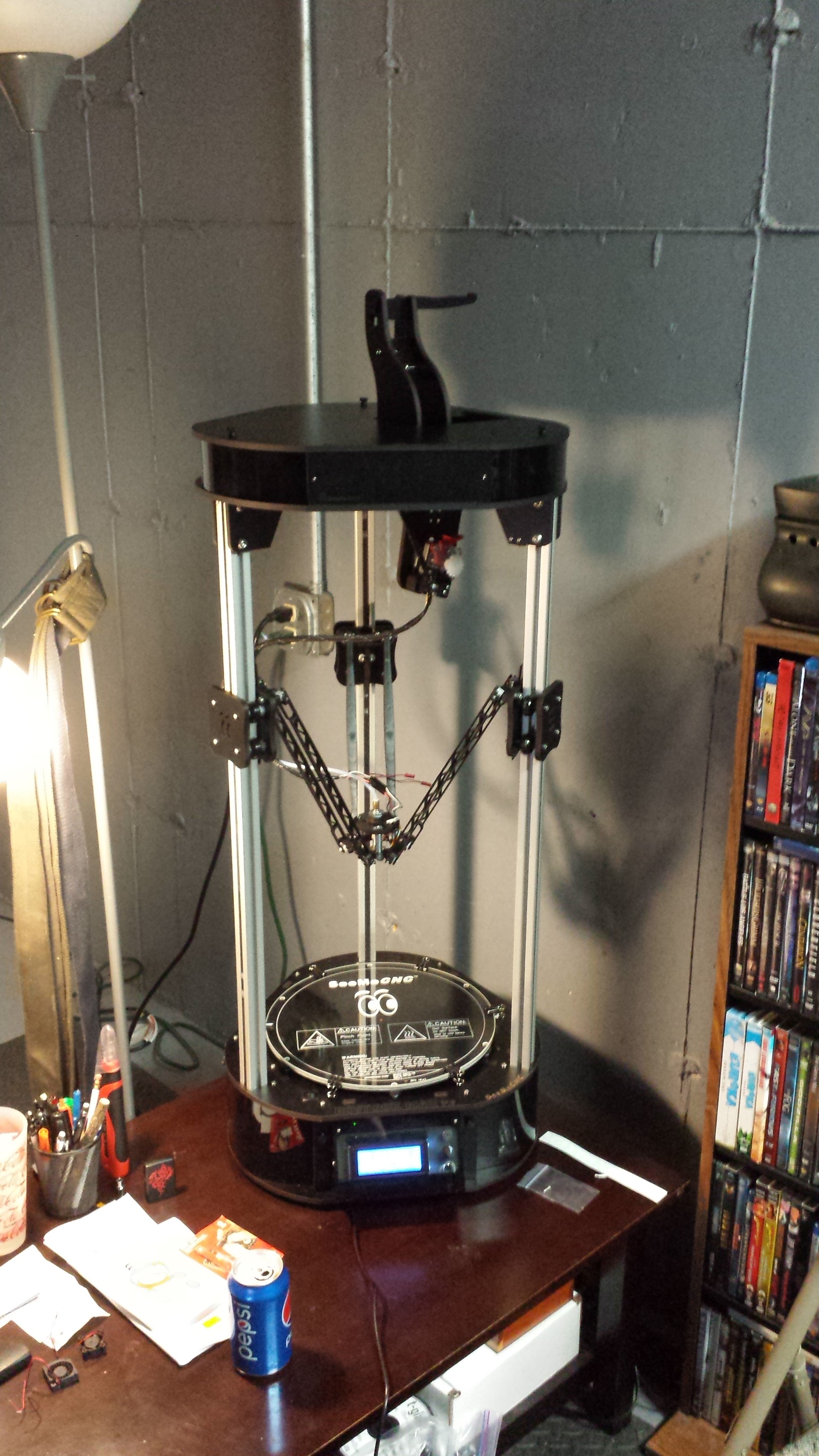

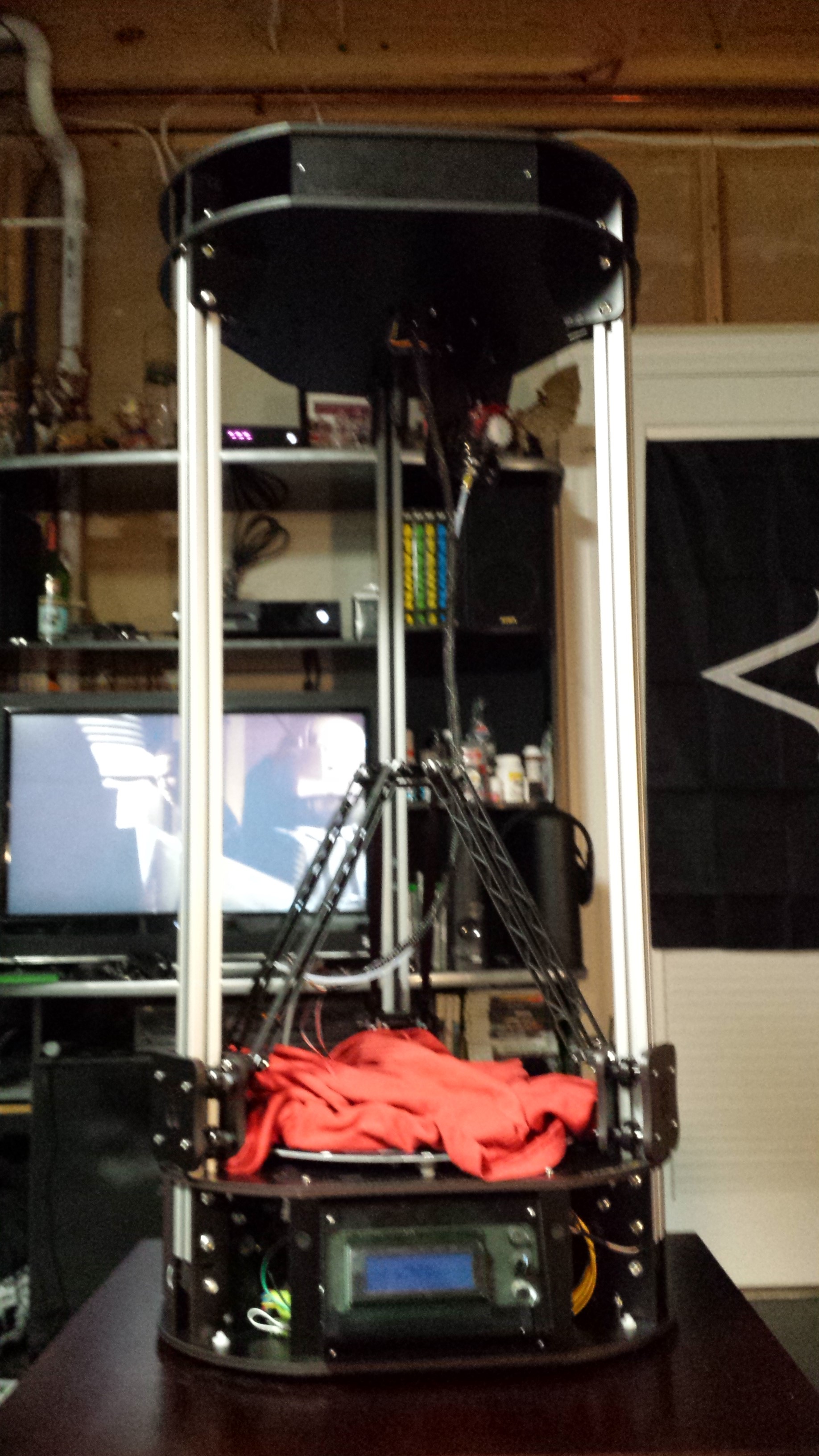

and the finale look

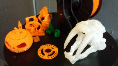

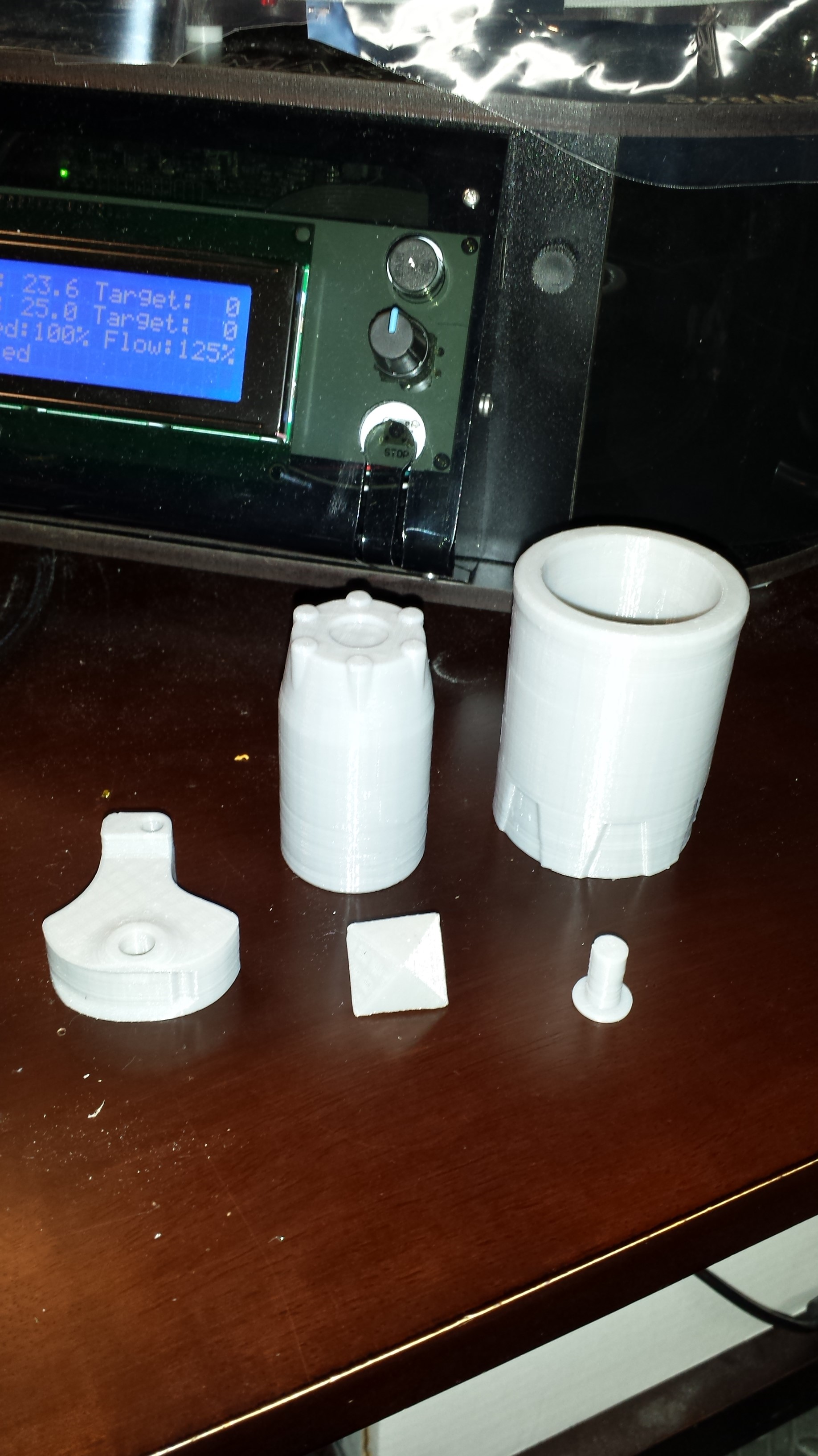

some of the thing I printed

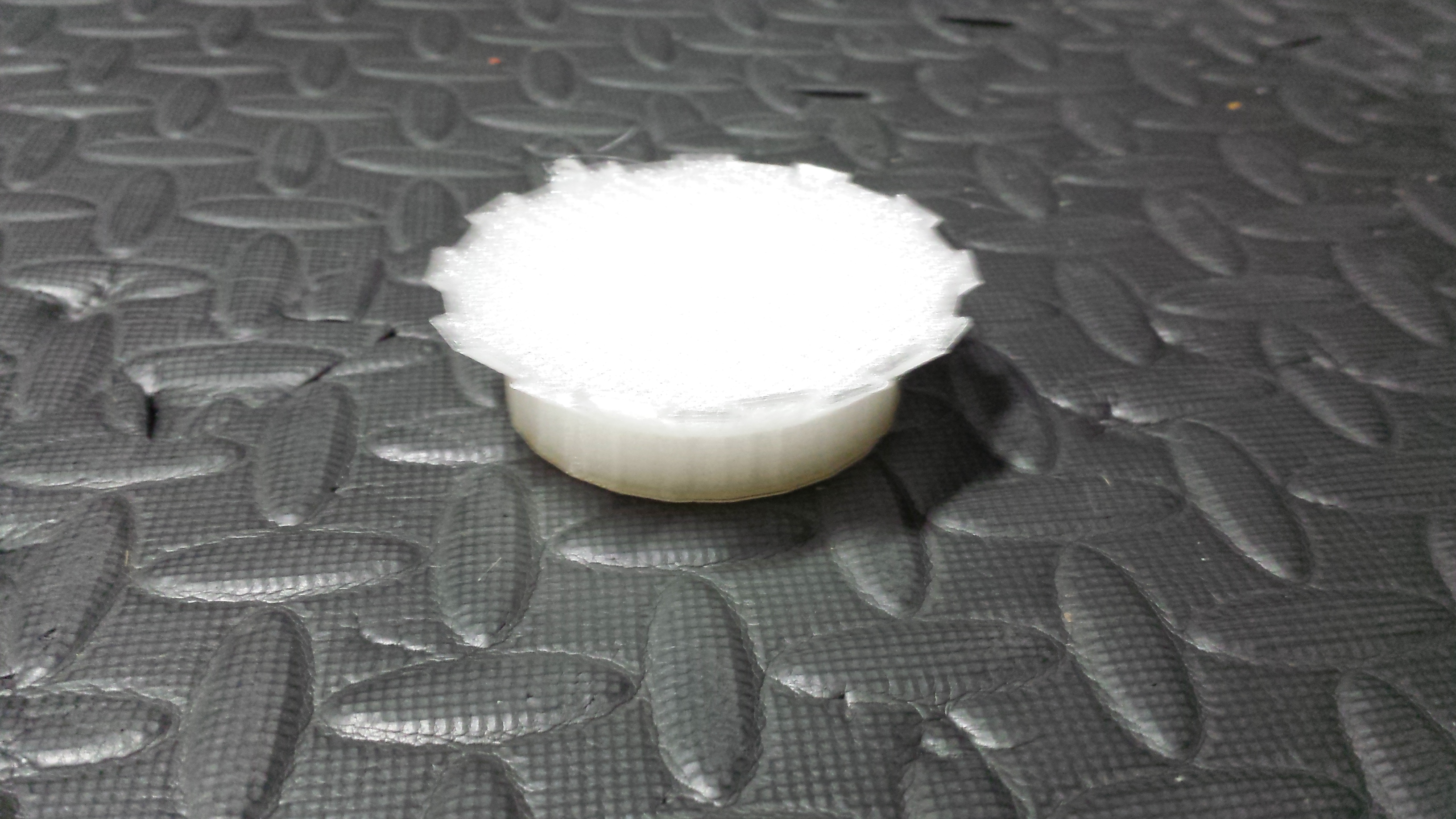

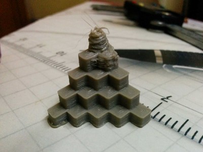

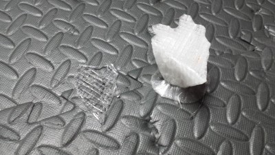

some of my failures
Looks good so far. Welcome to the forum!

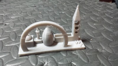

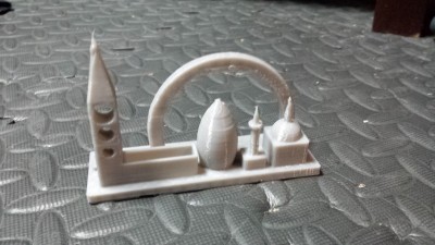

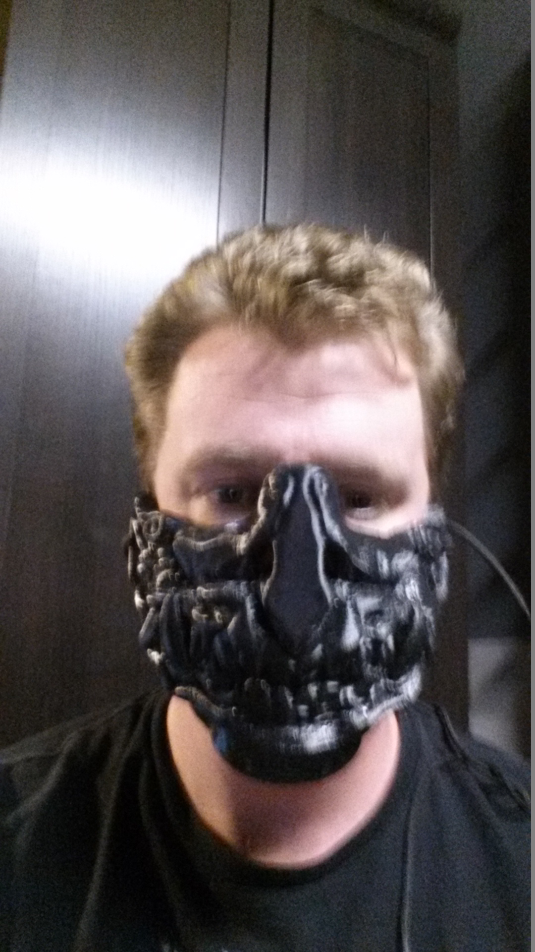

London skyline print

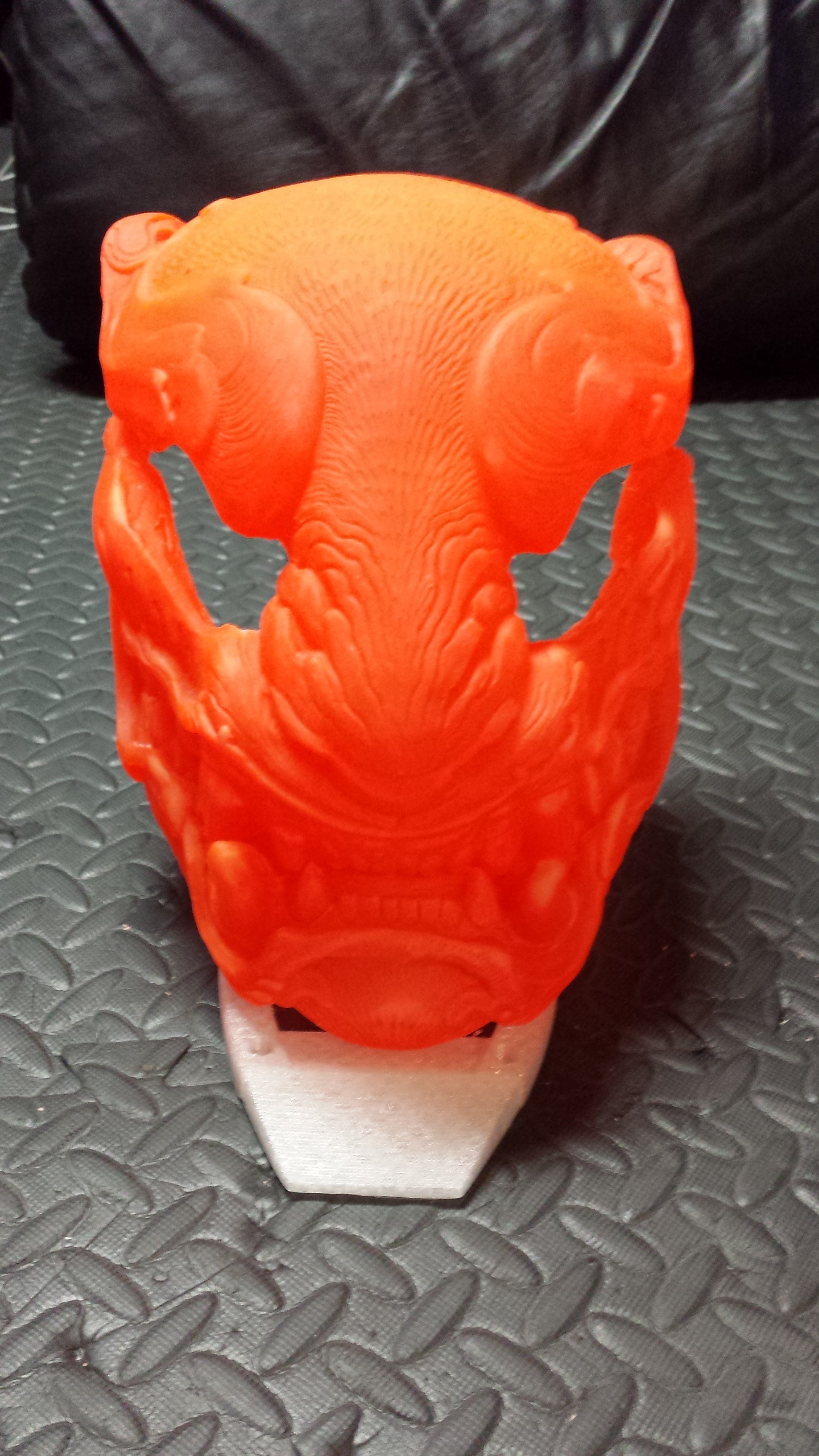

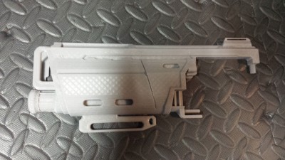

the beginning of a semi large prop
teoman
Posts: 1770
Post by teoman »
Very nice looking prints.
Are they ABS or PLA?

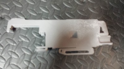

predawnsky
Posts: 169

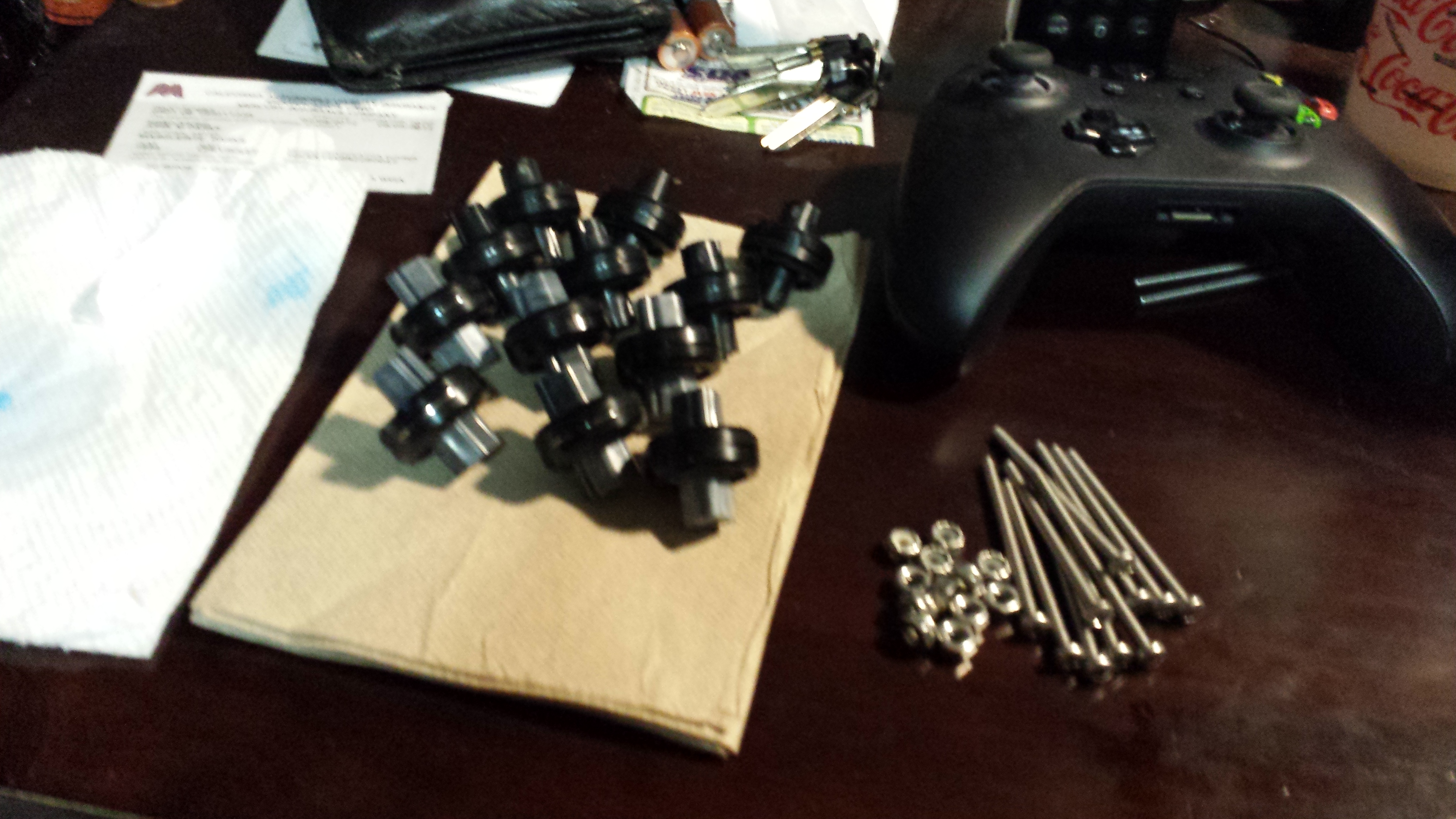

heres another part of my build, can anyone guess what im making
predawnsky
Posts: 169
teoman wrote:Very nice looking prints.
the gray prints are pla

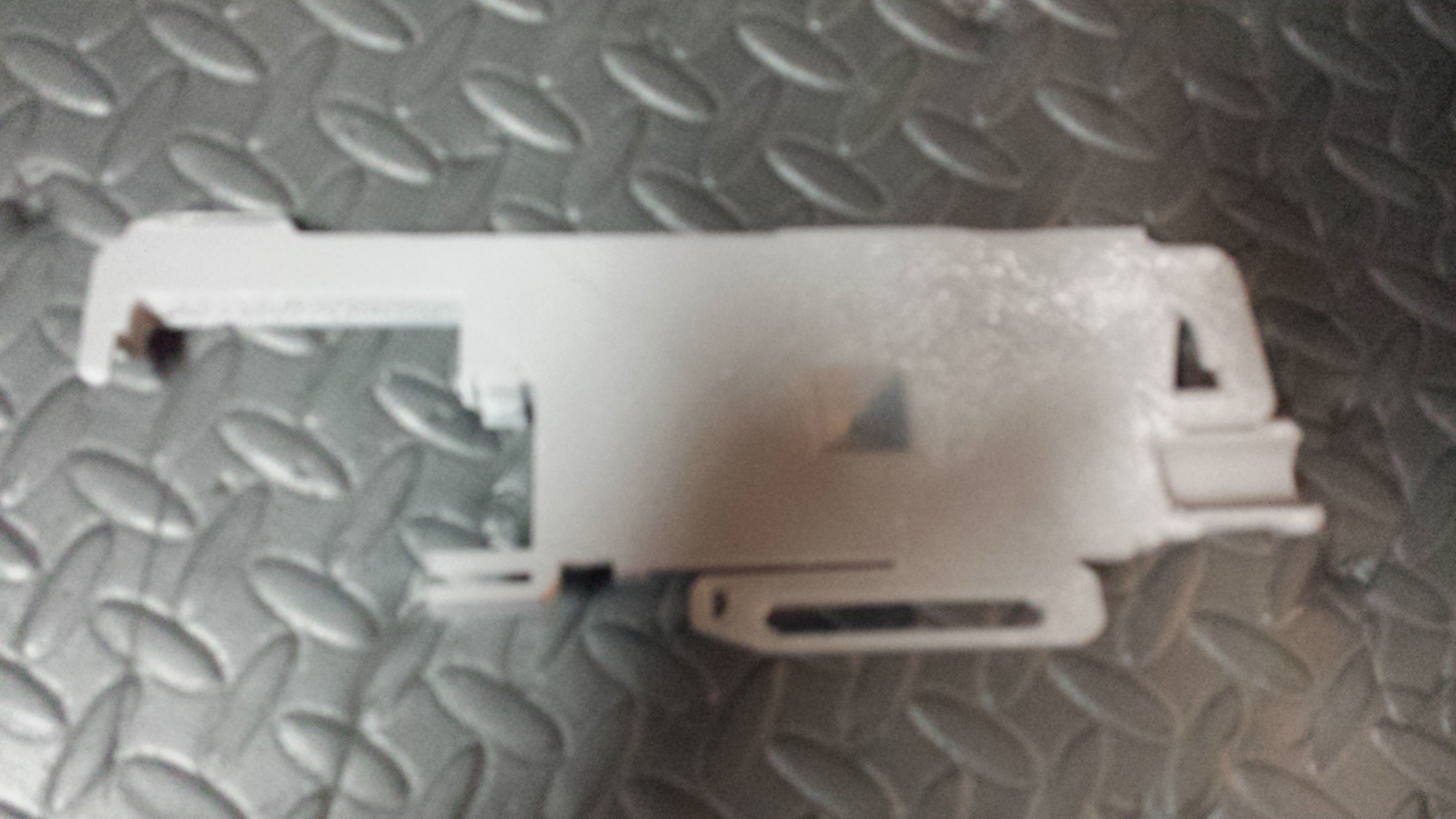

Post by McSlappy »
Looking great! Did you model this?

Post by Tinyhead »
I'm probably completely wrong, but are the prints from a pistol from a game or something? It looked like a sight on top.
I agree, very nice first prints. Those 'failures' aren't too bad either.

Looks like some pretty big gun to me. I thought it might be Deadpool's gun based on your profile picture, but he's got handguns that look nothing like that.
McSlappy wrote:Looking great! Did you model this?
No I wish I had that much skill I got the file from my mini factory
Tinyhead wrote:I'm probably completely wrong, but are the prints from a pistol from a game or something? It looked like a sight on top.
Yeah the gun is from destiny

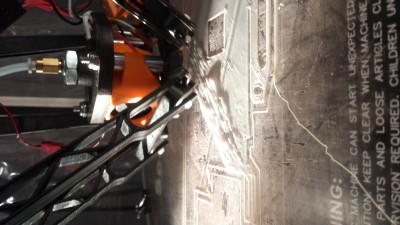

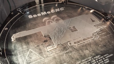

looks like im not getting adhesion
Tinyhead
Posts: 439
Location: Ontario, Canada
Post by Tinyhead »
Looks to me like you need to be closer to the bed.
predawnsky
Posts: 169
you think so?
Tinyhead
Posts: 439
Post by Tinyhead »
For a first layer, those lines are looking pretty round. Personally I would drop it a bit.
lightninjay
Posts: 288
Location: Tampa, Florida
Post by lightninjay »
Agreed; the closer you can get to the bed without smooshing the nozzle so hard into it that you don't get ANYthing coming out, the better. It gives you nice solid adhesion and a pretty glossy bottom where the filament was pressed to the glass.

lightninjay wrote:Agreed; the closer you can get to the bed without smooshing the nozzle so hard into it that you don't get ANYthing coming out, the better. It gives you nice solid adhesion and a pretty glossy bottom where the filament was pressed to the glass.
thanks guys I recalibrated the printer, and it seems to be working good now
