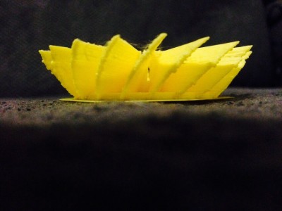

ABS with too low a temperature at the hotend, 215 was not enough... 230 and it is fine!
Supposed to be the start of a vase!

Isn't it fun to come up with correct printing temperatures, alignment problems, etc.
We have to love our Rostocks!

I have the same print, in the same color, failed in a similar manner. But I got about 1 cm higher than you :)
But Basturgach prevailed in the end.
