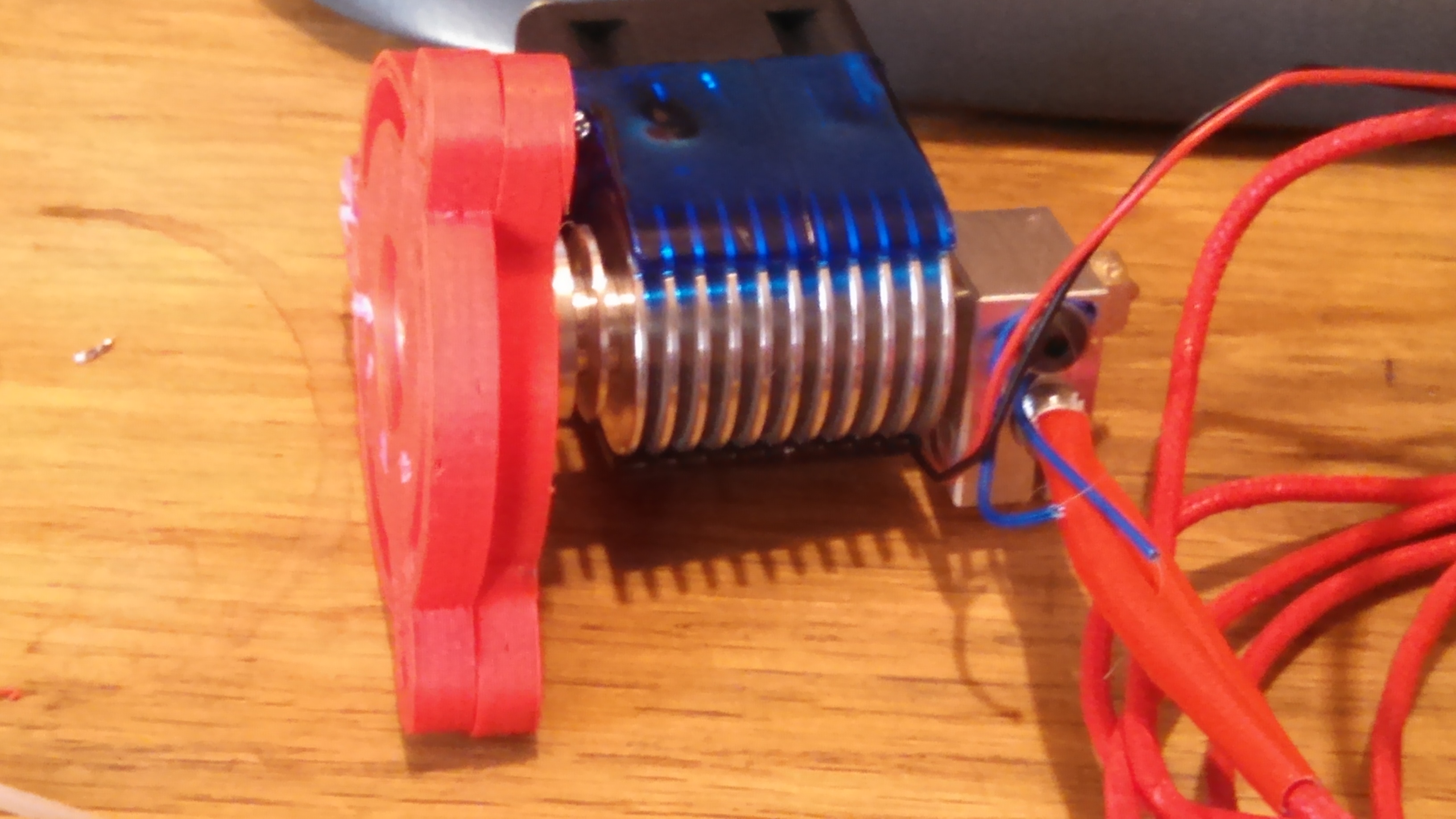

Hello,
I went to Thingiverse, and found a mount, I liked it but, it was for E3D's V5, which is bigger. The smaller profile of the newer V6 print head, doesn't fit in the printed mount. So, I changed it, and exported as a STL file, and slic3r just got done with it. The tolerances of the V5 mount, would have the nozzle up inside the carriage by so much, the plastic would have to drop down to the print plate. I made some measurements and found that it would be perfect, if I just used the old aluminum stand-offs, and just got some longer bolts, keeping the phillips head screw down and the bolt on top. But, I found I could pinch the cool end of the hot end with two pieces of plastic and hold it securely in place. So, here's the STL files if you want them. Making other adjustments, to accommodate their thermistor, or just using the one the came with the printer originally can solve that problem. Solving it, has another side to it as well. You can clear the Rambo's EEPROM, and fix the Configure.h file, and reload it with the thermistor that came with the V6 print head. So, here's that file.
The PVC Primer and I suggest using Purple Primer, will cause the plastic to expand. It will absorb the acetone in the primer. The PVC glue, I suggest is RED, it's easy to see red against purple. This will only work if you print with ABS. But, the gluing process is simple, use some short nuts and bolts to hold everything together, and be quick, the stuff dries quickly. Give yourself seconds, even if they offer you minutes.
For some reason my printer has printed this bigger than it should be. I'll get back to you.

I've edited this file 3 times, now everything fits tightly.
E3DV6RostockMax.zip
(68.17 KiB) Downloaded 460 times
How the pieces fit!
