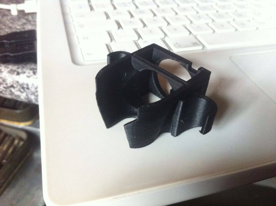

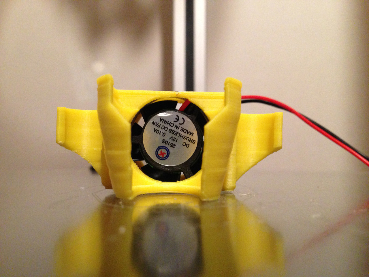

I'd like some seasoned eyes on this print to let me know if this looks adequate or what suggestions you might have to make it even better. Overall I think it's good, but I do notice that the layers "wobble" a bit vertically. Or in other words the layers seem to be ever so slightly shifted from one to the next as it was built. It is minor though. The fan actually fit in without needing to file. Wasn't too stringy either, requiring only a few stray strands to be cleaned up.
Did have some problems using the gluestick to keep the ABS from peeling off, so after two unsuccessful attempts I used Aquanet and it finished with no problem.
Whatcha think?

Fan installed in shroud -front view

I'm not exactly 'seasoned', but I'm going to post anyway! Looks pretty good! Especially if it's one of your first prints. It's a pretty steep learning curve getting to know all the settings and everything, so your parts will only get better as you figure out what works best for you. I can see what you mean by the shifting on the 3rd picture. Make sure everything is tightened properly so you don't have any play. Make sure the belts are tightened properly, stuff like that.

I actually just noticed something that I failed to do when building the printer. The nut that holds the extruder was loose, right above the melamine spacer. That was something I just hand tightened while building, since I was afraid to snug it up too much. I've now tightened it with a wrench and installed the fan shroud. I'm sure that will make a decent improvement since that seems like it would directly affect the extruder and layer alignment.
I'm also still a little mystified as to how much tension is just enough for the belts. The manual mentioned pushing on the meaty part of your palm to get a feel for it, but frankly that just doesn't make sense to me. Lol. That or I'm too O.C. to accept that. So, I don't have them super tight or incredibly loose, and tried my best to get the tension identical on all 3 towers.
I'm going to print the fan holder for PLA next out of ABS, so I'll see how much better (or worse) it looks on that print.

Sweet. I'm loving this machine. Tightened up the extruder, installed the PEEK fan, ran a new autotune on the Extruder, re-calibrated and that seems to have taken care of the layer alignment issues. I went against the manual (Gene's) suggestion and did not slow the machine down near the small detail area. Left it at 100%. I now have it cranking at 150% speed and it's still looking great. Images below.
