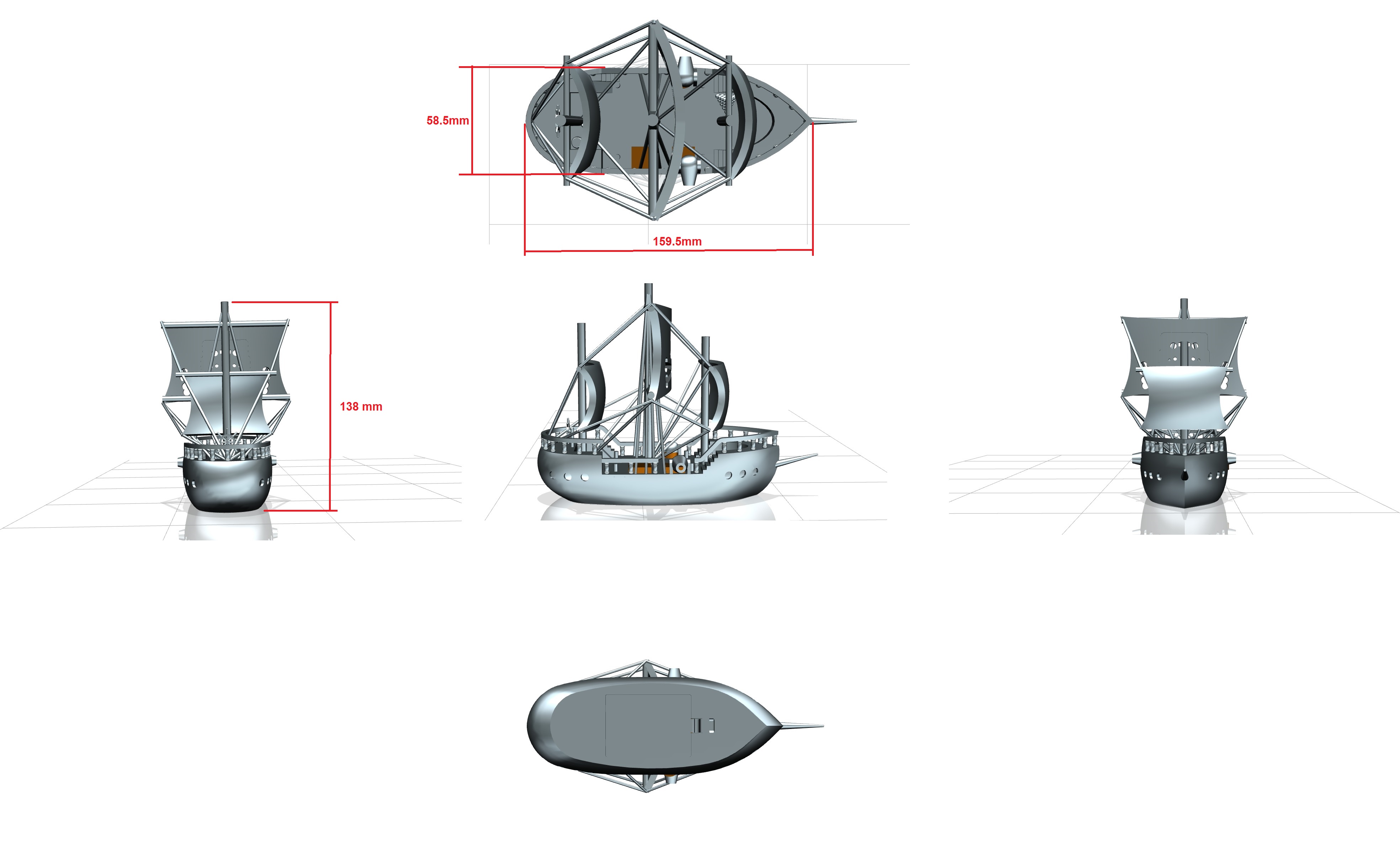

Overly ambitious and certainly foolhardy I am working on my 1st 3D Design, STL to GCode, 1st Printer, 1st Prints..
My indie film maker attitude has me in this pickle where I have to deliver a working FM Radio contained in a 3D printed Pirate Ship.
The design of the Pirate ship is based off of a model I saw on Thingverse
The STL files were created by a a man on Fiver for my project
I used Kisslicer to convert the files from STL to GCode (Kisslicer is very intuitive)

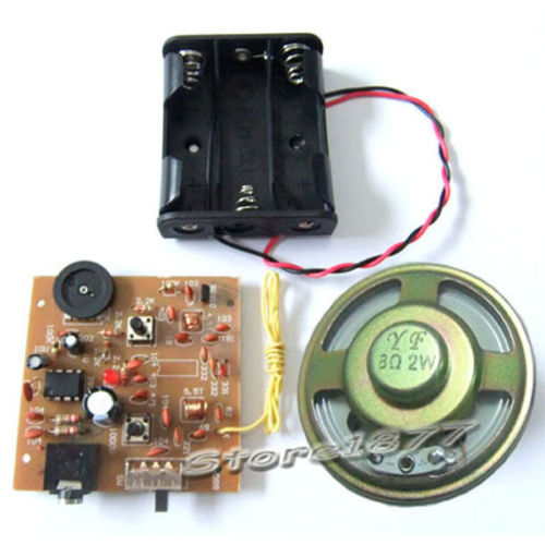

I have the radio parts from China to solder.
I have to purchase a 3D printer likely the Rostock max v2 due to its build area, price, and the community as deciding factors.
Can you look over the the three files and tell me if they are printable? If you foresee any problems? The TopCase gcode file is very big so the link to it is here in my DropBox

Dimensions
Dimensions
RadioParts
RadioParts

However, I'm not sure it will be of much help anyway. The pics you posted are great, though - they help a lot!
Here are my concerns:
- Scale. If the dimensions you've got there are accurate, you're going to have some issues with the smaller parts of the model such as the helm - these will be tiny and probably wont reproduce very well unless you've got your machine dialed in nicely.
- Overhangs. Plastic FDM printers (Fused Deposition Modeling) lay down each layer at a time, which is an issue when there's nothing below an object since it really needs to supported as it prints. Support material can be printed no problem, but it will mean you have a lot more finishing to do before it looks good. The less infill the better, and perhaps it might be better to print some of the parts seperately and attach afterwards or even use a different material. For this model I'd be tempted to remove the railing completely and print that part separately upside down. For the rigging I'd be tempted to just glue some lengths of filament in place after the print is complete or just print them flat and attach later. The sails will need support below them as well as within the logo on the main sail where there are overhangs.
- Looking at the top and bottom parts - it's good that they're separate, but you'll still need infill to support the deck on the top and the switch cutaways, the battery compartment would be the same - infill to support it's top layer.
- The top half has the posts which help it connect to the bottom. Because the protrude below the join line, you'd need to have support printed up to the point where the hull starts. Not really a problem, it just means the join line wont be razor straight due to it sitting on infill rather than nice flat glass.
- The deck of the top half will need to have support structure for all of it. Not really a problem but it does mean a lot of cleaning out after the print is done.
Hope this helps. It's an interesting model, I'd be curious to see the product complete.

Re: 1st 3D Design, STL to GCode, 1st Printer, 1st Prints
The ship is basically not printable on these machines as shown. However, you could print multiple parts and assemble it. And do you really need that much detail on such a small part? The little sculpted pillars and open rail work, the little port holes, rigging, etc are going to take someone with a lot of experience to produce. Could you:
print a simplified hull as a separate piece
print the masts individually OR use plastic or wood rod for them
print the sails flat and then shape them with a heat gun/hair dryer
use actual thread for the rigging OR glue on plastic filament (that you stretch with heat and pulling to make thinner)
Taking an approach like this will be much easier and you could use different colors if that's important. White sales, brown hull, black masts and rigging...

Thank you for the feedback! I messaged the guy who is designing it with the following instructions as I really need to keep the print as simple as possible.
1) Remove the railing completely
2) Remove the rigging completely
3) Remove the logo on the main sail
4) Remove the cannons
5) Remove the pointy thing in the front
6) Remove the port holes on the sides
7) Make the sails flat
8) The top half has the posts which help it connect to the bottom. Because the protrude below the join line, you'd need to have support printed up to the point where the hull starts. Not really a problem, it just means the join line wont be razor straight due to it sitting on infill rather than nice flat glass.
9) Does it need infill to support the deck on the top and the switch cutaways, the battery compartment would be the same - infill to support it's top layer?
10) The top half has the posts which help it connect to the bottom. Because the protrude below the join line, you'd need to have support printed up to the point where the hull starts.
11) The deck of the top half will need to have support structure for all of it.
That covers it right?
