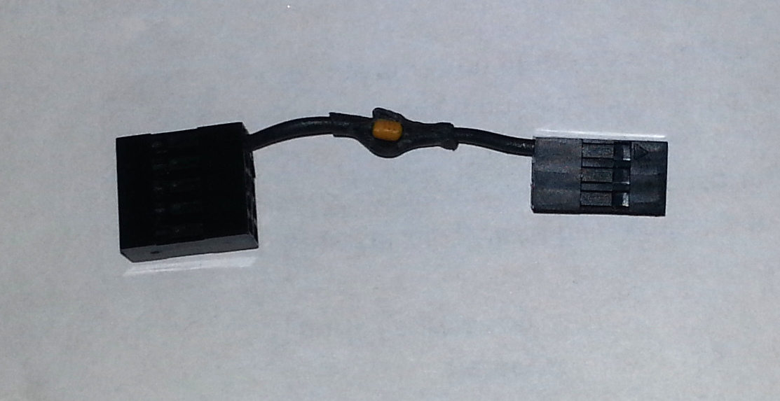

I have a cascade of challenges. First, I was able to pull voltage from the steppers by turning the motors on red/green and yellow/blue.
1. I reloaded eeprom. No extruder action. Everything else worked.
2. I had a second Rambo 1.2 board so I changed out boards. Then my display went out! At this point, I'm chortling to myself ("Is there anything else I can be doing that might be more entertaining right now?") I can control the printer from Repetier but I know it's the shorty jumper on the new boards.
3. I have an extra 1.2 board so I took the shorting thing out of the new board and switched them. No worky.
BTW, if you strip back the shorty jumper, this is what it looks like. I don't know what it is so I thought I would check for continuity. That didn't work....
I'm going back to the extra 1.1 I have, take the 1.2 boards to MRRF and bench test. I would love to print this week! LOL
Thanks for all of your help!!!
http://dropc.am/p/KhiI1a

John, that jumper is not actually a jumper and contains this part:
http://ca.mouser.com/Search/ProductDeta ... 0026D580DL
I'm not sure what a continuity test will show because I am not sure what the resistance value of the above part is.

A variable resistor - so if you give it a specific voltage, it gives a specific resistance. Odd that it is used to handle shorts.
Anyway, after more isolation, it's a blown stepper. Dammit. Better than a board of course. Need to source one in the San Diego area. Fingers crossed. And there are none. Argh!!!

JohnStack wrote:A variable resistor - so if you give it a specific voltage, it gives a specific resistance. Odd that it is used to handle shorts.
BTW, do not simply reverse the plug on E0 stepper!!!!
Sorry to hear you had a bad stepper after all.
The varister quickly changes it resistance to an input voltage so if a high voltage spike hits it, the resistance increases fast enough to prevent the spike from propagating to the
rest of the board. Could you have missed a source for a stepper in a city as large as San Diego?
