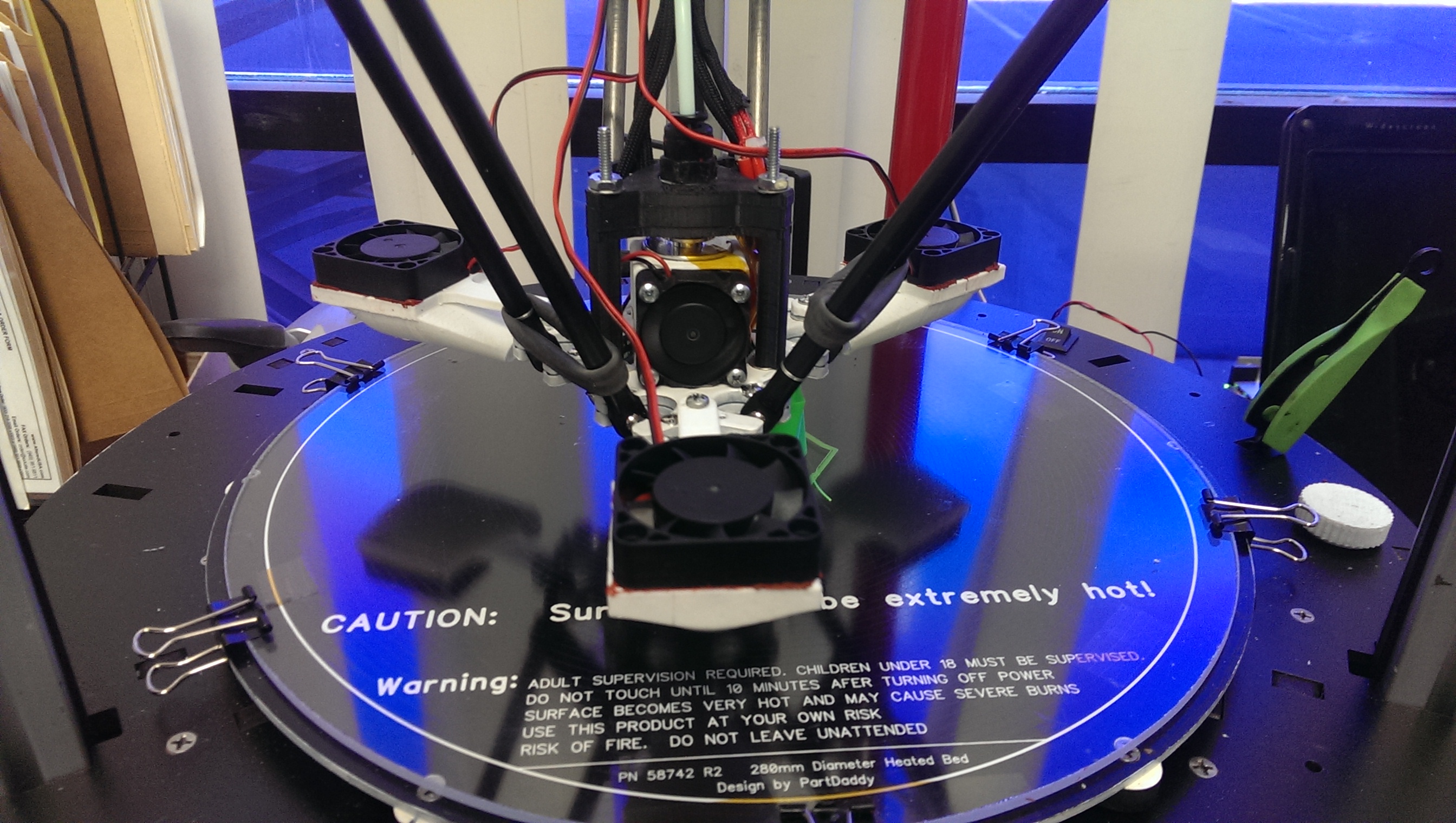

Wanted so share a couple upgrades I've made lately.
First, cooling fans shrouds/mounts. Variations on a theme, but I've had a recent uptick in print jobs in PLA and I wasn't happy with my layer cooling setup - and couldn't find anything I was happy with online, so I designed my own.
40mm fan shroud_v1.STL
(343.05 KiB) Downloaded 360 times
In case you can't tell from the pic, they are 40mm x 10mm fans. 12v. They are rated at 5.75CFM. I plan on installing a rheostat to be able to pot them up/down, but that's not necessary right now.
Also, the fans print great without support provided you print in .20mm layers or lower and have decent bridging ability.
I didn't want to use screws, so I just used some RTV silicone to attach them.
I also made a panel that mounts to the top plate for on/off switches for each individual fan
Fan Switch Box.STL
(13.75 KiB) Downloaded 423 times
I attached the Solidworks files for any that may be interested.
Really happy with their functionality. I'm printing PLA nicer than ever before.
Also have another upgrade in the works to swap out the cheapskate bearings with smooth rods and linear bearings. Waiting for some parts to arrive, but I will be sure to share that in another thread soon...
Cheers

Nice. Have you restricted your build area to make sure the fans don't hit the extrusions? The seem to stick out pretty far :-D.
Re: I'm back... and I'm here to show some new upgrades
Posted: Mon Jan 27, 2014 2:19 pm
by cope413
They can't hit the extrusions :)
They would hit if the print bed was 285mm, but at 280, free and clear

Posted: Mon Jan 27, 2014 2:52 pm
by Eaglezsoar
That tube and bearing upgrade sounds interesting.
That is an E3D you are using for PLA yet no problems. Interesting.
