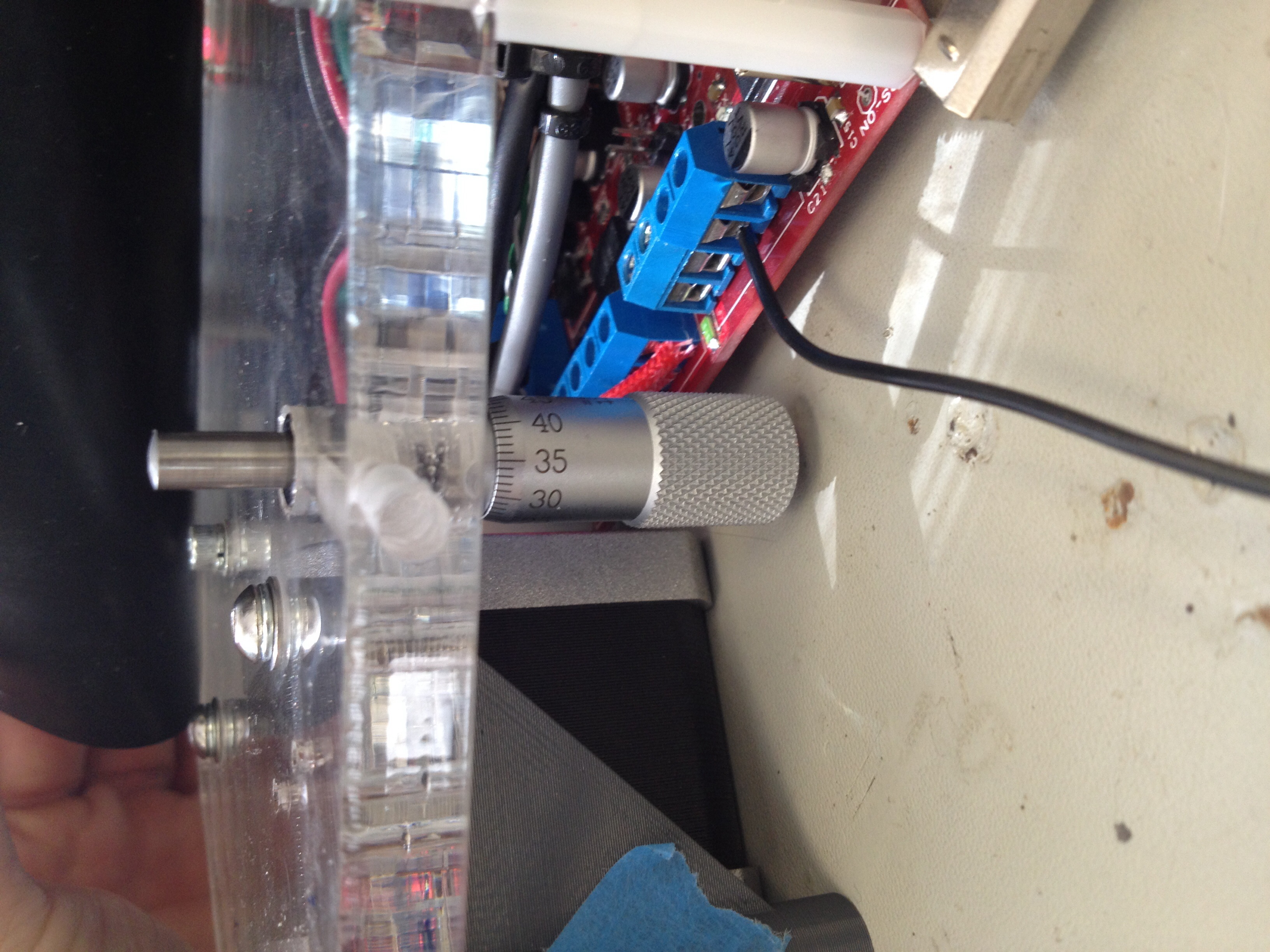

Recently though I have been building my first 3D printer - A Rostock Mini.
It has provided a welcome distraction from work!
Very quickly, its a standard Rostock Mini with some of the modifications listed here: http://www.thingiverse.com/thing:51288
Most of the parts were sourced from either http://www.makershop.co.nz (Mike is awesome to deal with!) or http://www.geeetech.com.
Some hard fought lessons -
I tried an EZ-struder, but with 3mm filament, and near 1m of PFA Bowden tubing it would always slip. Or the driver would overheat and thermally shutdown/current limit.
I'm now using a 5.18:1 planetary motor - no issues at all.
I also tried a http://www.geeetech.com "J-Head", it probably contributed to the extrusion issues. Now using a http://www.hotends.com one.
Until recently I couldn't get KISSlicer to behave - it would print at top travel and try to lift beyond the end-stops, or it would try to print at glass level or below (i.e. through it)
Was using Slic3r however its slicing and print quality isn't as good - finally managed to get KISSlicer to work!
Thanks to all those who contributed .ini files - they have helped immensely!
Megatronics v2.0 hardware running Johan's Marlin delta/Kossell fork FW. Smart LCD controller and adapter... All pretty standard stuff and no issues with any of these.
A couple of minor tweaks that I have made are around the heated bed -
Micrometer 3-point bed leveling
Custom aluminium-clad PCB heated bed
Magnetically attached
