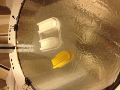

My kids have a small "suitcase" made of plastic that holds a toy picnic set. The catches for the case had broken a while ago, so I thought I'd try modeling and printing replacements. I took some measurements of the existing broken part using digital calipers and then modeled it up in FreeCAD. A word to the wise, save often if you're using the 0.13 version on Mac. The "chamfer" option sometimes causes a crash :-( Anyway, I was able to print two replacements in white ABS. The picture shown here has the original part (in yellow) and the two replacements still on the bed. Of course, I forgot one thing when I modeled these: ABS shrinks :-P! They fit the case so tightly that my kids can't move them!! Anyway, I'll be tweaking the model slightly to get something actually usable ;-)
Sorry for the poor picture quality. I took it with my iPhone and lighting was pretty poor.

Nice print,
What is that on your bed ? aluminuim foil under the glass?
Are you printing on hairspray ?

maxman wrote:Nice print,
That's aluminum foil (3 layers of it) under the glass and glue stick on top of the glass. I've been having adhesion problems with this new filament (Jet, white ABS, ordered through Amazon) and I've been experimenting with different things. I *think* the foil is helping even out the temperature a bit, and the glue stick seems to be working better than hairspray did with this filament, but I've had far more curling and adhesion problems with this stuff than I did with SeeMeCnc neon green :-(

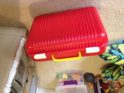

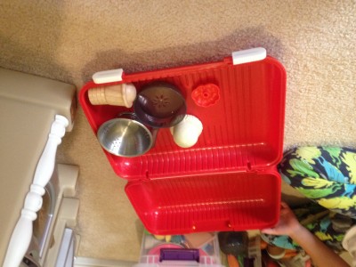

I increased the size slightly and reprinted. Here's the final parts in use:
Closed case with 3D printed latches
Open case
Open case
No idea why they're upside down in the post :-P

by barry99705
dpmacri wrote:I increased the size slightly and reprinted. Here's the final parts in use:
Was your phone upside down when you took the pictures? I've noticed that even though the screen auto rotates, the exif data won't be updated, so the images will be wrong. Had to reencode a video because of this once.
