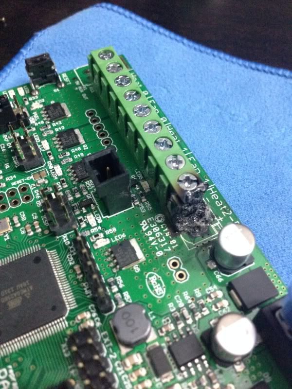

Hey everyone if I'm looking for this the green connector on the board what would I search? I found this after looking to hook up a bed fan.
[img]http://i292.photobucket.com/albums/mm22 ... 80e2e4.jpg[/img]

Ultimachine.com is the producer of the Rambo boards and should be able to source the parts.
Send them a picture of the burnt connector and ask how to get one.
You may have to cut the connector with a dremel tool to get it off because it is difficult to desolder
multipin connectors. Also ask if they can repair the board.

Do you have an obvious cause as to why it melted and burned? Were you using the heat2 terminals?
You're the second one with that exact problem that's posted here. The first is here: http://forum.seemecnc.com/viewtopic.php ... 659#p18646
For a generic part that should work, searching for "pcb screw terminal block" should give you a good starting point.

These connectors are also commonly called "captive screw" connectors. That might be a useful search phrase.

That happens when the connection is very poor. A contributing factor could be if the wire was coated with solder before inserting into the connector. The solder will reduce the surface area of contact, increasing the resistance of the connection and causing it to heat up and burn the shell.
The connector SHOULD NOT BE DREMELED OFF! The whole connector bank should be properly desoldered and the burned segment replaced. They're snap-together in blocks of two.
The thought of someone cutting off the connector with power tool just makes me want to throw things. Fix it right or don't fix it at all.

A dremel tool can make it easier to get them out, once they are out they are then properly soldered back in, replacing each bank of two. There are different ways to do things and one man's right is not necessarily the same as another. As long as the end result is the banks are soldered back in as they came from the factory how to get them out is not that important.geneb wrote:That happens when the connection is very poor. A contributing factor could be if the wire was coated with solder before inserting into the connector. The solder will reduce the surface area of contact, increasing the resistance of the connection and causing it to heat up and burn the shell.

Eaglzoar- I sent Ultimaker an email asking what my next steps should be hopefully I will get a reply from them tomorrow.
Eric- It could have been a couple things, one I believe I may have been using to big a gauge wire (combined speaker wire). Or the two connections some how touched.
Three could it be that the bed is working to hard to get to 120 degrees? I usually have to place a towel on it for it to get up to temp.
Yes I was using the heat terminal next to the burnt one. Then I removed the burnt connector when unscrewed the charred wires.
Geneb no solder on the wire ends just twisted speaker wire. They are not snaptogether blocks but all one block. I did a search and found some just not sure they are the same size even though they are green in color.

I'm almost positive they're snap-together segments. The seams are very hard to spot.
