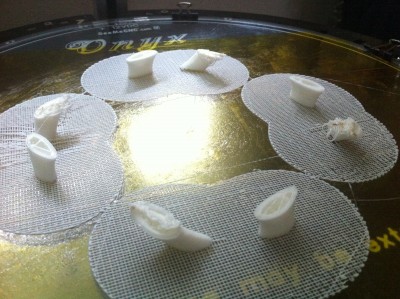

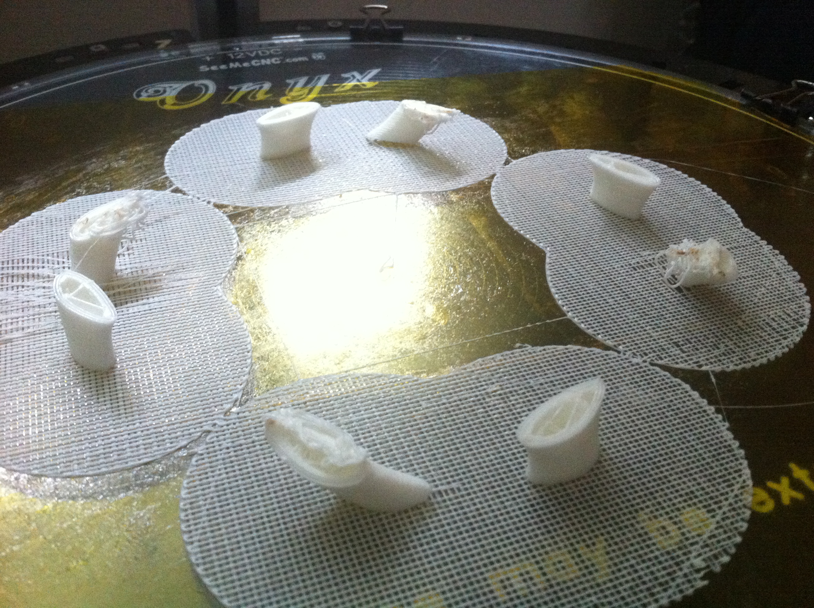

I've done all the calibration for the Extruder done many test prints check cheapskates, heat levels, connections, belts etc. regularly I got mine at the Kickstarter and have made alot of items but occasionally depending on the model this happens
I have a glass bed and use Kapton Tape and on top of that Strong Hold hair spray.
The rafts break but only AFTER the nozzle keeps pushing against the model otherwise on their own they stay unless pushed against by the nozzle.
Rafts will break on the top layer but bottom still sticking to bed usually as shown in attachment. ( this was me trying to start the print from where it broke on the object the first time and abs glue them together )
My perimeters are set well my wall prints were near perfect as well as Pyramid and steps pyramid but I'll try some more tomorrow has been a while.

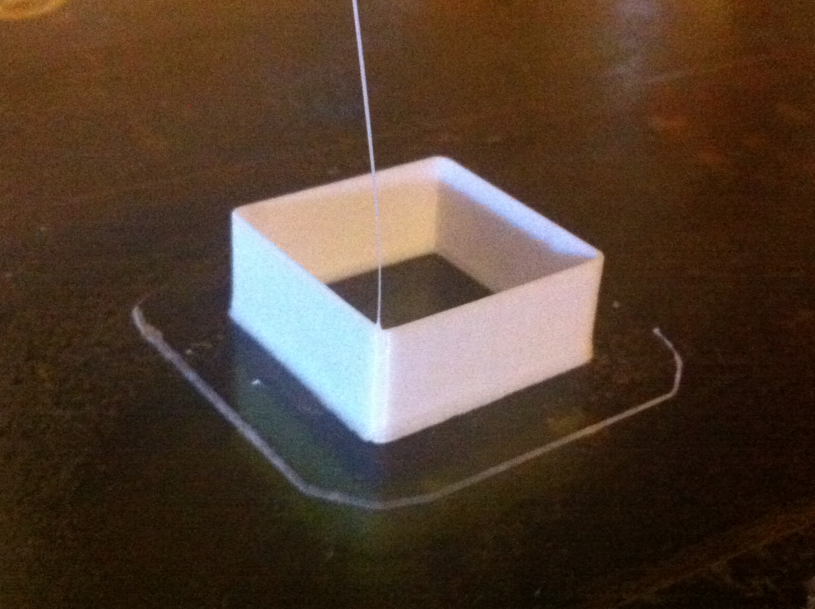

Did a quick hollow square print and no pushing against object so I don't get why some prints get squashed and some don't although this is a very small print

Re: Still can't figure out Nozzle knocking prints off
Did you try calibrating the towers and printbed by the manual?
I was having the same issue. If the print head assembly doesn't travel on a perfectly flat plane it could hit the higher side of the print as it is traveling to it...Running the G code calibration schemes in repetier host seemed to fix that issue for me.
For multiple objects like that if I am overextruding I'll I get raised areas from the print head squishing material upward, by the time the print head come back around those verticle ridges/bulges/etc are hard and so the print head will put considerable force on the object when it moves across and I don't have a high z-lift.
