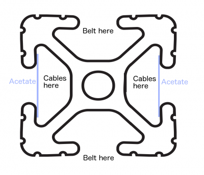

Ok, I've got the wing design almost set - but I have a GINORMOUS question:
How do you recommend running the wiring for the hot end and extruder? I'm going for an ultra-clean look...
Right now, my plan is to run it all through two of the uprights (barely fits but does) and have the bowden tube and hot end wiring arch between one of the uprights.

by kbob
Run it through the side channels in the extrusions. Cover them over with a strip of acetate or something similarly thin and stiff.
Like this.
Like this.
You'll have to figure out how to route it so it doesn't go under the bolts and T-slot nuts. Or maybe you can use bolts short enough that they don't protrude past the nuts. 80/20 also sells thinner nuts.

by JohnStack
I would do that; however, I'm using the side slots. They're sliding over keys in the wings. That gives it rigidity/precision.
Maybe starting routing wire above the keys.
And now to source 6.6mm acetate strips... LOL
