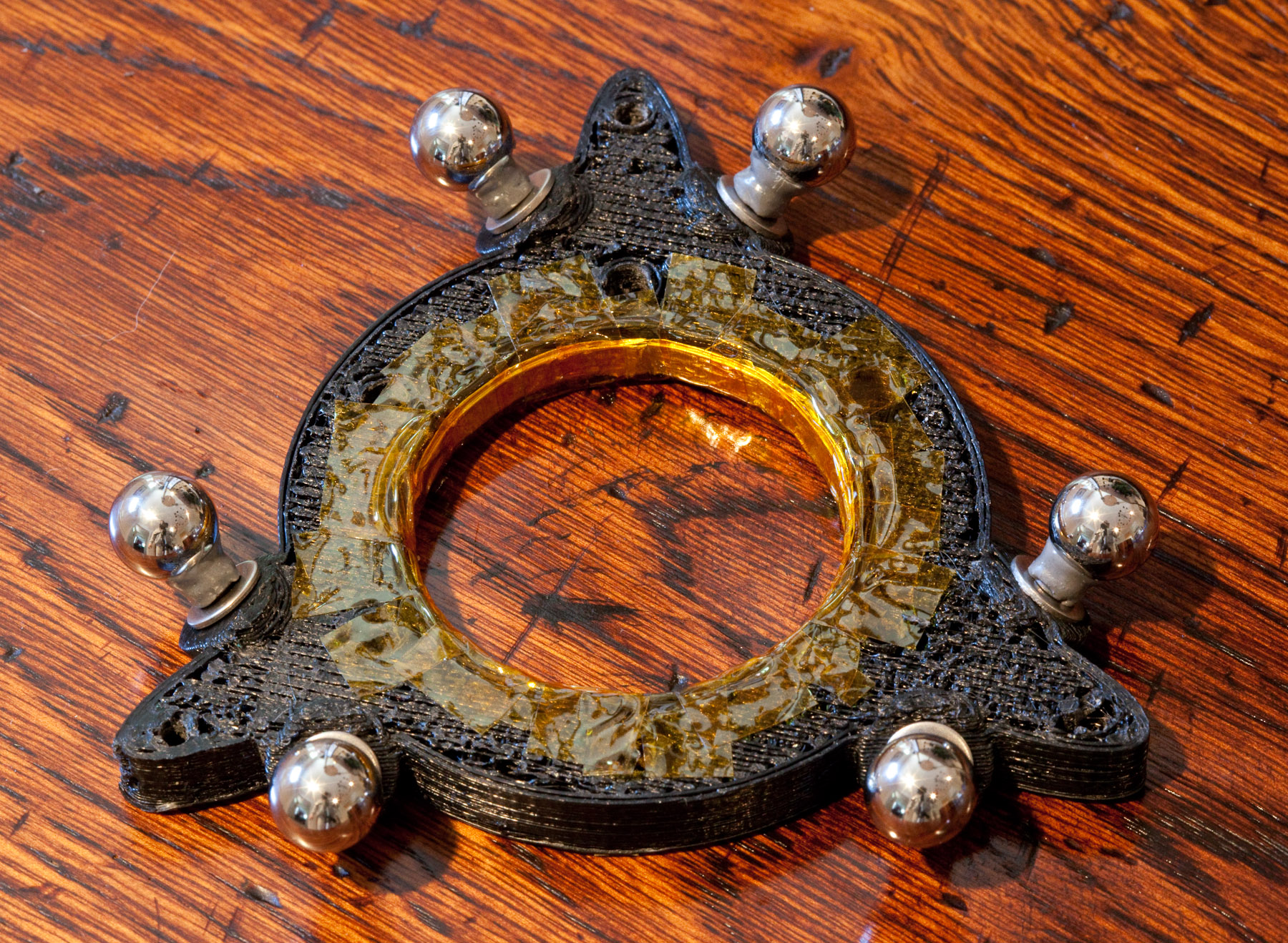

I wanted to be able mount a camera & cooling fans on the effector later and I thought xnaron's effector wouldn't have all the mounting holes for me so I also made my own effector in openscad. I planned to use the standoffs to create a space for my peek fan, so I made a rudimentary heat shield for the center hole of the effector with aluminum foil & kapton tape. Not sure what happened to the top surface but I can always print another.

prep bearings
You need 12 of these, but I suggest preparing a few extras (a) so you can reject a few if they don't come out as well and (b) so you have extras in case they ever come detached from the screws. I taped off the bearings leaving about a 5mm diameter exposed circle. Holding the bearing in my hand, I used a coarse sanding drum on a dremel to abraid the exposed area. Then I removed the tape and soaked the bearings and screws in acetone.
epoxy screws to bearings
Using a fork, I fished the bearings & screws from the acetone, dried them in a paper towel and put each bearing in a boom end w/magnet, abraded side up. If you do this, I suggest keeping the boom arms at least 6 inches apart from each other to prevent them from jumping together. I mixed the jb weld on a piece of cardboard using a wooden kabob skewer. Then one at a time, I added a blob of epoxy to the abraded area, placed the screw on the epoxy and then used the skewer to shmear a bit more epoxy around the sides of the screw cap. I tried to avoid getting epoxy on the base of the cap since that may affect how far I can screw it in to the effector or carriage mount and thus how far it sticks out - a distance we want to control. Following xnaron's instructions, I let them cure under a hot light for at least an hour and then didn't touch them until the next morning.

attach bearings to effector & carriage mounts
To avoid twisting the epoxied bearings, I pre-threaded each hole where the bearings screw in using an extra screw. One of the holes in a carriage mount was too loose, so I shoved some epoxy in there with my kabob skewer. The other bearings are currently just screwed in (through washers).
install
I removed my hot end, fan & LEDs from the stock effector and then removed the arms. Then I removed the old carriage mounts and replaced with new ones. Fit was perfect, although the holes for the end stop screws are a bit looser than I would like. I attached the hot end, LEDs and fan to the new effector and then finally came the fun part. Attach the arms & effector using magnetic arms.

Barnett: Nice looking effector! I printed one out and it looks like your effector has about the same END_EFFECTOR_HORIZONTAL_OFFSET as the Max stock effector (about 33mm)
Thanks, I wasn't sure where to measure from, so I pushed the bearing mounts in pretty far, thinking the pivot point would be center of the ball.
