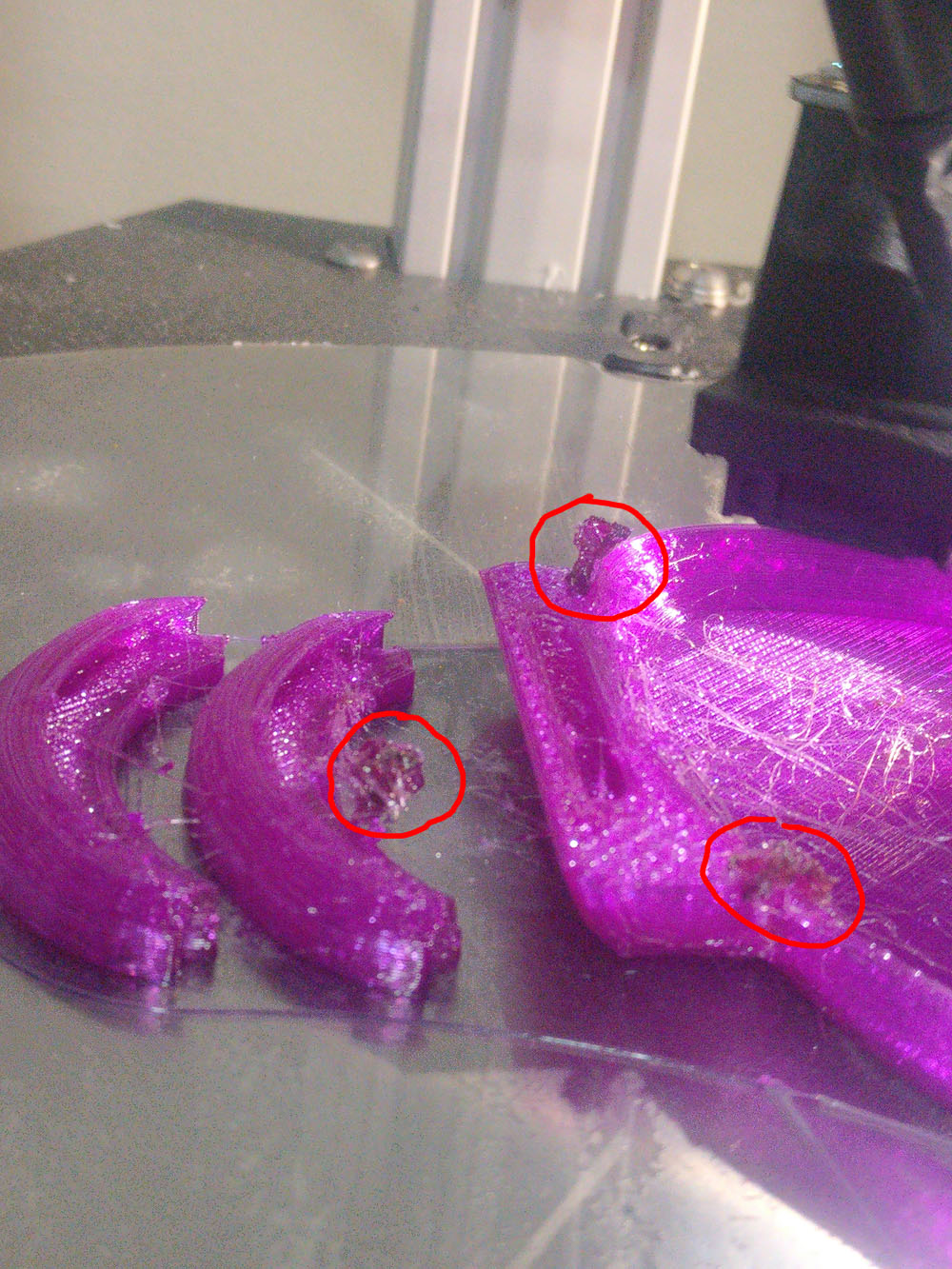

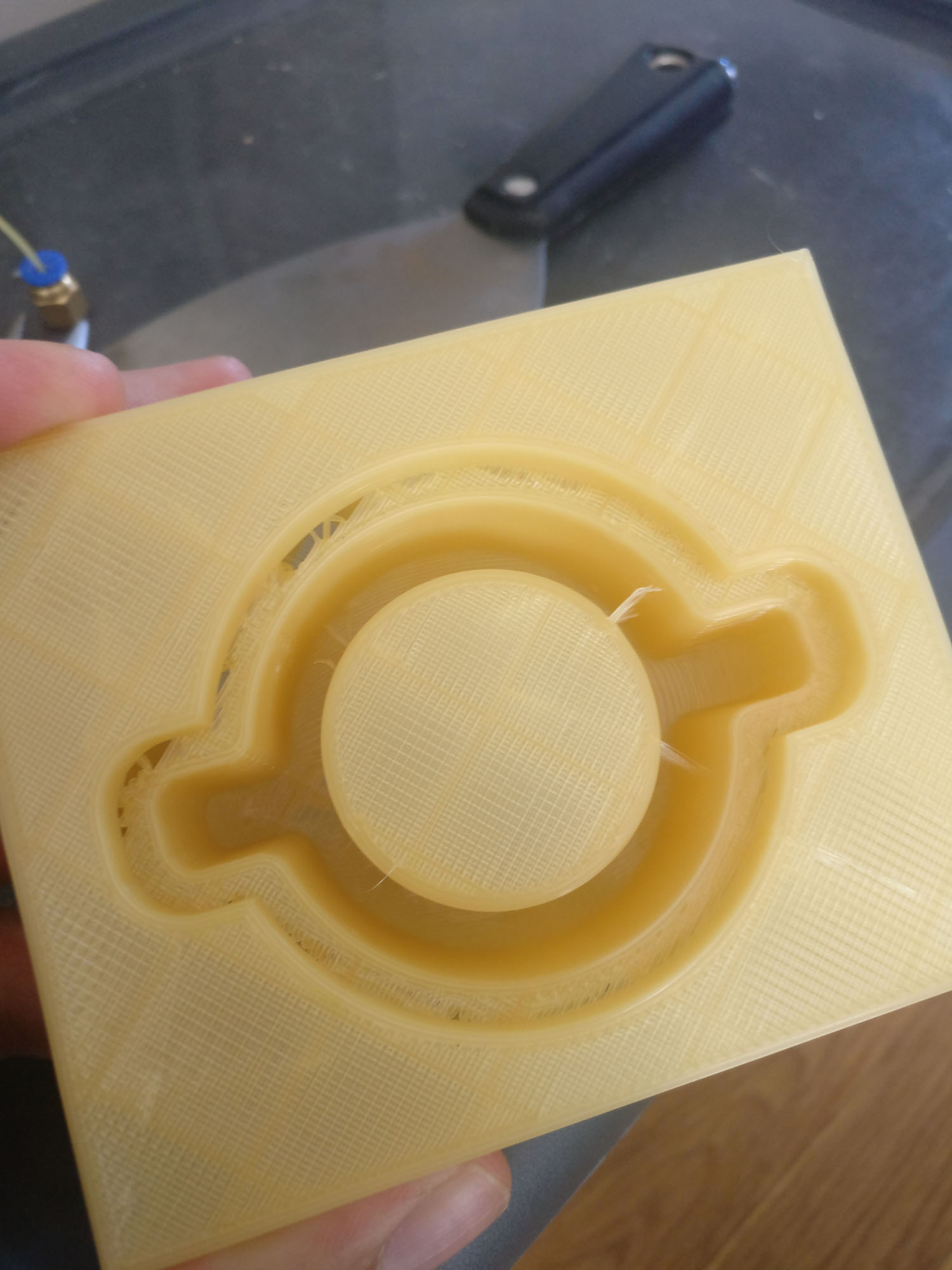

The big issue I'm having now are these random giant zits. They're huge and I've never seen anything like them before (maybe it's related to it being a bowden?).
The print is super stringy because it's TPU but I've had the same giant zit issue on the test print with PETG.

I've figured out the issue - that filament was TPU, but the problem is that I think I had retract enabled, so it would keep piling up.
Other issues I've found can be solved by reducing the extrusion multiplier. I was having a problem where my flexible filaments would eventually jam up, causing a print failure. By reducing the extrusion multiplier and increasing the temperature I was able to ensure consistent flow.

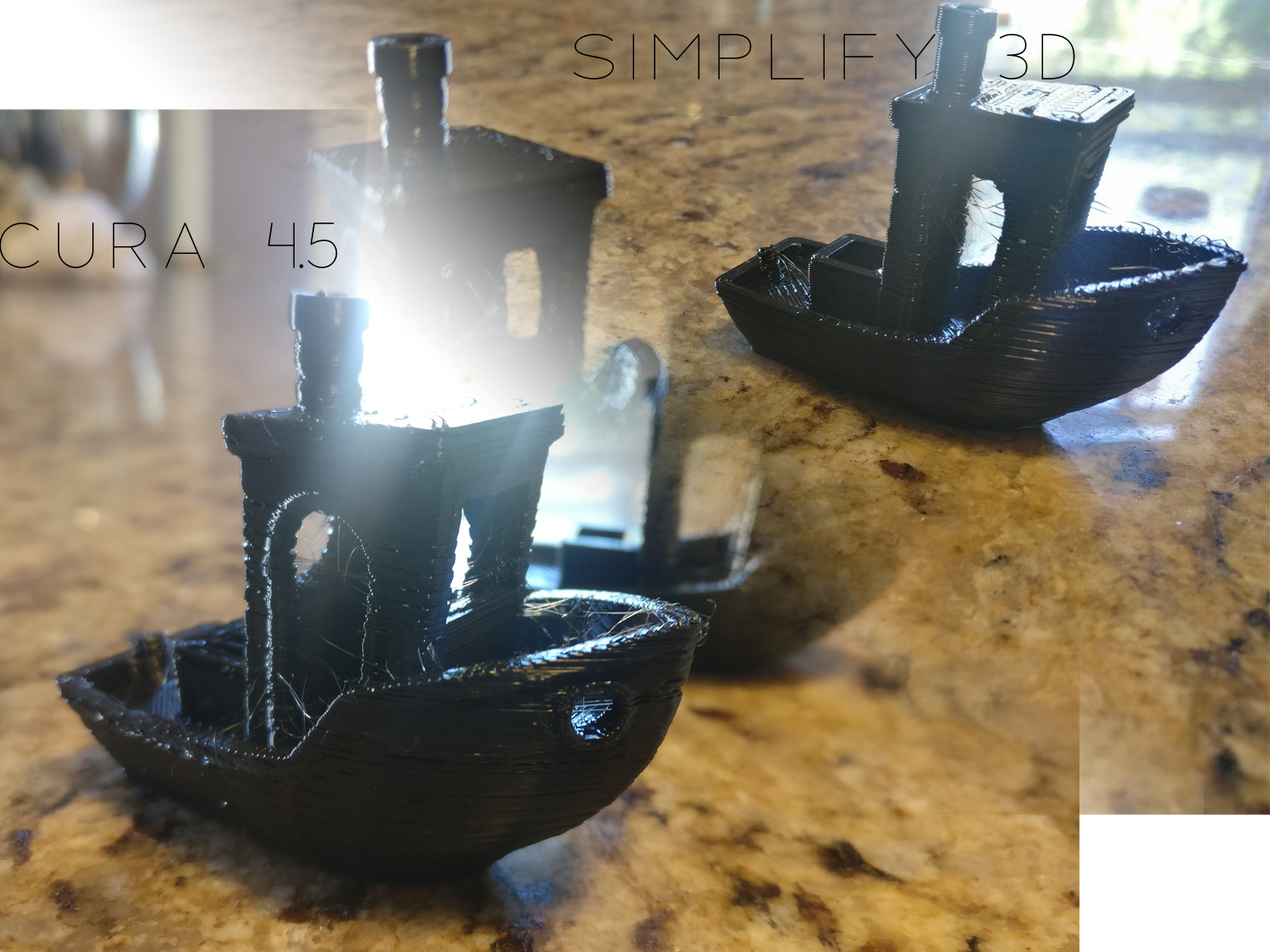

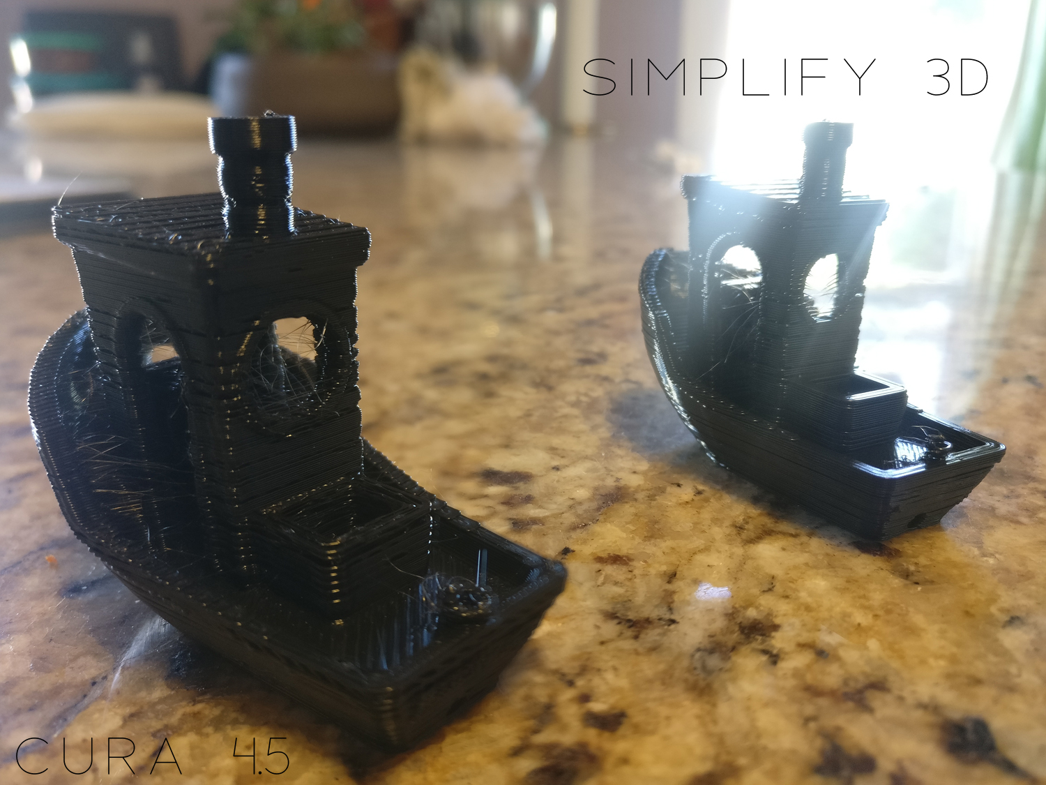

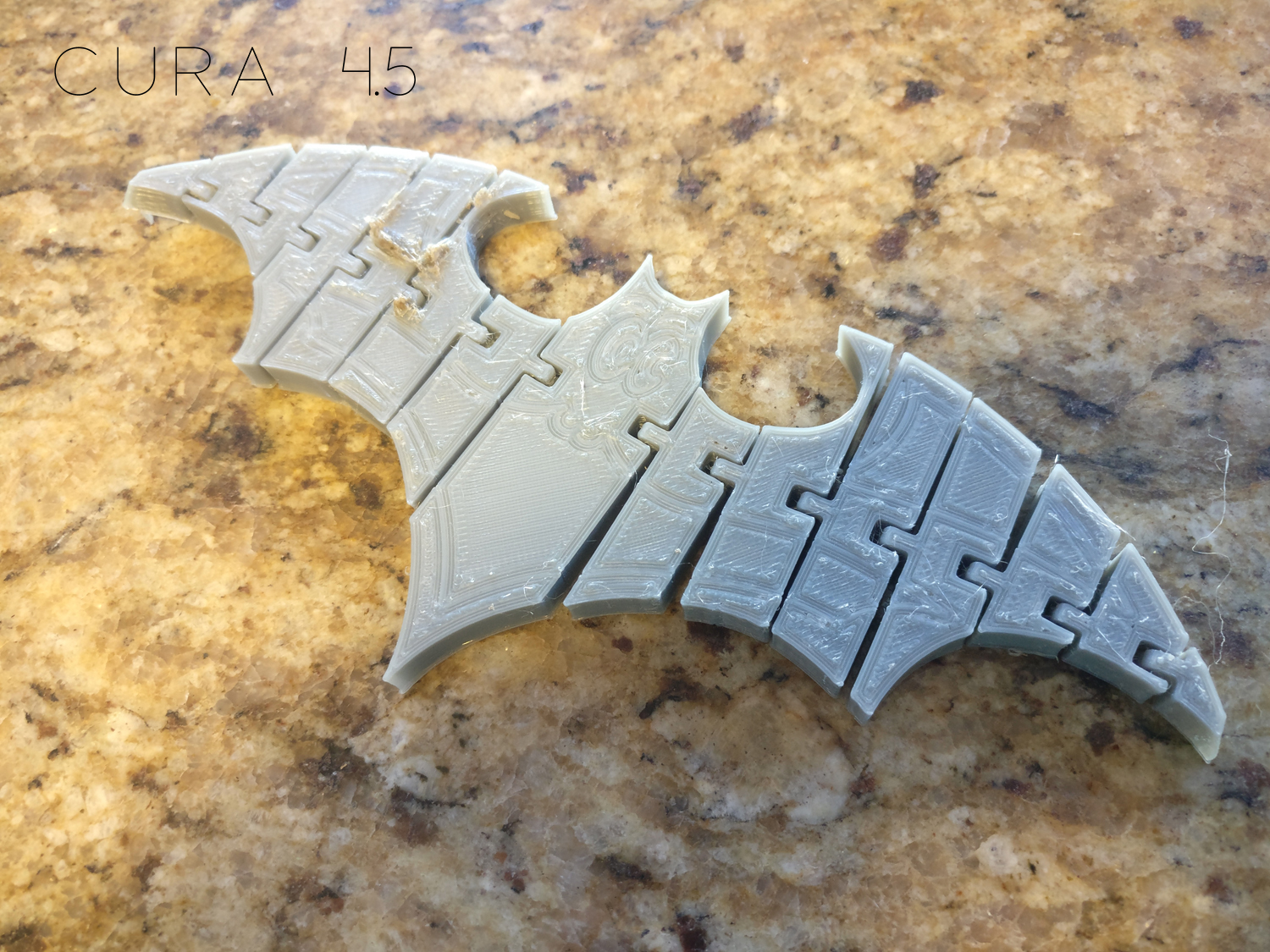

I'm getting the same issues with the Cura slicer. The grey batarang was PETG, right out of the box, with the CURA 4.5 PETG profile. The black benchies are PLA - one with the Cura "FAST" profile and one with my Simplify 3D profile.
EDIT: I also just tried it with brand new PLA and it has the same issue.

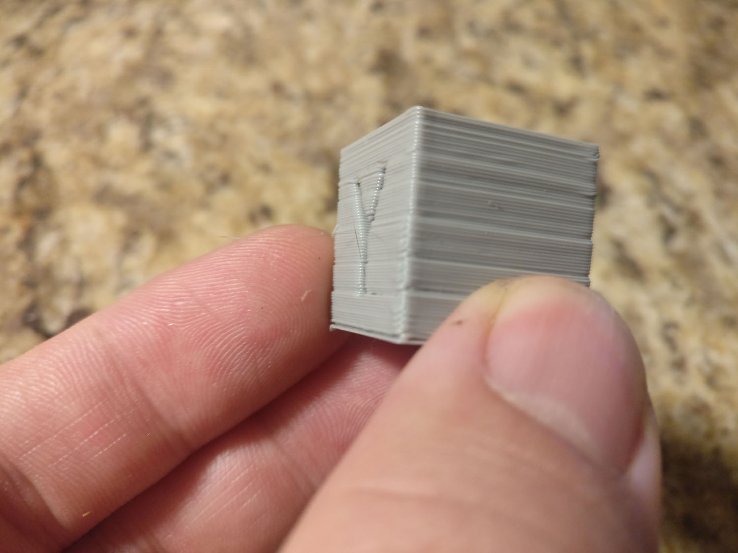

Still Simplify 3D, but more issues - this looks like it would be an out of tension belt on a Cartesian machine maybe? What could be causing this on a delta?
Hatchbox PLA filamnt @ 230 C @ 45mm/sec.

The cube looks like over extrusion to me. The batarang looks pretty good with the exception of the burnt chunk on one end. That's weird.

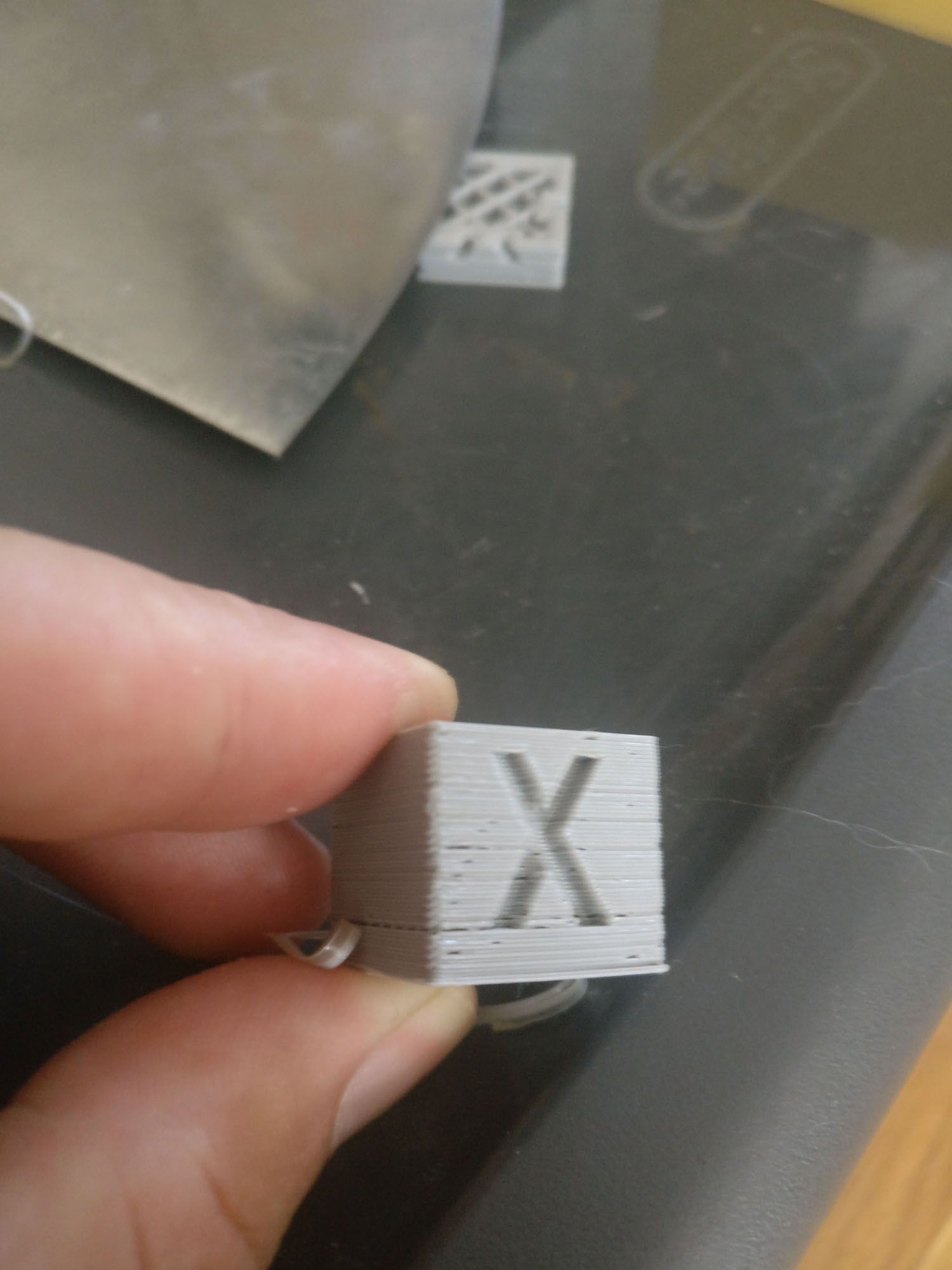

The reason I cranked extrusion so high was because I keep getting random voids like these when it's turned down:

For the top image, you've got too few top layers. For a .20 layer height, you want a minimum of 3 to 5 layers.
For the bottom image, I suspect you're hearing a "clicking" noise when it prints, right? The "rot" you see is classic underextrusion due to either a blockage (unlikely in this case) or printing at too low a temperature for the speed you're printing at. Try bumping the temp 5C and run the cube again.

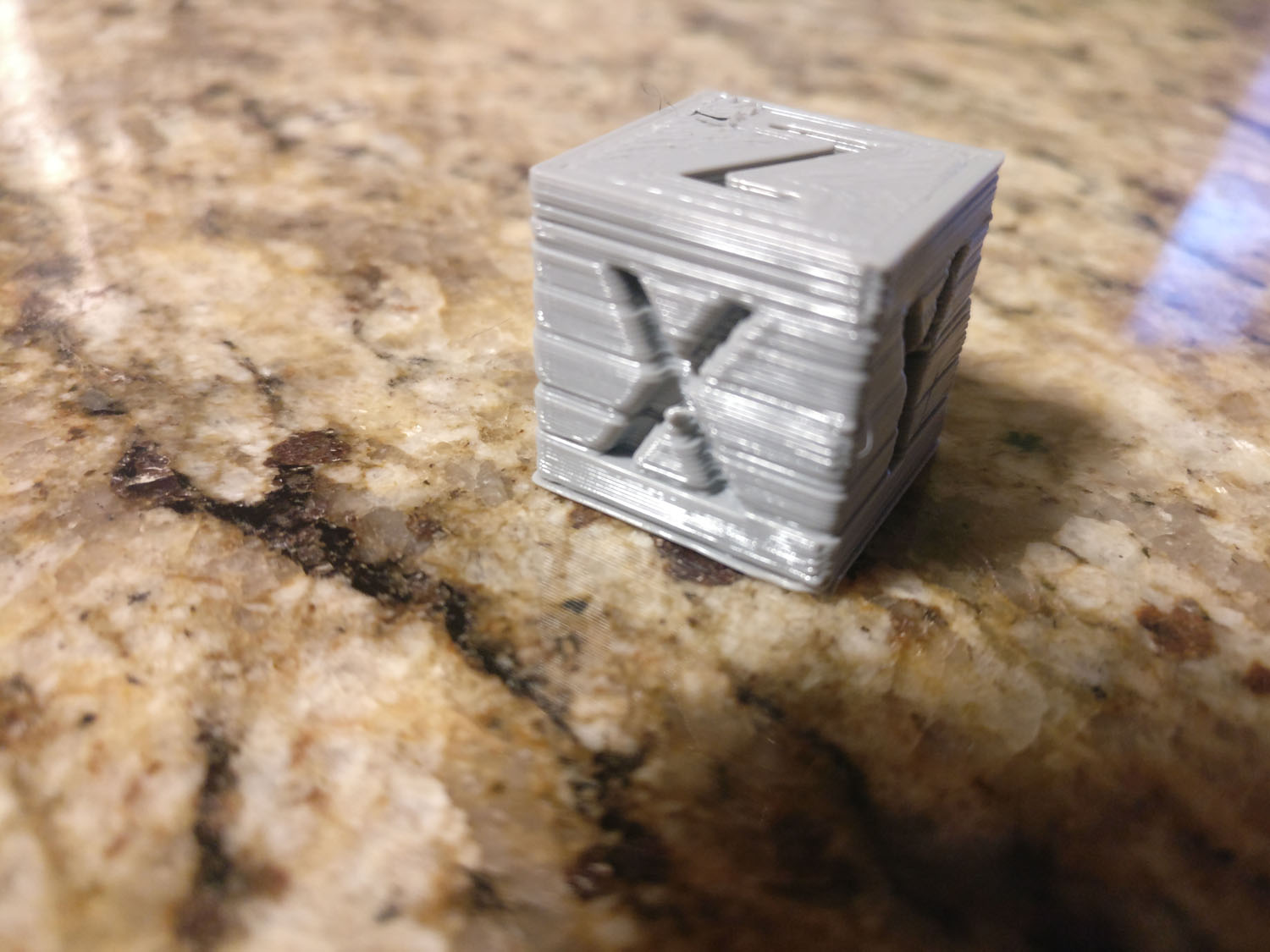

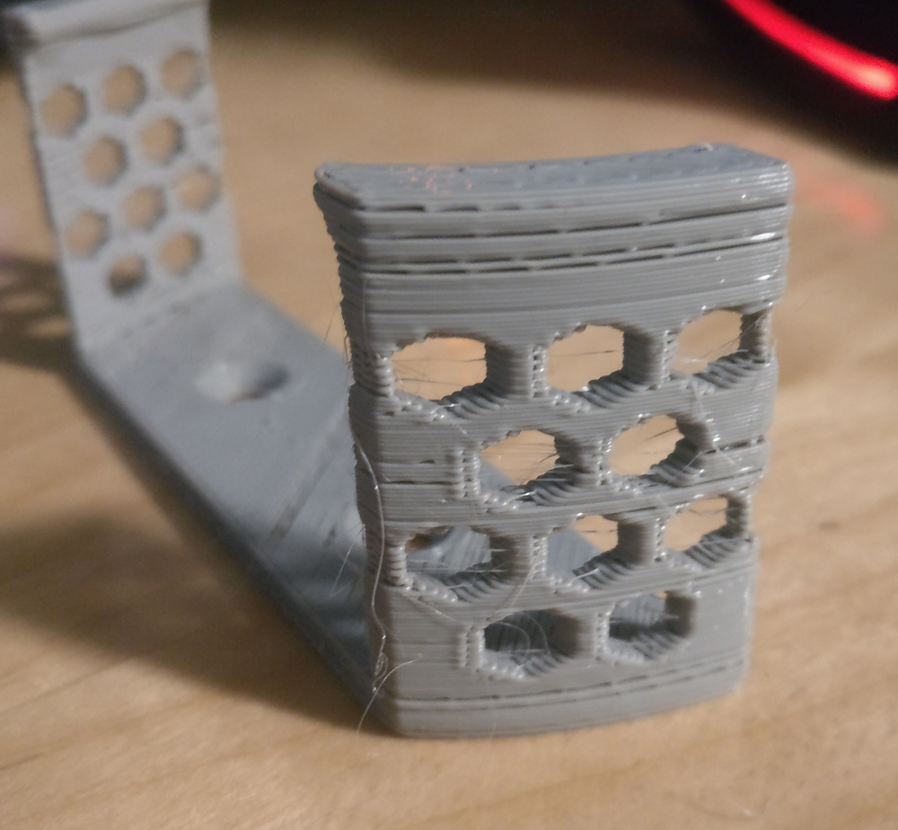

PLA, 215 C, extrusion multiplier of .95.

Re: Lots of issues with PETG
Your extruder is either skipping or you've got a partial jam in the nozzle. It might be a bad slicer setting, but I've never seen a slicer setting do that.

Just cleaned out the nozzle and am sitting next to the printer - no clicking. But I'm seeing gaps form in the layers.
It could also be a thunk - watch the knob on the EZR to see if it does an uncommanded reverse. The bowden tube will twitch and you'll hear a "bump" sound.
I'd also check to see if the gear teeth on the EZR are filled with plastic.
If you're using a 0.5 nozzle, slice a cube @ 215C and attach the gcode in your reply here and I'll try printing it on my Artemis. If I don't get the same effect, we'll know for sure that there's something restricting the filament path.
