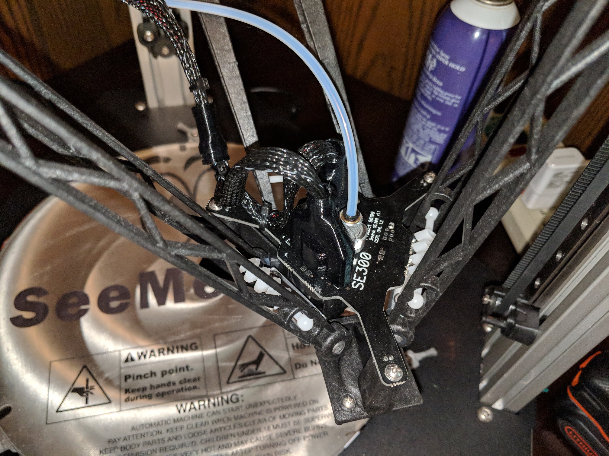

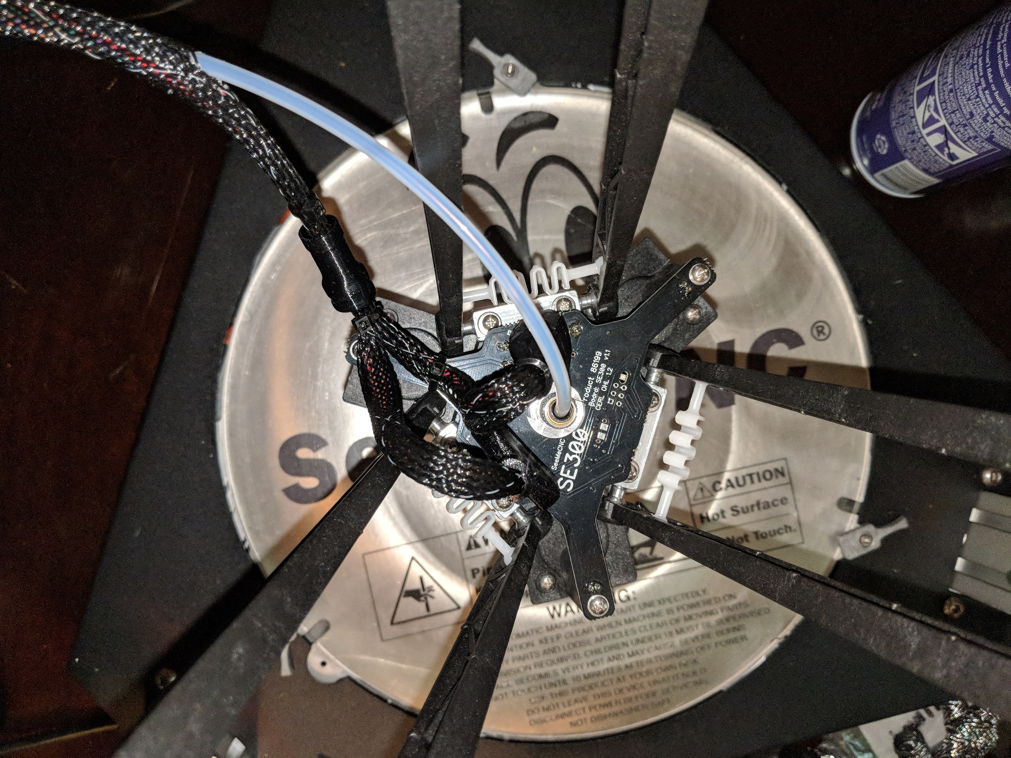

Existing machine modification. We recommend the bowden tube exits the whip before the hotend connectors in a higher location not close to the hotend. This reduces any head-tilt in the hotend itself as it moves toward limits of travel.

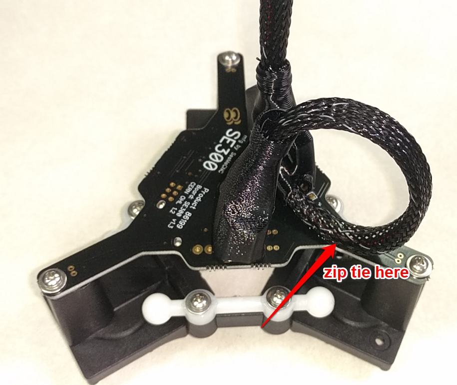

> Option 2:
This whip design has been shipping with all RostockMAX v3.2 and Artemis printers since July. Here is a photo of the final whip arrangement for Artemis with SE300 hotend. (And RostockMAX v3.2). The STL's for the TPU boot are here https://github.com/seemecnc/Machine_Ele ... ster/SE300. It has been tested without the shown wire tie (zip tie) and seems to work acceptable because the heater power wiring exits from the bottom of the 10 pos Molex connector TPU boot which isolates the white power connector from movement caused by bowden tube wiggle during printing.
