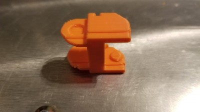

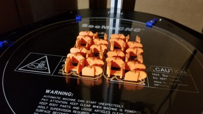

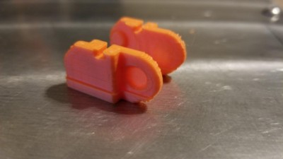

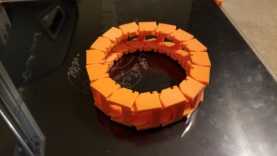

I printed a batch of these in a lot of 16 and they came out great. The next round I wanted to make a larger batch and that is when this layer shift started. 2 batches of 32 both layer shifted about the same amount on the same layer. Then I redid a batch of 16 like the good batch shown here and it layer shifted in the same place also.

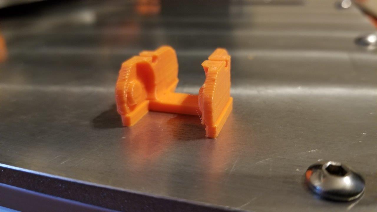

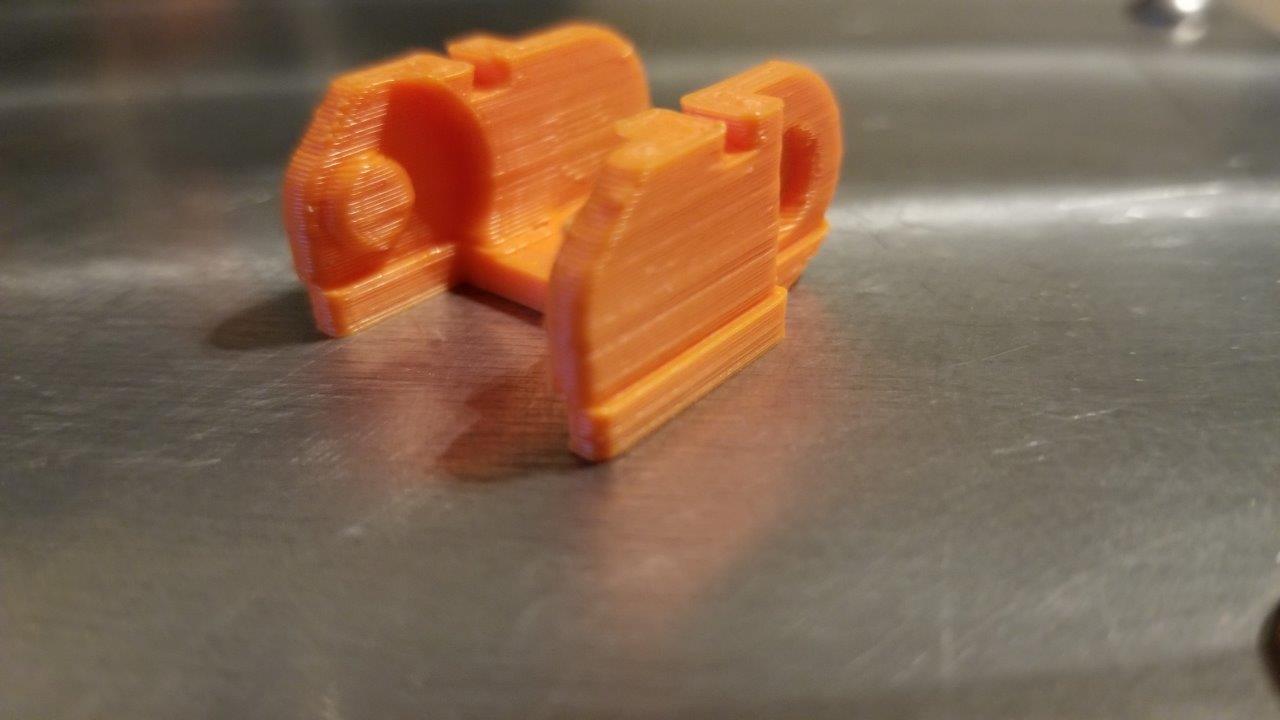

Pictures of a layer shifted part attached. This last time I even added support under the part that was curling a little which seemed to keep it flatter. It still layer shifted.

I tried to print some more of these parts and I got the curling again and sure enough layers shifting. I did some tweaks to my settings to run the fans at certain times during the print (yeah ABS). This seems to have helped with the curling, and there are no shifting layers when the curls are not there.
