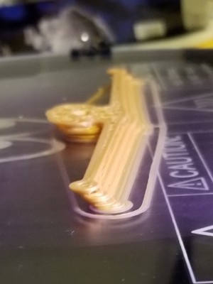

My printer has started having this problem. I tried checking the belts and cheapskates, everything seems to move freely or stay tight as appropriate. The shifting is directly towards the Z tower and is extreme. I checked the fan on the rambo. I have repeiter 0.92.2 (20170822) loaded.
Its a stock v2 with u-joint arms and a new EZR extruder to replace the EZ.
I tried bumping the motor current by 5 with no change:
#define MOTOR_CURRENT {145,145,145,135,0} // Raised current by 5 robb
My Steppers are marked
Automation technology Inc
KL17H248-15-4A
Am I using the wrong current settings?
My bed is rotated a little because of the FSR mounts (connected to the MIN_HARDWARE_ENDSTOP_Z)
The creep is directly in the Z tower direction.
None of the other layer creeping pictures I have seen in threads on here are this extreme and I am not sure why its moving to Z but staying level. Wouldn't it tilt also if it was skipping servos? Thanks for any help you all can provide.

More likely than X and Y both skipping the same amount is a problem with Z. Which way it shifts will also depend on whether the cheapskate is trying to go up or down when it doesn't.

That's a good point. Probably the Z tower somehow. Could it be that I have the FSR on the Z endstop pin? If the FSR were triggering would that stop the Z motor while its printing? Seems likely, I found this:
To anyone else who happens across this.
The low level code that check any axis endstop only prevents movement past the endstop.
It does not stop printing, or the other axis.
If Z is at either endstop, x and y can still move, Cartesian or delta. And Z is free to move away from the endstop,
and the same is true for all axis.
(https://github.com/repetier/Repetier-Fi ... issues/235)
So if my FSR is triggering the Z min endstop it would cause skipping only in one direction, Down. This would cause the shifting only in the direction of the Z tower. This fits with the symptom.
I have:
#define FEATURE_Z_PROBE 1 // Enable z probe FSR robb
#define MIN_HARDWARE_ENDSTOP_Z true // FSR install on Rostock Max v2 robb
// fsr install robb original: 4
#define Z_PROBE_PIN 10
Can I set MIN_HARDWARE_ENDSTOP_Z to false but still use the probe?

I tried with ALWAYS_CHECK_ENDSTOPS set to False and it still happened. I disabled MIN_HARDWARE_ENDSTOP_Z and the shifting went away. I have not tested probing yet but this is very encouraging.
robb
Posts: 5
Joined: Tue Feb 07, 2017 1:58 am
Re: Layers shifting to the Z tower
Post by robb »
