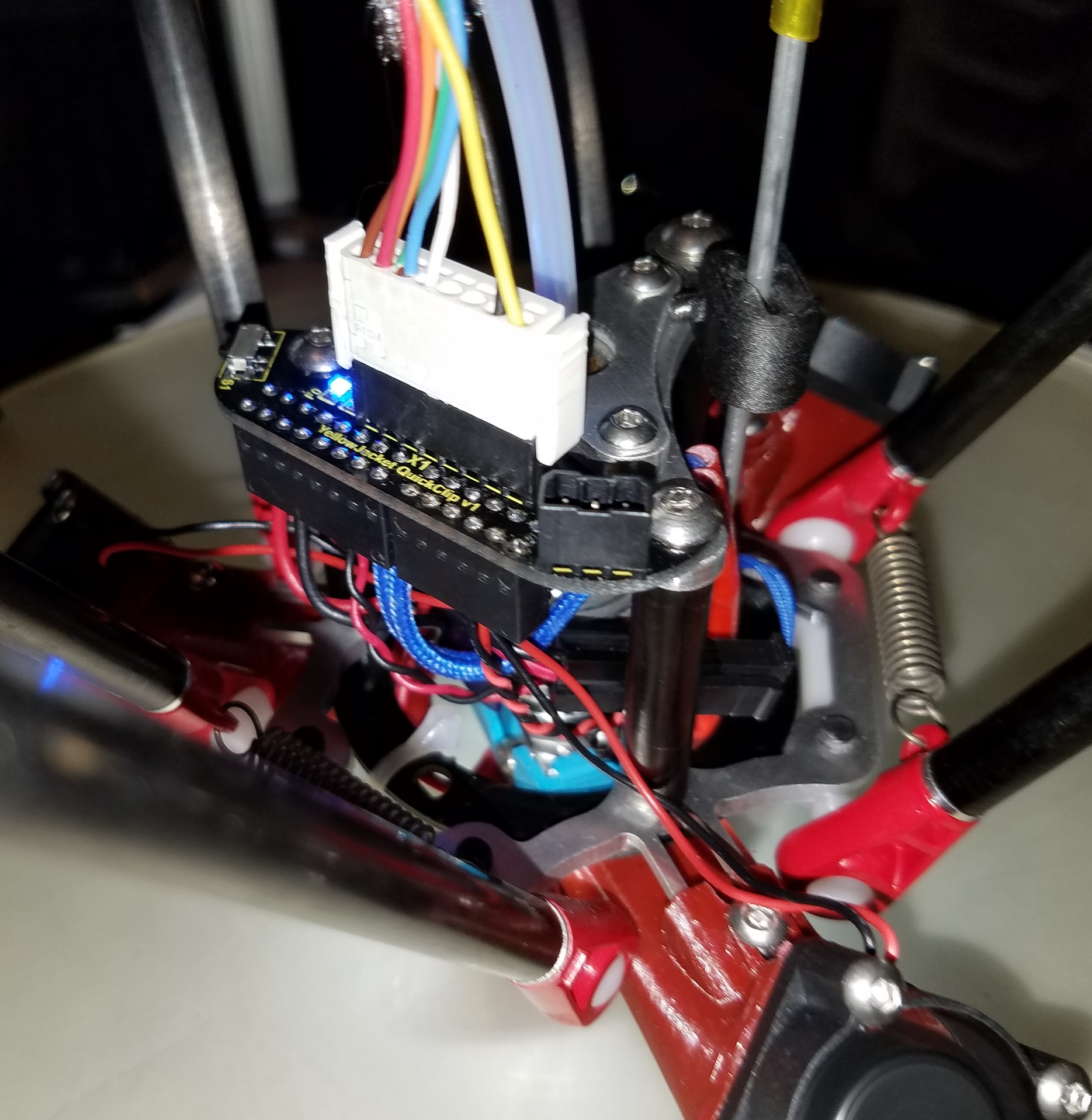

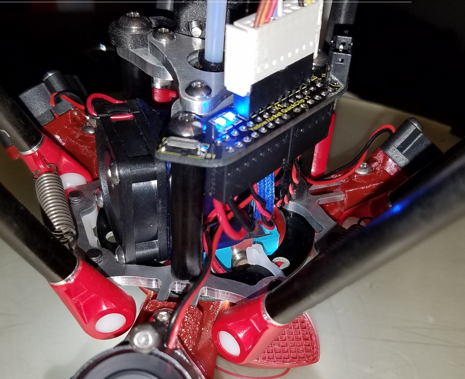

Got a board this past Thursday at the MakerHive.
Install was super easy... the neatest and quickest EVER! Sure is nice to not have to crimp pins or solder.
Very handy to have direct plug in compatibility with stock SeeMeCNC 8-pin plug wiring harness.
Now I can quickly swap platforms between machines. HE280 on the MAX Metal custom build, E3D platform from MAX Metal on Stock V2/v3 etc. etc.
The little switch to turn off light ring is pretty slick also.

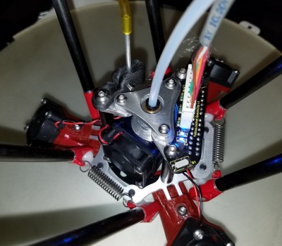

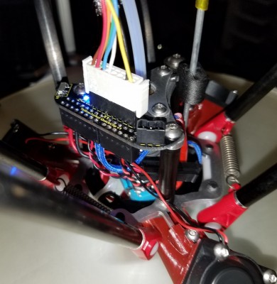

Re: SIMPLE CONNECTOR FOR HOTEND WIRING COMING SOON
I managed to get the new connector hooked up to a E3D-v6.
I struggled getting the wires into the holes without deforming the wires (especially 26 gauge wires) against the internal springs. I tried activating the spring release while inserting, but that was too much of a juggling act.
So I tinned the wires with a little solder and then the assembly was very quick and smooth.
Never put tinned wires in a spring connector.
It really wasn't hard to open the spring release
