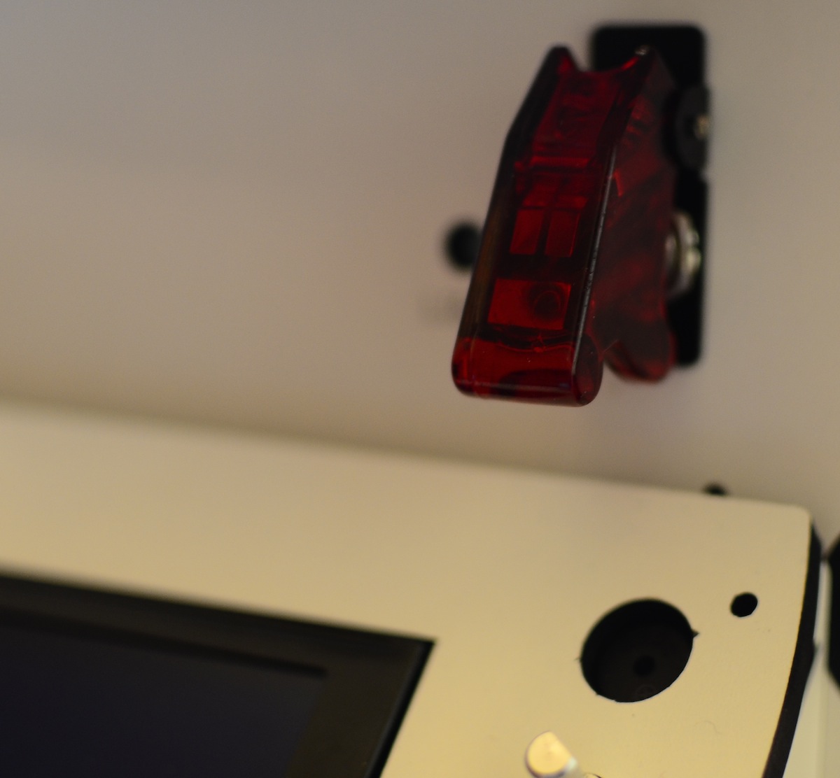

Yeah I didn't like the switch on the Rostock Max. I kept having to hunt around for it. Figured I was eventually going to either stick my fingers in the fan for the power supply or not be able to find it in an emergency situation. So, lets move it to the front, where there is already a circle hole cut in the LCD panel. No wait. That switch sucks anyway. Lets use a new one!
Oooo lighty!
It has the missle switch cover, so in an emergency all I have to do is hit the cover and it'll close and turn the whole machine off.
Tell me you aren't jealous. :D

That's a neat switch, how does it work, and where did you get it from?
How are you powering the lights, are you bringing 12V straight from the power supply and just turning them on/off with the old switch?

theverant wrote:That's a neat switch, how does it work, and where did you get it from?
It's an A01-ES with A01-50B from http://www.apem.com
theverant wrote:are you bringing 12V straight from the power supply and just turning them on/off with the old switch?
Correct.
Yes, I switch the green wire to the power supply.
